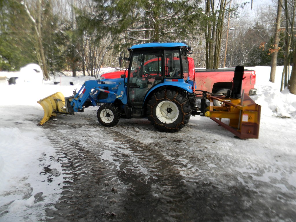

I use a 7 1/2' truck plow I mounted to a quick attach plate for my 36HP LS. It handles it fine.
Thanks.
