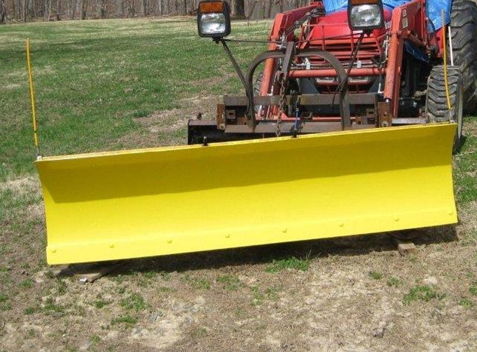

You will need to make an adapter for the truck mount. I bolted my complete mount to my bucket, but later removed the truck unit and turned it into a quasi 3 point and will fabricate that mount to an SSQA. Currently I have a heavy 7.5' Meyers, but the Western quick connect I recently picked up is much lighter.

45 years ago Late 70's, I used a western plow mounted on the bucket arms of a John Deere 830 with a pin on bucket. It was done with a kit that you welded tabs onto the plow a frame at the right spacing for the arms and a pair for the bucket cylinder. No chain used and by using the cylinder I was able to scrape a little more of needed. Worked real well but I had to get off and on to angle. I added a 3way valve to the bucket circuit to lock it so it didn't drift down and I could then add power angle. Living in central NY and working for a school district I was able to clear out all the parking and sidewalks in 2-4 hours for 2 schools and the bus garage . this was a 2 wheel drive. I have a power angle frame mount I made for my 8N I plow with but wouldn't hesitate to adapt a plow to my Kubota L2501dt loader if I didn't.

I also have an l3301 and use it to plow a 2500 Ft gravel driveway here in the Catskills .I have had very good luck with a quick attach 84" blade that seems to be just right . No problem at all
stacking snow up quite high. I have a front remote to angle. Also important to mention that chains are a must. There should be plows like this available
