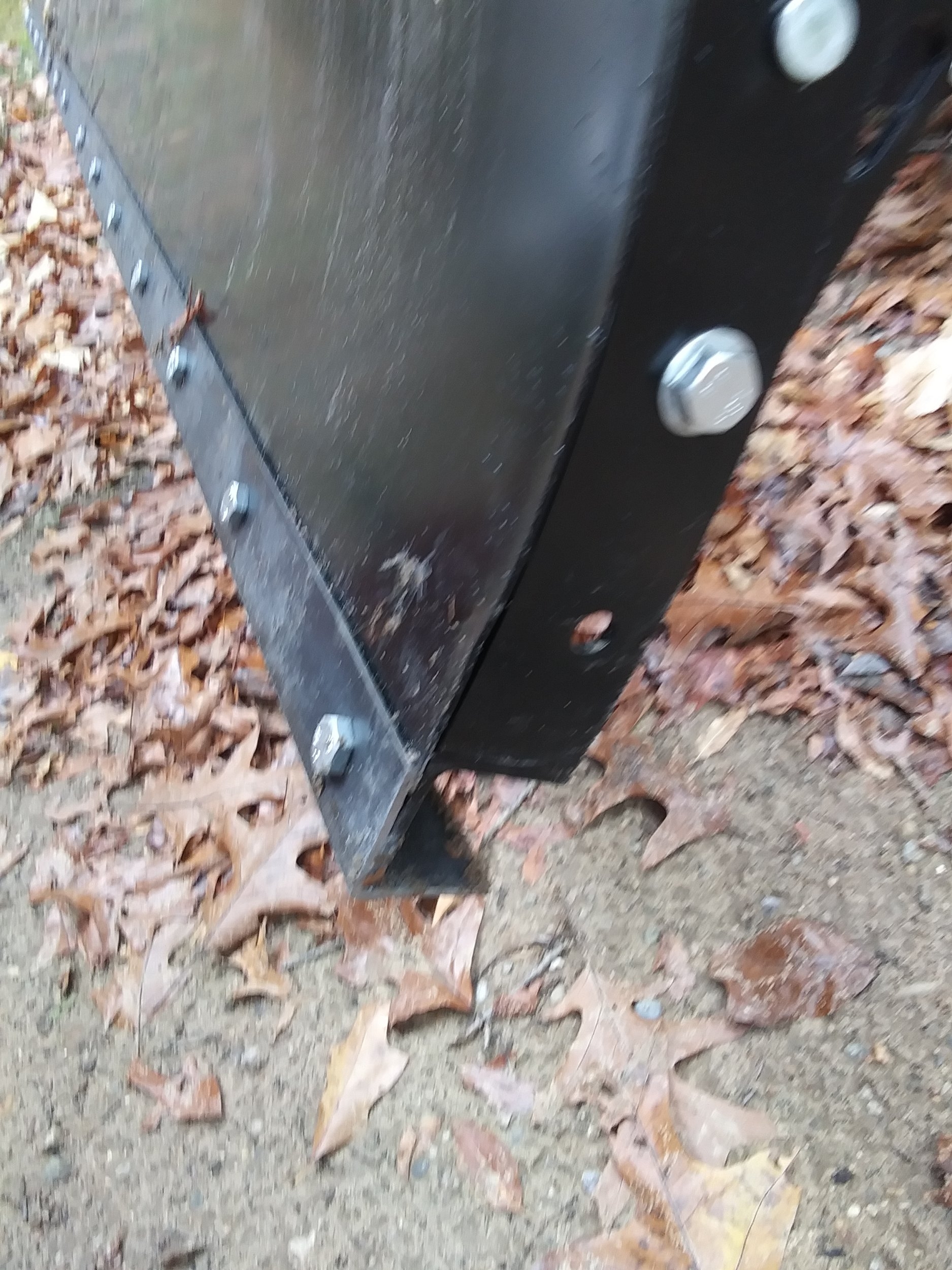

I tried the pipe thing and found that PVC doesn't work for me.
Light gage pipe is just as bad.
Ended up taking the cutting edge off my plow & replacing it with angle iron.
Bolted through the holes for the cutting edge.
Works like a charm.
Length of angle iron on the tines of the york rake works too.
Can plow path across the lawn without any damage to the grass.
How about posting some pictures of this modification? Thanks
Ok....

I'd never thought of that, good idea.
How's it work for clearing snow off hard ground, does it ride up at all or much?
/ Snow plow ? Beginner #67
It will ride over anything at all firm.
But does an acceptable job on my private road & neighbors driveways.
Works as good or better then pipes I tried when they worked.
Once the ground is truly frozen, I revert back to plow shoes.
Have a full with angle on the york rake now and use it for clearing around the barn & path to the basement doorwall for firewood delivery.
