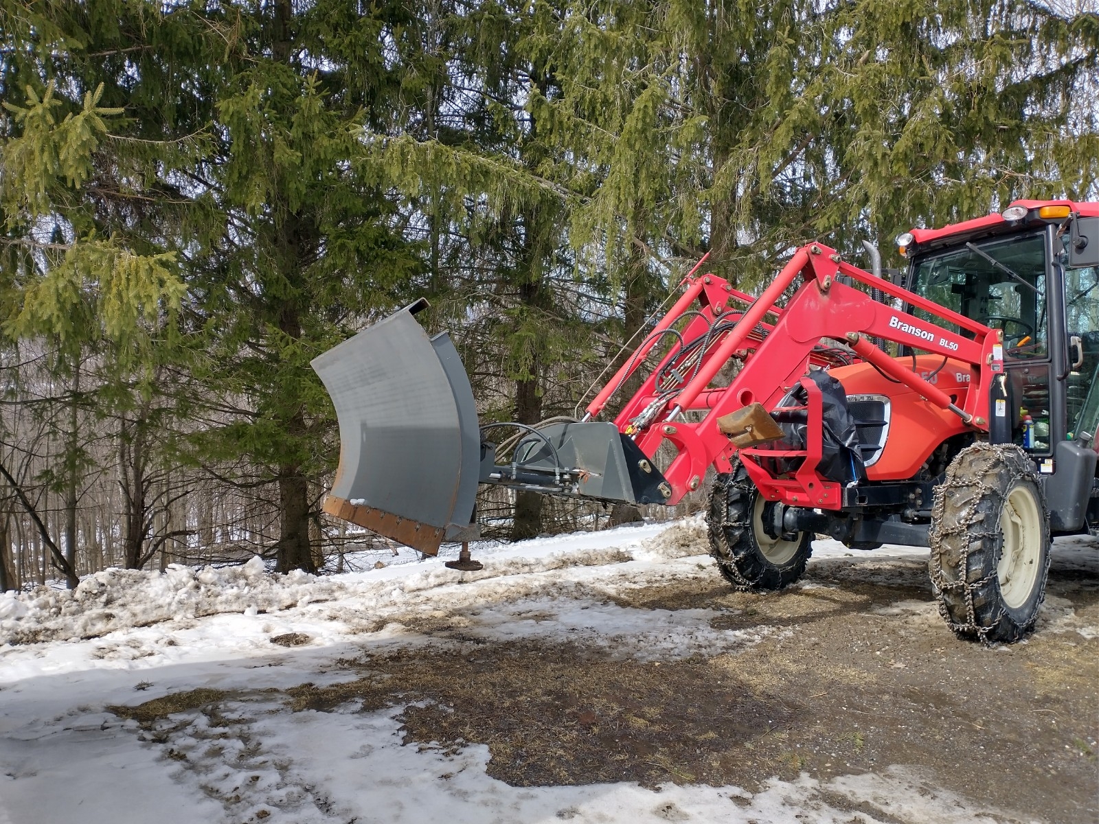

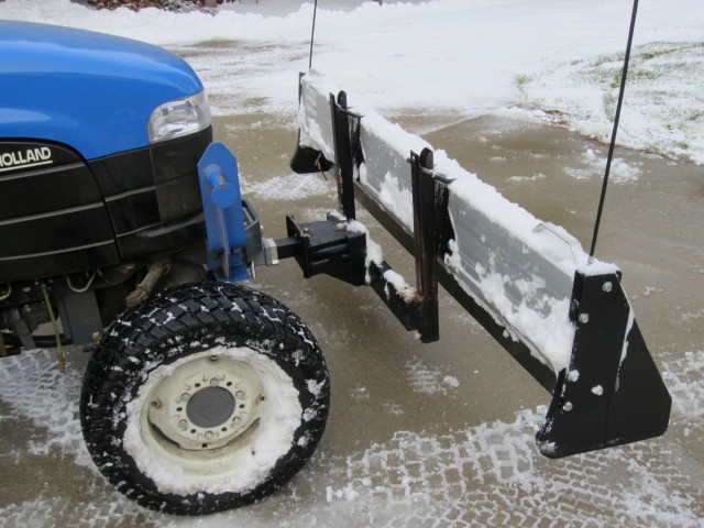

I have a plow for mounting on my FEL, I'm not impressed with it. It sticks out way to far in front of me.
As the tractor tires go over a rise or drop in a low spot the blade moves 5-6 times as much.

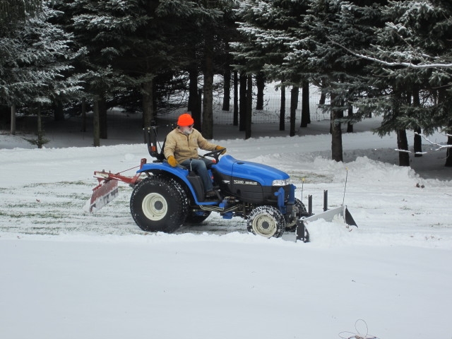

I had a light-duty snow plow for my Craftsman garden tractor. Sold the gt when I got the Massey, so I repurposed the Craftsman plow for the Massey...basically hacked the mount off, and welded it on a SSQI plate. It's been working awesome for me, gonna be a 4th year with it this coming winter.
Here's a vid:
Your plow appears to have no ability to "float"?
Most heavy loader plows are hinged, and hung from a chain, so it can move up if the terrain requires it to do so.
I designed mine in a way that the chain was not necessary, it can still float up as it needs to.
Without the ability to float, it's not going to work well.
Mine also has gauge wheels behind it to keep it out of the gravel. I can set it as high or low as I like, with the curl function on the FEL control.
Picture of the gauge wheels was the prottype version 1.0. The finished mount is now v. 1.2 in the second picture, the wheels are still the same.
There is also a steel pipe attached to the front to help keep it out of the gravel. If you add a pipe, DO NOT SLOT THE PIPE, that's a lot of work, and a complete waste of time. Just weld tabs on it, and bolt it on.
It has about 2-3" of float the way it was built. It is a "factory" snow plow, not sure who built it.
