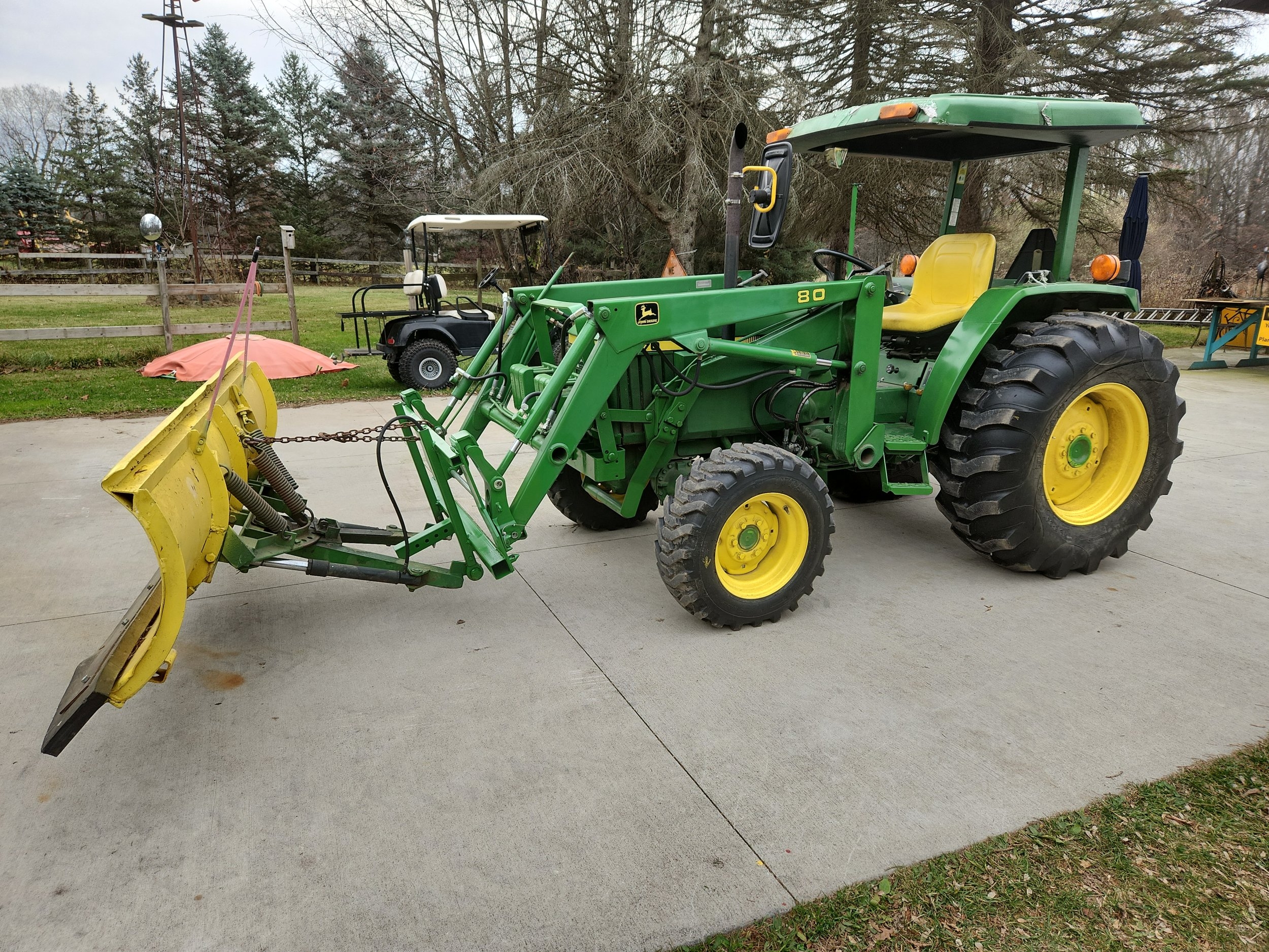

/ Snow plow ? Beginner #23

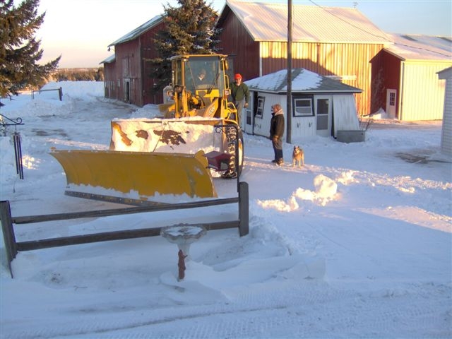

Your plow appears to have no ability to "float"?
Most heavy loader plows are hinged, and hung from a chain, so it can move up if the terrain requires it to do so.
I've never seen a commercially made, loader mounted plow that hung from a chain. Seen pictures of homemade ones. That design isn't strong enough to hold up to bigger loaders, so you're not likely to see one either. Too much risk of warranty issues and bad press for the manufacturer.
It is the way this bucket plow was made to float...see the chain?
/ Snow plow ? Beginner #26

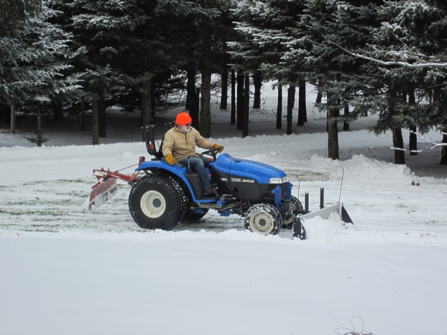

Is that commercially made? Perhaps I should clarify that I mean SSQA or direct mounted, not bucket mounted. Can't say I've seen an angle capable plow that attached to the bucket. Seems like that'd be awfully ungainly.
/ Snow plow ? Beginner #27
This guy makes SSQA plows with 8-10" up/down float and 4" of wobble float. It has a linkage, not a chain. He also makes them as short as he can so they don't stick way out front.

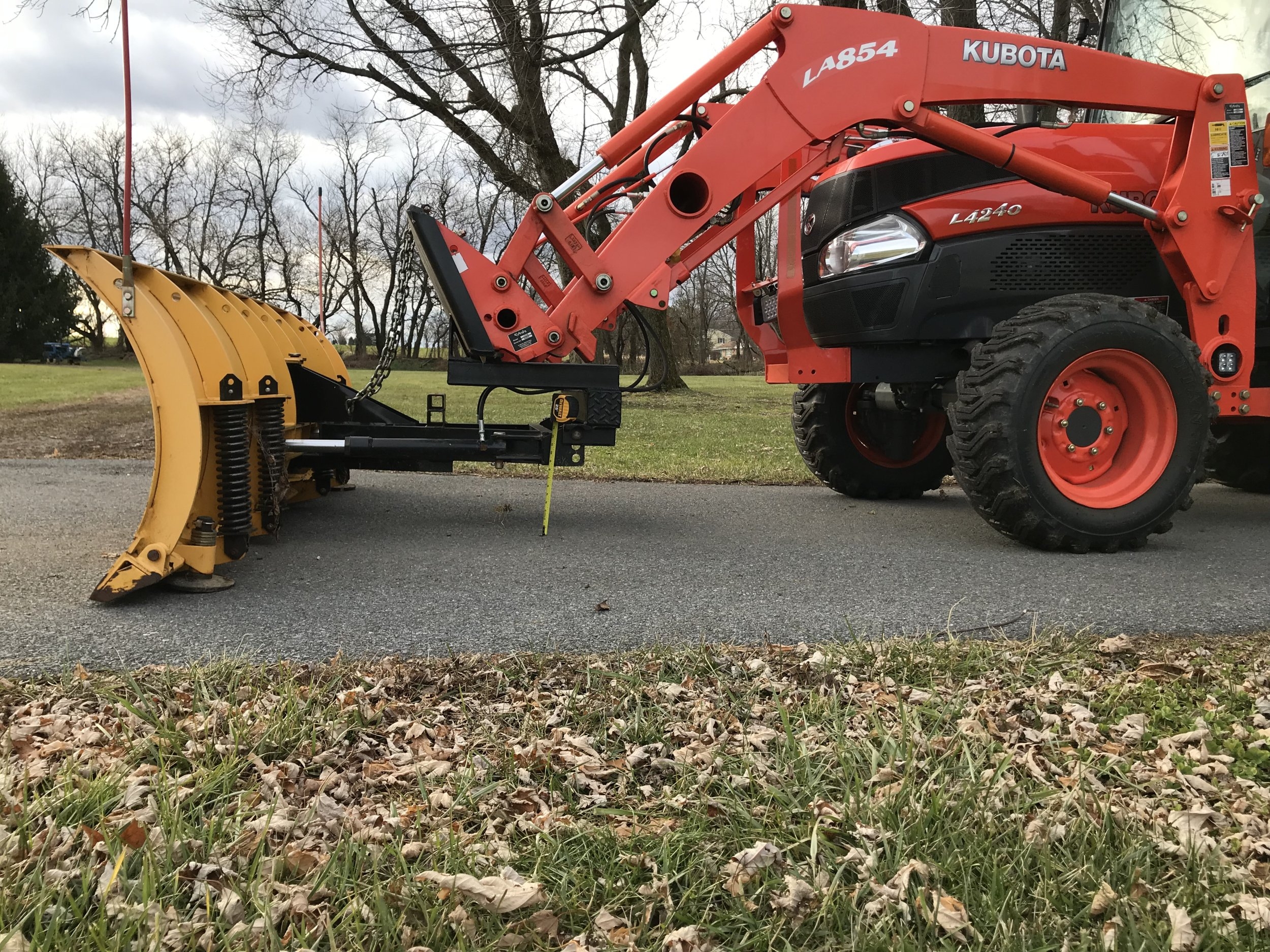

Addressing one concern mentioned - If a bucket or plow digs holes in an asphalt driveway, the driveway is worthless.
Chain suspension (for a loader-mounted blade) - It's the only way I'd have it. It allows the blade itself to float with just the weight of the blade. Designs without chains or the unique hinge in a link above have the weight of the loader frame bearing down on the blade.

I used a pair of magnets with whiskers made from zip ties. The one on the left is set to align with the top fin of the grille guard and sets the loader arm height. The one on the right is at the tip of the level indicator rod when the QA is at the correct angle.
The QA roll angle is set and forget for the most part. It doesn't require much adjustment. Occasionally when piling up snow I do rotate it a bit. Up and down for the arms becomes second nature after a bit of operating.
The picture of the plow is a good example of a mounting design based on Gordon Gould's. The tape measure is not for doing setup. It was placed there to answer a question another poster asked concerning clearance.

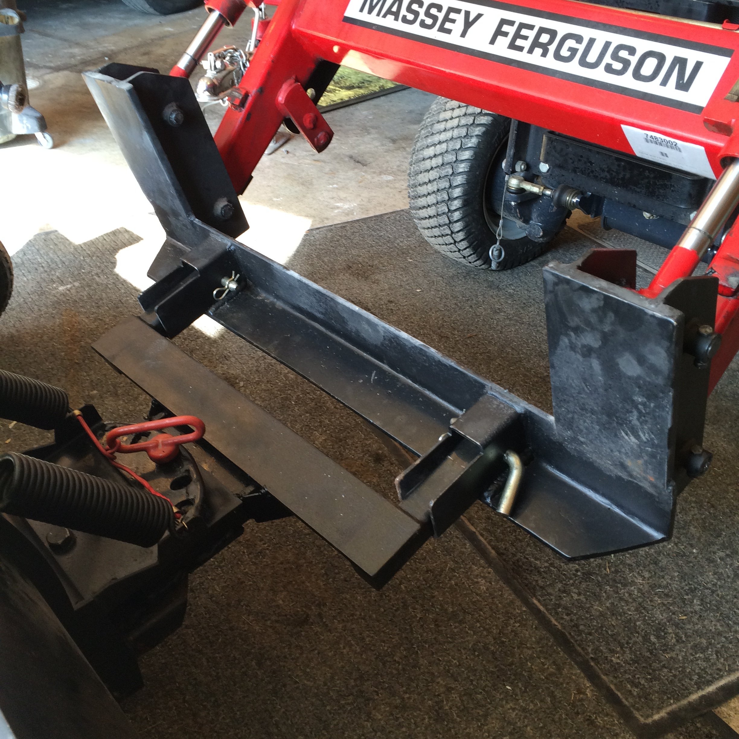

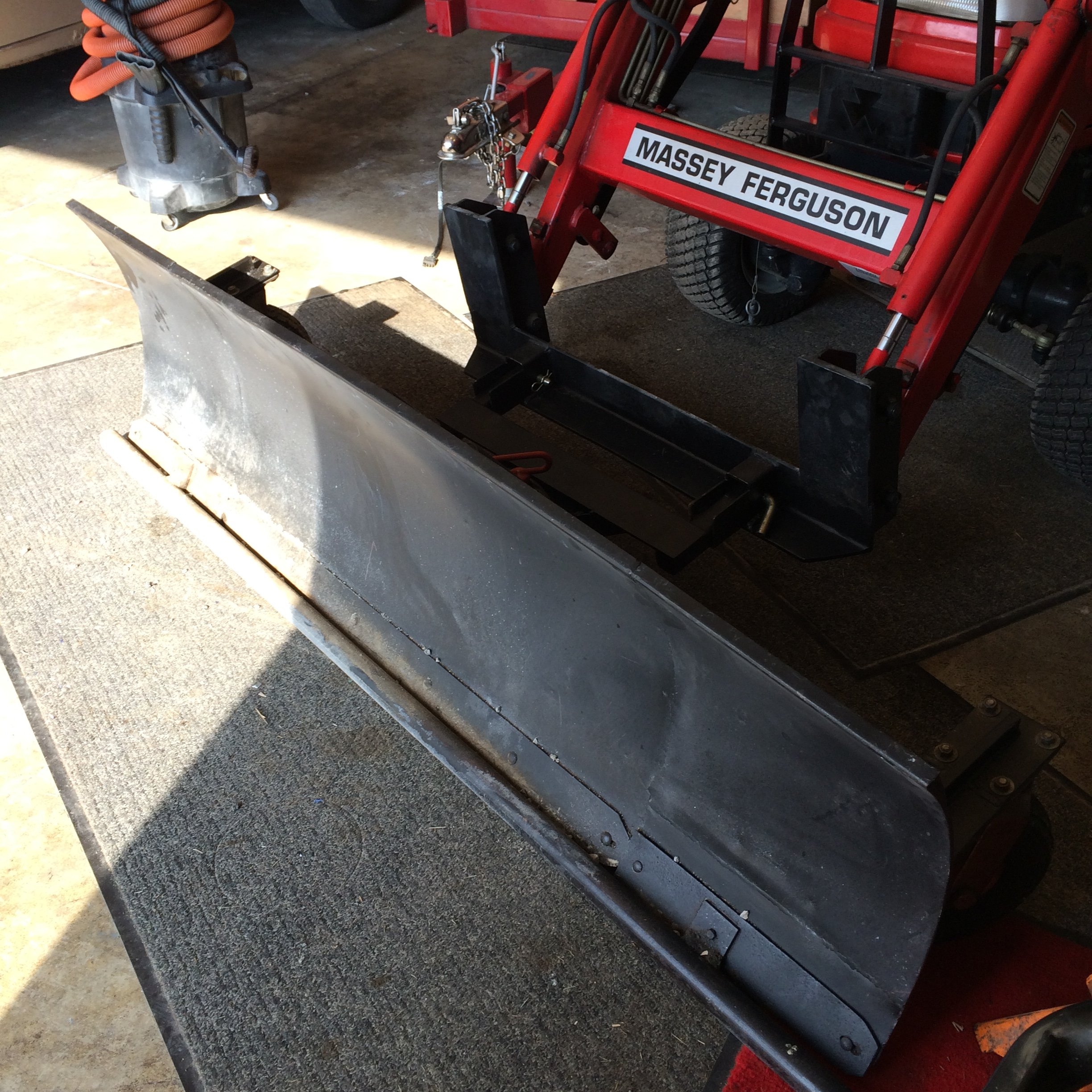

/ Snow plow ? Beginner #35
Though I've had tractors most of my life, I've never had or used a snow plow. I'd like to get a plow for my L3301 quick attach but also would like to use it on my pickup occasionally swapping back and forth rather easily.
Is there an adaptor or way to do this without a bunch of bolting/unbolting to move it from one to the other?
Forgive me if this is absurdly simple. As I said. I've never had a snow plow but moving to Vermont and getting a huge circular driveway paved this year has my 60 year old back and push behind snow blower cringing as winter approaches.
Thank you,
Lenny
My thoughts & experience:
Many years ago, I made an adapter by welding an old pickup plow frame to a SSQA plate. I used it to swap my Western 90" plow between several tractors & pickups over the years. Now, there are adapters available on the market such as this one:
I found the 90" truck plow to be a bit awkward to use on my smaller B series Kubota's but not much of a problem for the newer L's I've owned. It took some practice and a few tricks but it got the job done. Getting on and off the tractor to manually adjust the blade angle was a real pain. Adding a 3rd function valve was a welcome improvement to hydraulically angle the blade.
When I was younger, I didn't mind being out in the weather plowing on an open station tractor. Maneuvering with the tractor was much easier than the pickup. I could easily pile snow and push the banks back using the blade on the FEL.
As I got older, I became less tolerant of the cold and began using the pickup most of the time. As the price of pickups increased, I became reluctant to beat up an expensive vehicle by plowing with it so I went back to using the tractor. I suppose I could have kept an old truck around just for plowing but the maintenance & storage of another vehicle was a problem.
Eventually, I bit the bullet and bought a cabbed tractor with an SSQA FEL plow. For me, at my age, it has proved to be the ideal solution. Plowing with heat and mowing with A/C just can't be beat!
