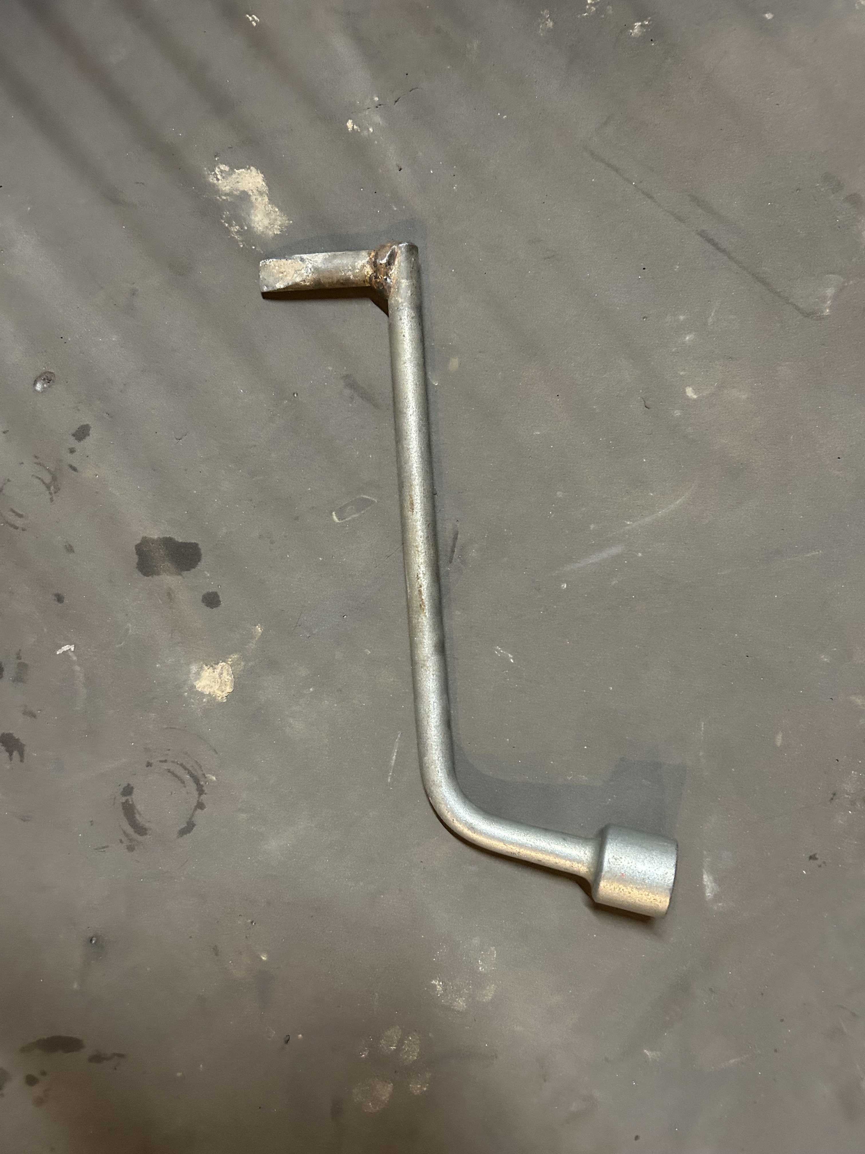

   / Snow chains #24
This is my special tool for tightening the camlock. Helps get the chains real tight.

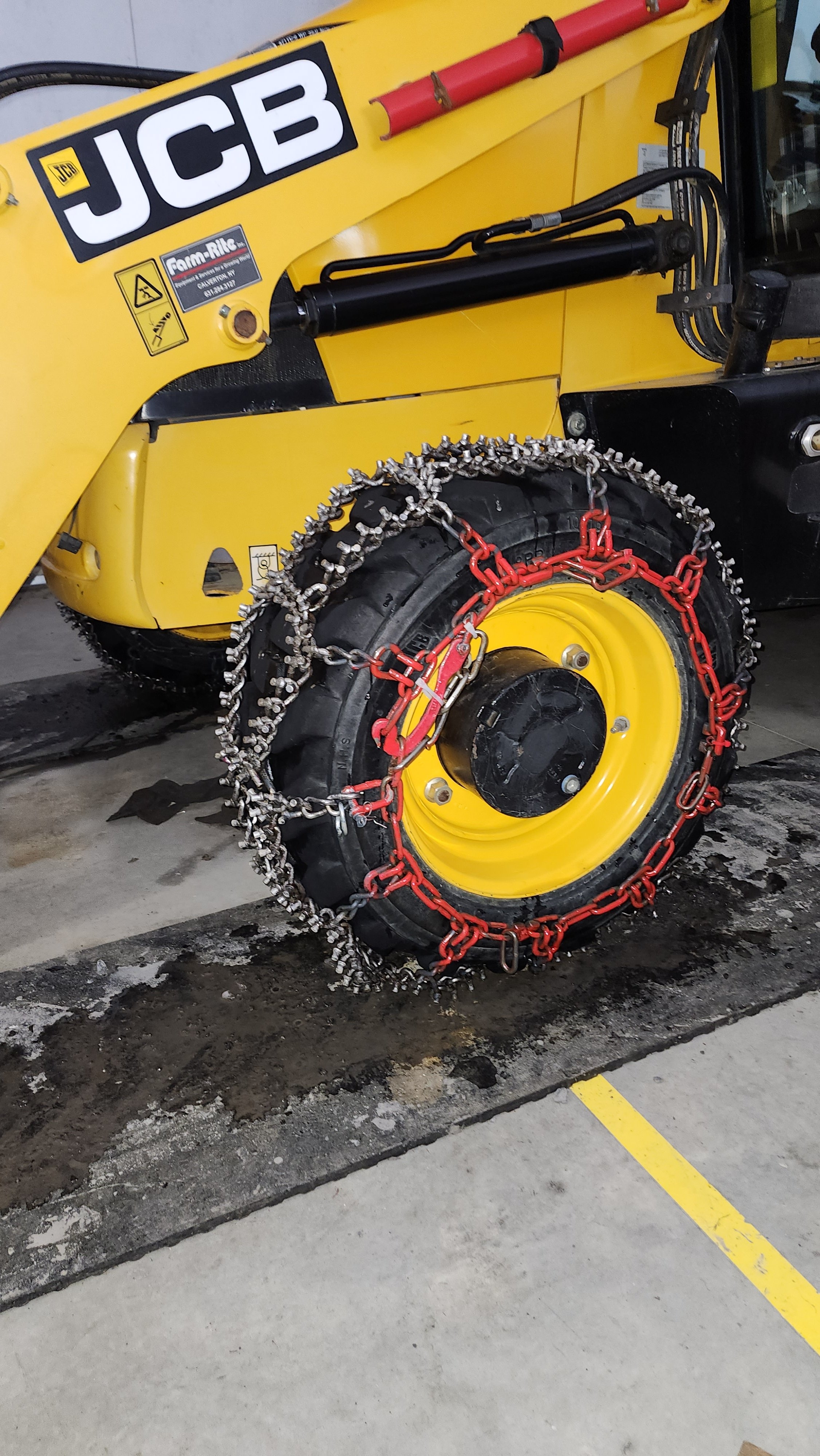

   / Snow chains #29
Tractor chains are heavy. Driving them on, like in this video will almost guarentee they go on tight and centered.
If they were not specifically sized for your tire size, you may need snow chain tools to modify the spacings of the crosschains.
Obviously they need modifying as the sidechains are way loose. You should never need bungees to pull the sidechains in like your picture shows. If done correctly, no tensioners are necessary
