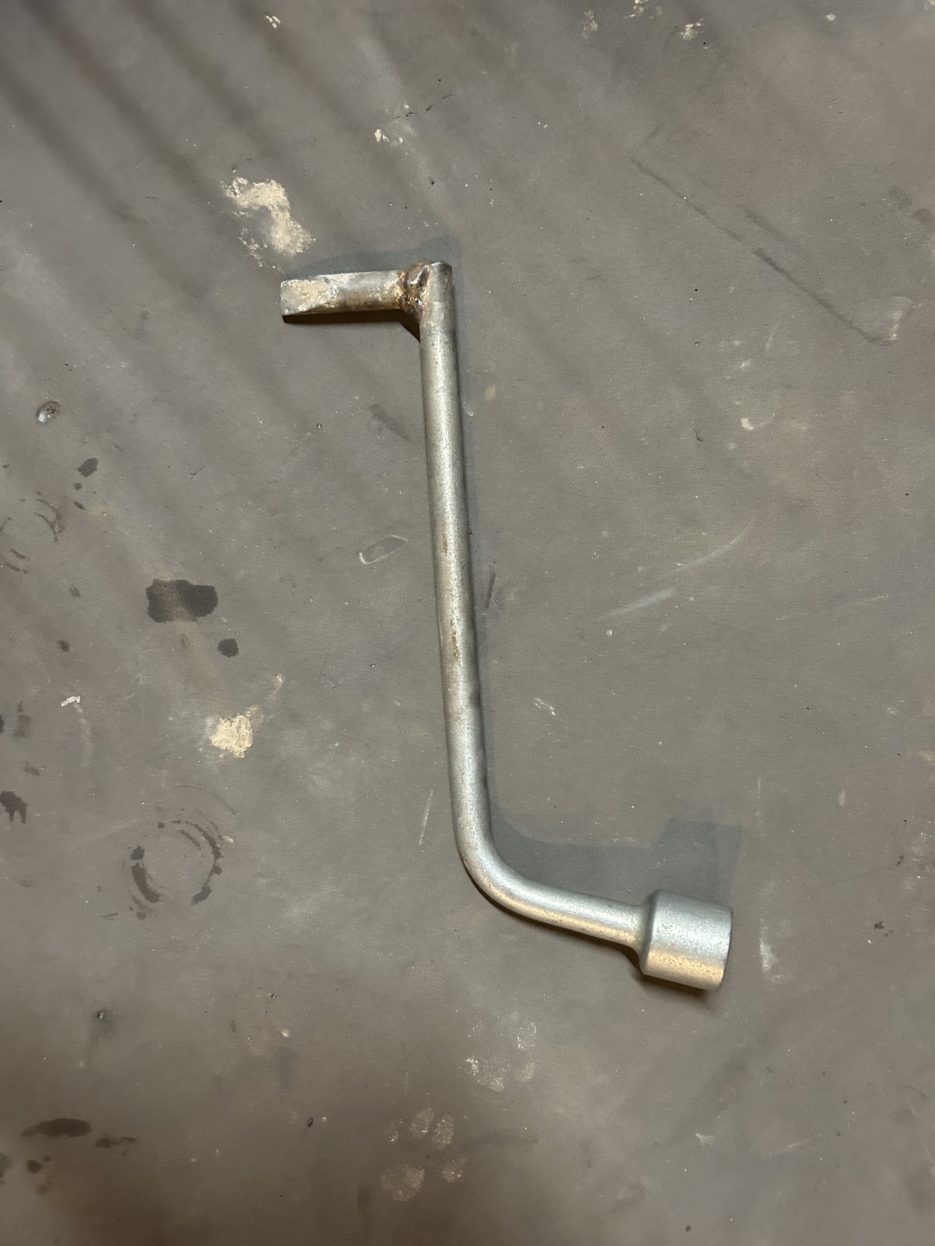

/ Snow chains #24
This is my special tool for tightening the camlock. Helps get the chains real tight.

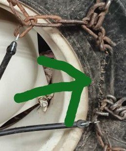

/ Snow chains #29
Tractor chains are heavy. Driving them on, like in this video will almost guarentee they go on tight and centered.
If they were not specifically sized for your tire size, you may need snow chain tools to modify the spacings of the crosschains.
Obviously they need modifying as the sidechains are way loose. You should never need bungees to pull the sidechains in like your picture shows. If done correctly, no tensioners are necessary

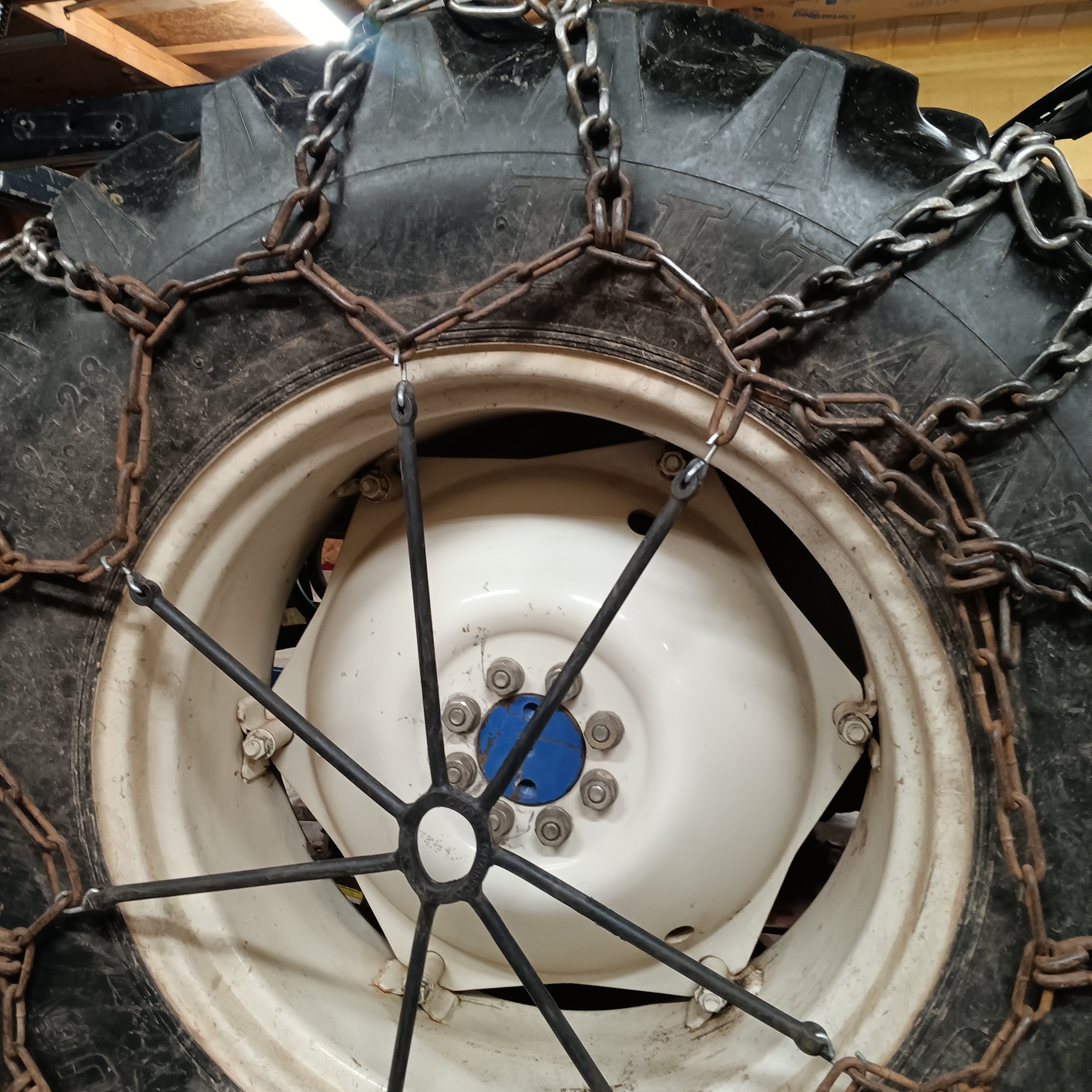

/ Snow chains #33
This picture shows that the chains are too large for these tires. That's good, you can move the cross links to make them fit nicely.
The OP started another thread on the subject, here Loaded tires psi. He isn't understanding how the fasteners are supposed to work. Here's a picture of what he's got going on. He's got the "cam" type hook attached as if it's just like the hook on the non-cam side and then wired together. I definitely agree that the chains need to be cut down, but before he does that, he needs to be sure he knows how to properly install them, with no twisted tie wire involved.

/ Snow chains #34
Good catch! I didnt see that he didnt put it thru the opposite chain link and back on itself. As per my pic. Yeah, that would take up 3-4" right there.
