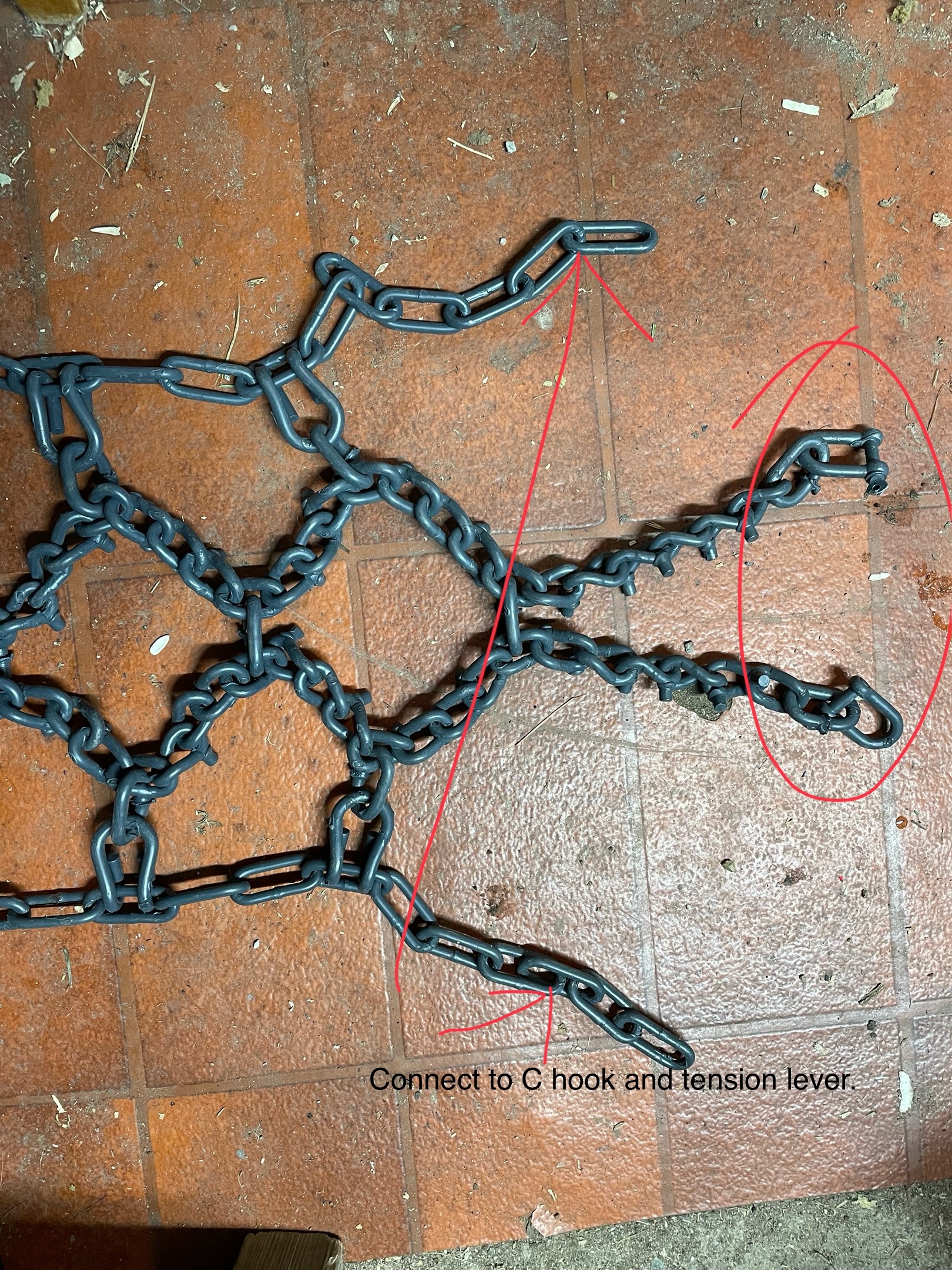

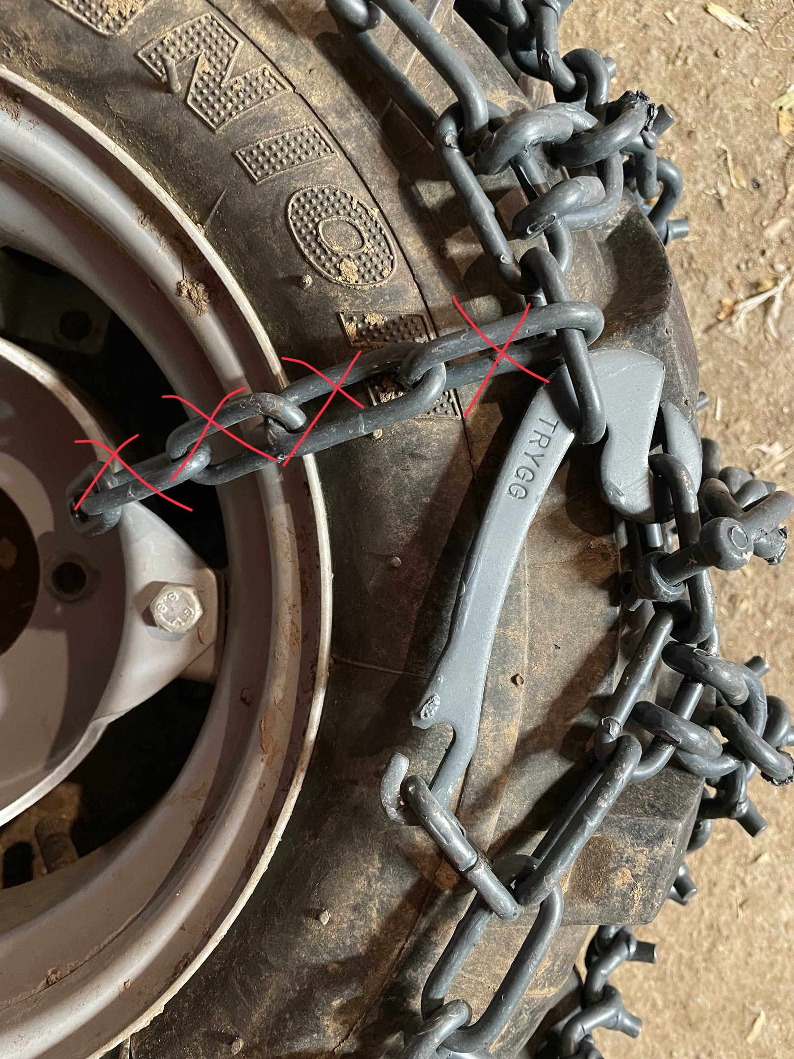

Hi!
I have a Bcs 740 walk behind tractor with a berta 2 stage 85 cm snowblower.
The Bcs is spinning a lot on snow with the heavy blower, so I have bought studded snowchains to improve traction.
The chains should fit the small 5" x 10" wheels according to the seller.
The included documentation is very limited, and I don’t understand how to mount. I have added two pictures of the snowchains.
Particularly how to connect the parts encircled in red is what I don’t understand.
Can you help?
Best regards
Erling

Looks like the clevises in the red circle connect to the side chain as do the hooks on the opposite end.
Make sure the open side of the cross chain hooks are facing away from the tires.

The chain hooks in the picture on the right get attached to the chains in the picture on the left to form another diamond. They do not get layed on top, or form a double layer. To secure those hooks, figure out which link in the loose ends on the other side they will fit best with the chains tight. Cut off the excess. Hook the hook onto the link and then pound the roll pin in the hook down so that it secures the links from coming loose.
Folks that are new to tire chains get nervous about it sometimes, but in almost all cases, new chains will need some links cut out of them in order to fit the tire properly without loose links hanging off to get snagged on things. They make the chains a bit big on purpose so they can fit more than one tire size and to accommodate variances between different manufacturers and tread patterns within the same tire size.

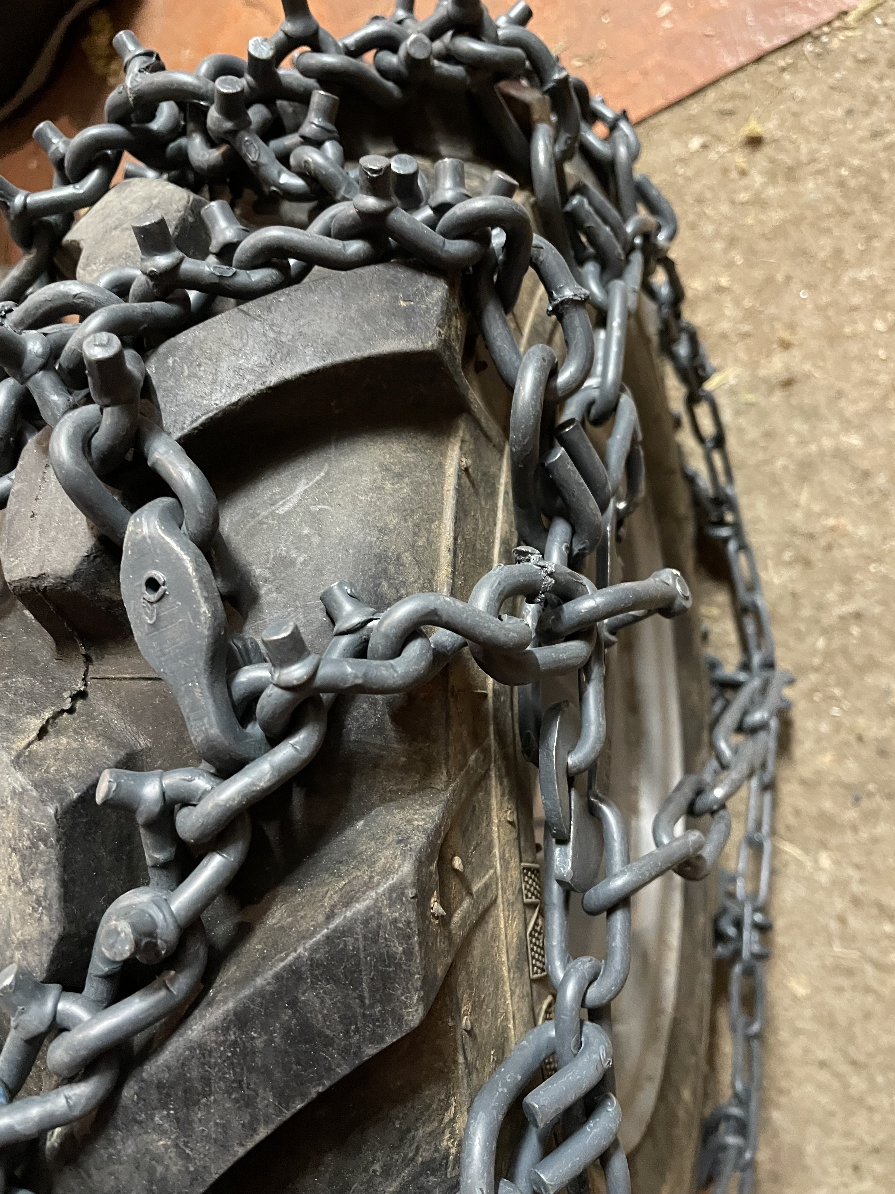

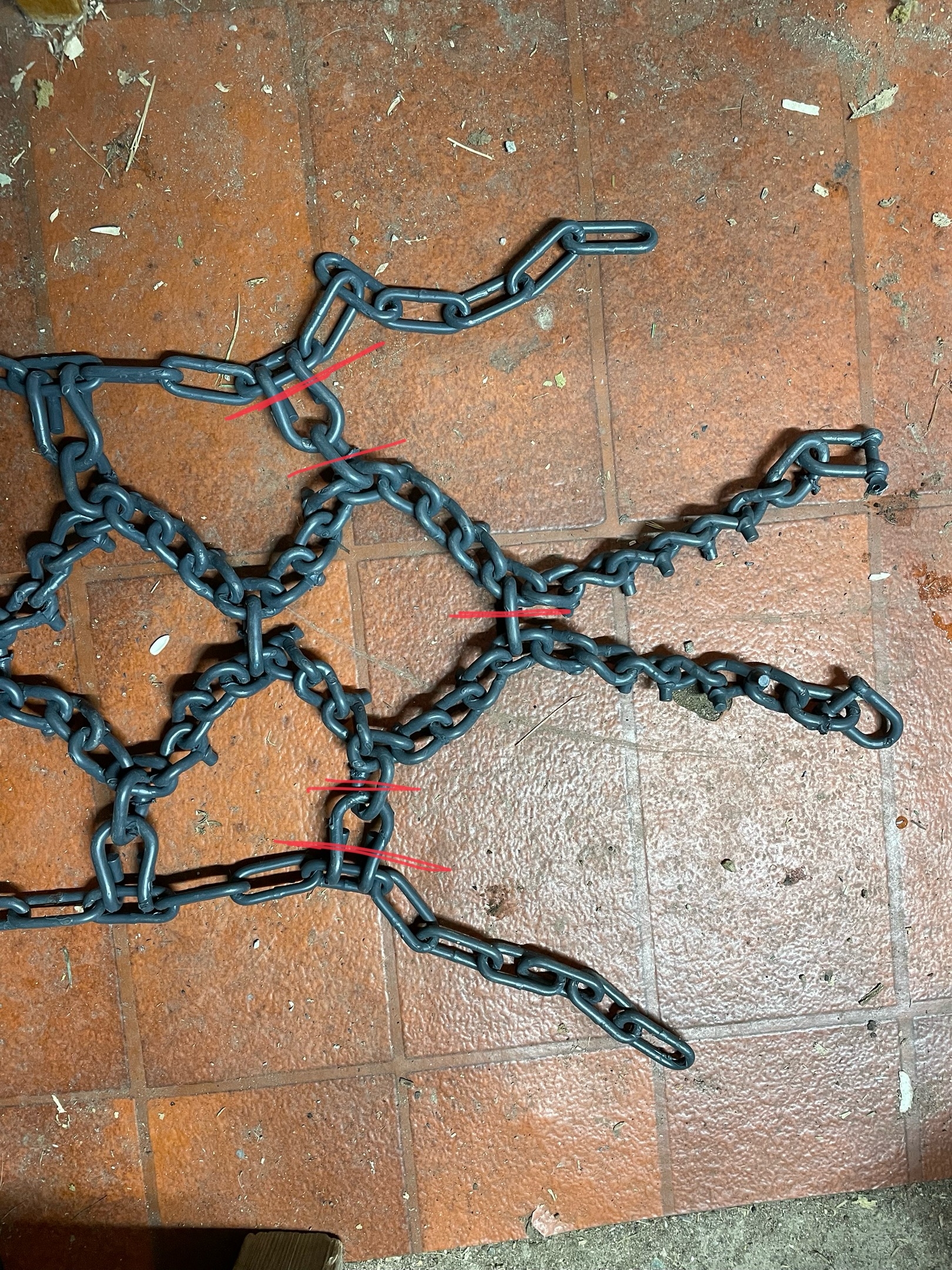

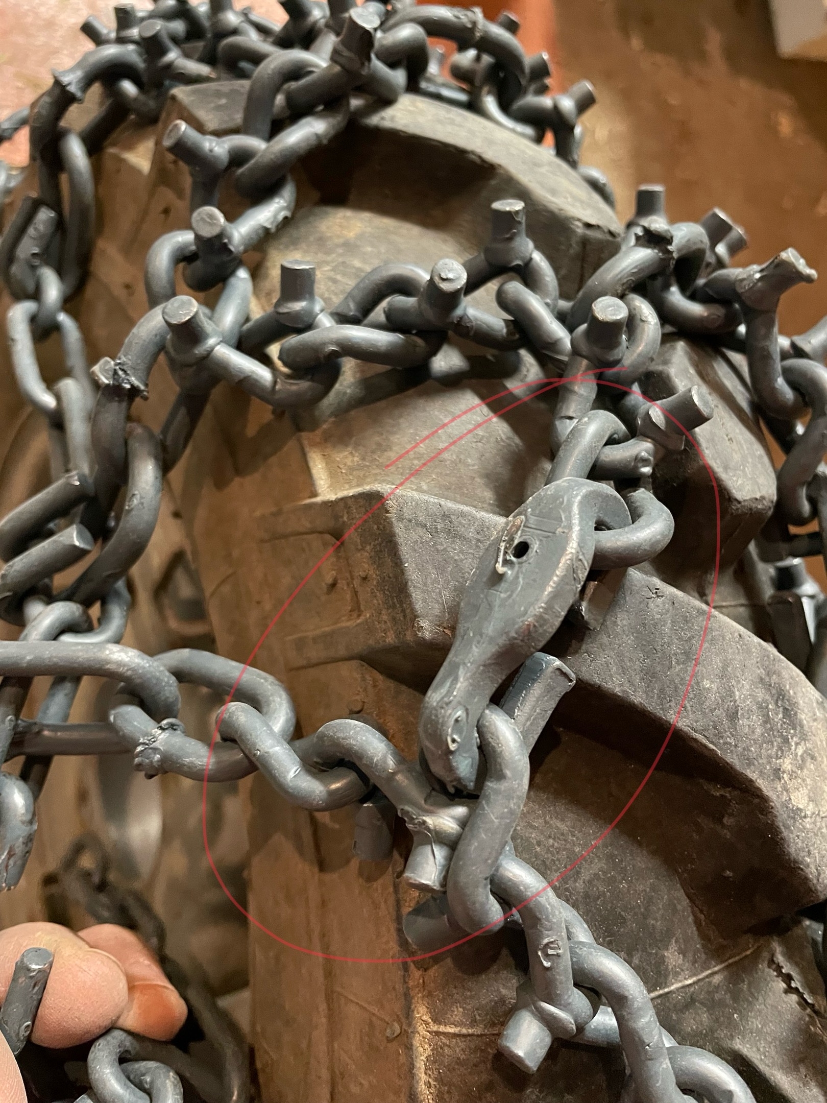

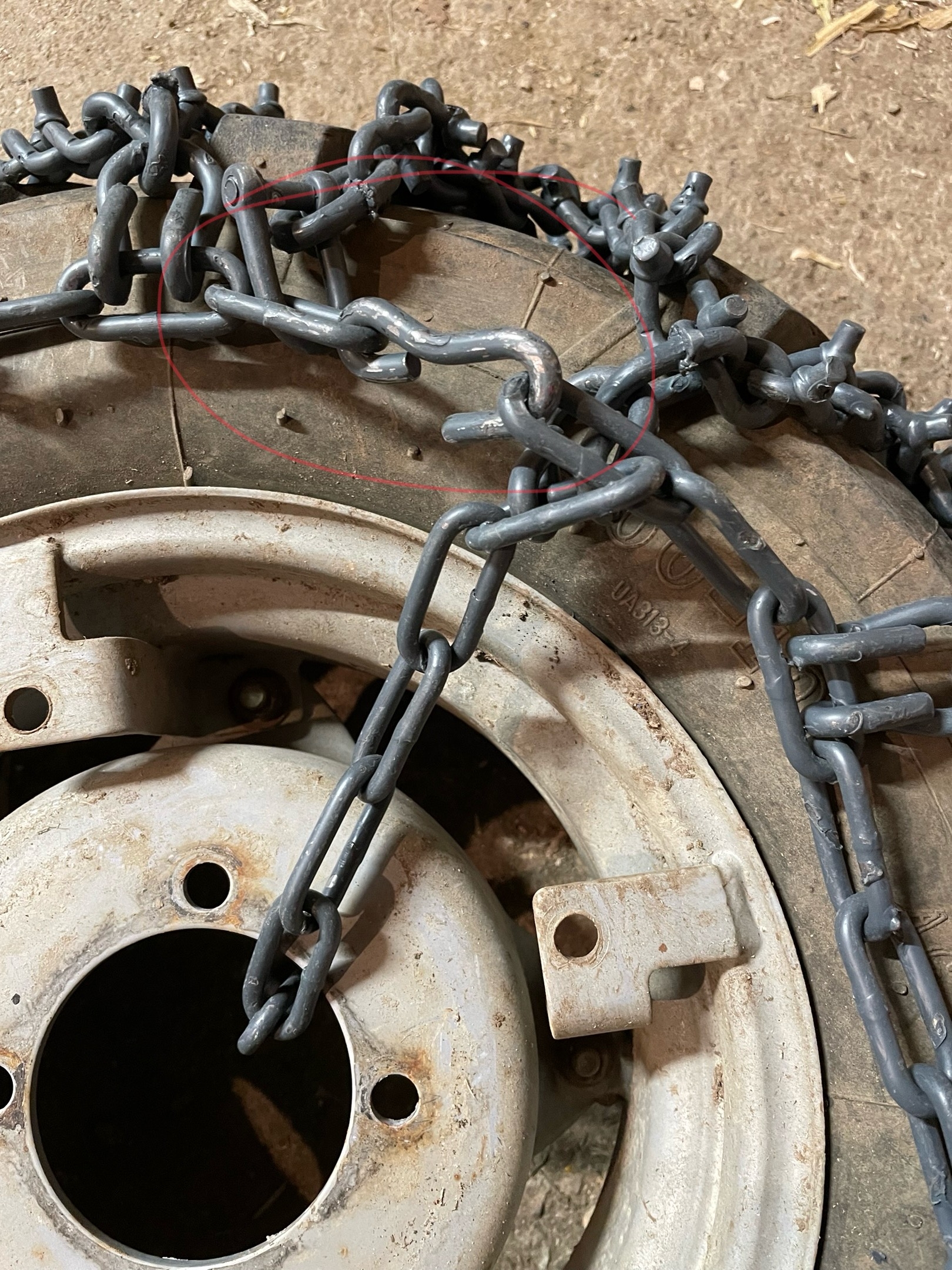

Thanks for helpful replies. I tried to mount the snowchain on one of the wheels today, does it look correct?
The chain is very loose even when I use the innermost links. I may need to cut open one triangle as illustrated on the image.

Tough to tell without being there. It's normal to have to cut new chains to fit.
/ Mounting diamond snowchains on small wheels #9
As mentioned without being their it is hard to advise you on how to proceed.
Normally the inner diamond pattern chains will be arranged to be hand tight with the excess chain being long tails to go to the side chains. Were they fasten to the side chains does not need to be at the end of the chain often it will be 2-4 links up from the end. Your side chains should have the same number of unused links on each side. All of the chains both inner and outers need to be kept even and "square" if fastened unequally the chains will tend to walk off.

Do you have elastic straps/tensioners to keep the tire chains taut?
Every tire chain I ever bought fit without having to modify its design first.
To me, this sounds like you don't have the correct tire chains.

#11
Chains was shortened a bit by cutting certain parts with an angle grinder according to the manufacturers instructions and I used them during the winter. Traction was good and two weight plates from the Berta snowblower was removed and weight plates was added to the motor end of the BCS 740 walk behind. That improved balance / steering a lot, steering brakes works with that setup and it is much better to turn without using much force! It was little snow this winter so I did not use it much, but now it is ready for the next season!
