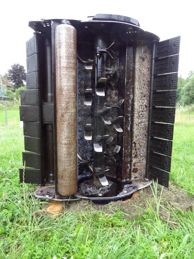

A few times during the mowing season, I like to give my Berta a good wash down with the garden hose. I do the same at the end of the season, before stowing the mower for the winter. I hope, that keeping the mower clean, well greased and stored in a dry garage, will keep it running well for many years to come. At the same time, it is a good opportunity to check the blades, the bolts and nuts, and the general condition of the implement.
Usually I have disconnected the flail mower from the tractor and raised it to vertical, letting the mower rest on the left-hand side panel. This way the right-hand side panel with the two belts will be at the very top, where they are best protected from the water spray and dirt. This is how the mower typically looks after the wash, with quite a lot of dirt now lying on the ground:
Once as I did this washing, I recalled a video from Earth Tools, where Joel is turning the mower on its side, while it is still connected to the tractor. This might be convenient in some situations, but Joel says that you can’t do that on all the flail mower sizes:
That is correct, as you will run out of ground clearance under the engine before the mower reaches vertical with the wider models, if the tractor is on the standard 5x10x20’’ wheels. I have the 6.5x12x23’’ wheels on mine, so I decided to give it a try with my 34’’ Berta - and it works:
It is a tight fit though, as the engine is sitting firm on the ground in this picture. It only works well this way, as the right-hand side cover is more than an inch wider than the left-hand side one!

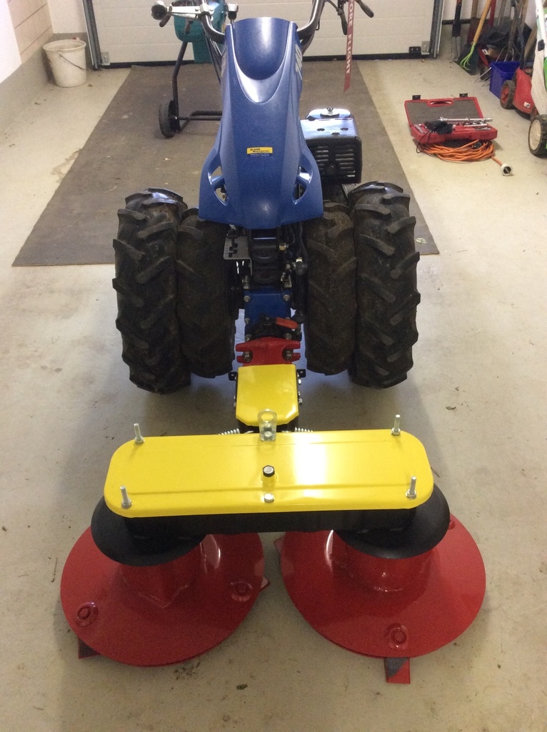

Hi again Nibbana 😉
You are right, I have 15 kg (33lbs) factory cast-iron weights mounted on each wheel. I use my tractor for mowing and sweeping, and hardly ever run out of traction with this setup, which also add to the tractors stability when working on slopes. I also think this is a good compromise when mowing, as the tires don’t leave too many/deep ruts when mowing on soft terrain, while still providing enough traction.
If I remember correctly from some of your pictures, you also use your tractor with a disk harrow and other soil working implements. With such implements, you probably often need all the traction you can get, and here your additional 230lbs really makes sense. The downside is of course the wheels tendency to sink in deep mud. This again just shows how difficult and complex the topic of ballasting a tractor is in real life.
As I got the 6.5x12x23’’ wheels, I wanted to add them to the original 5x10x20’’ wheels that I had already, and at the same time try to keep the track width as narrow as possible to stay within the working width of most of my implements. After a bit of trial and error, and with the help of a few washers, I got down to an outer width of 47 cm (18 ½’’) for the smaller inner wheels. The wheels are so close to the tractor, that on the right-hand side the tire is just clear of the gear quadrant. Then I used 1 of the factory 6 cm (2 ⅓’’) axle extensions, and again a few spacers, to mount the 23’’ wheels as close to the 20’’ ones as possible. The tires are really squeezed together, giving an outer track width of 78.5 cm (31’’).
This is how my setup looks with the Zanon ZRF 100 cm (40’’) drum mower attached:

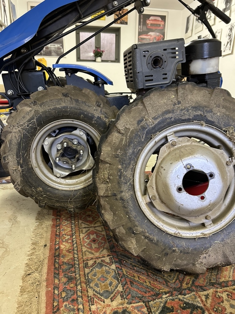

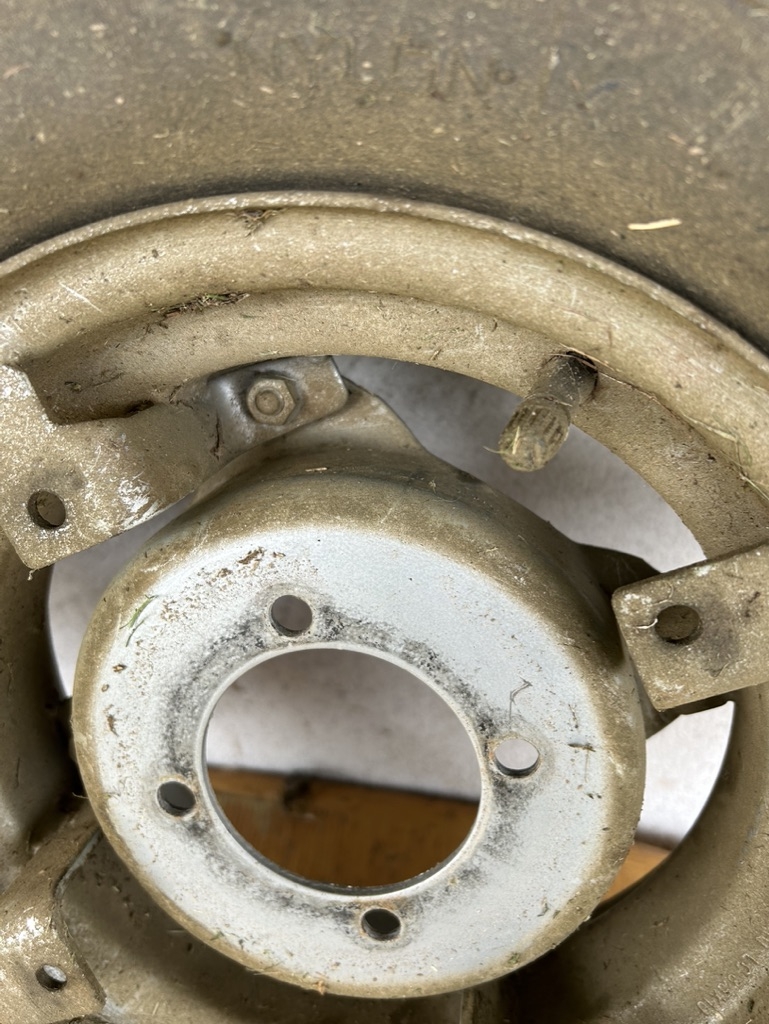

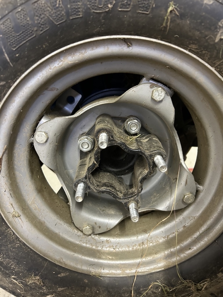

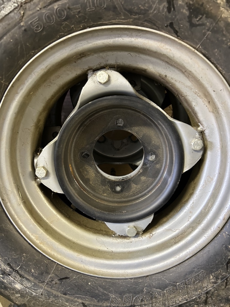

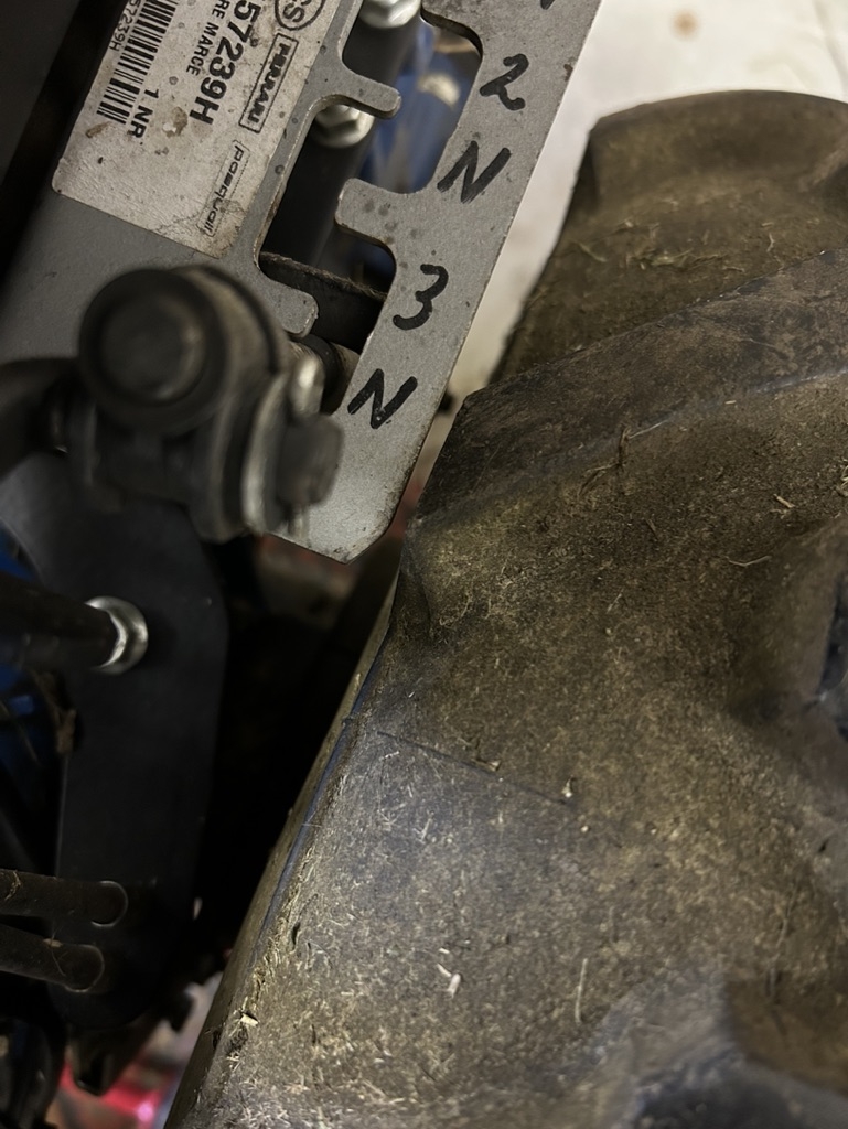

As I removed the wheels on my tractor recently, I took a few photos to help explain how I made my dual wheel setup.
You are absolutely right that there are 4 different ways to mount the wheels - at least that is the case for the 5x10x20’’ and 6.5x12x23’’ that we have. There are 2 sets of brackets/tabs on the outer rim, and the inner hub can be flipped and positioned in 2 different ways on either set of brackets. This is my setup, where the 23’’ wheel to the right will be flipped and fastened to the wheel extension on the 20’’ wheel:
Just for the record - one can fit the hub over the brake drum as shown below. Whether that will be advantageous or not, I don’t know. I have had no problem getting the inner wheels very close to the tractor, with the hubs facing outwards:
As previously said, my priority was to keep the track width as narrow as possible, and the limiting factor on the inside towards the tractor is the gear quadrant, as seen below:
I made a 3 mm (⅛’’) gap between the 5x10x20’’ tire and the gear quadrant to be on the safe side.
The next photo shows the 20'' wheel from the side facing the tractor. Here one can also see the only real drawback of this setup, with the valve stem facing inwards:
The next photo shows the inner wheel mounted on the tractor, with a 6 cm (2 ⅜’’) wheel extension:
The last photo is a close-up of the 23’’ wheel with 2 washers on each bolt for the fine adjustment:
This setup has worked very well for me for more than 10 years now, making the tractor very stable on moderate slopes, and still be within the working width of most of my implements. Especially when working with the 85 cm (34’’) Berta flail mower, the combined tractor-mower setup works very well.

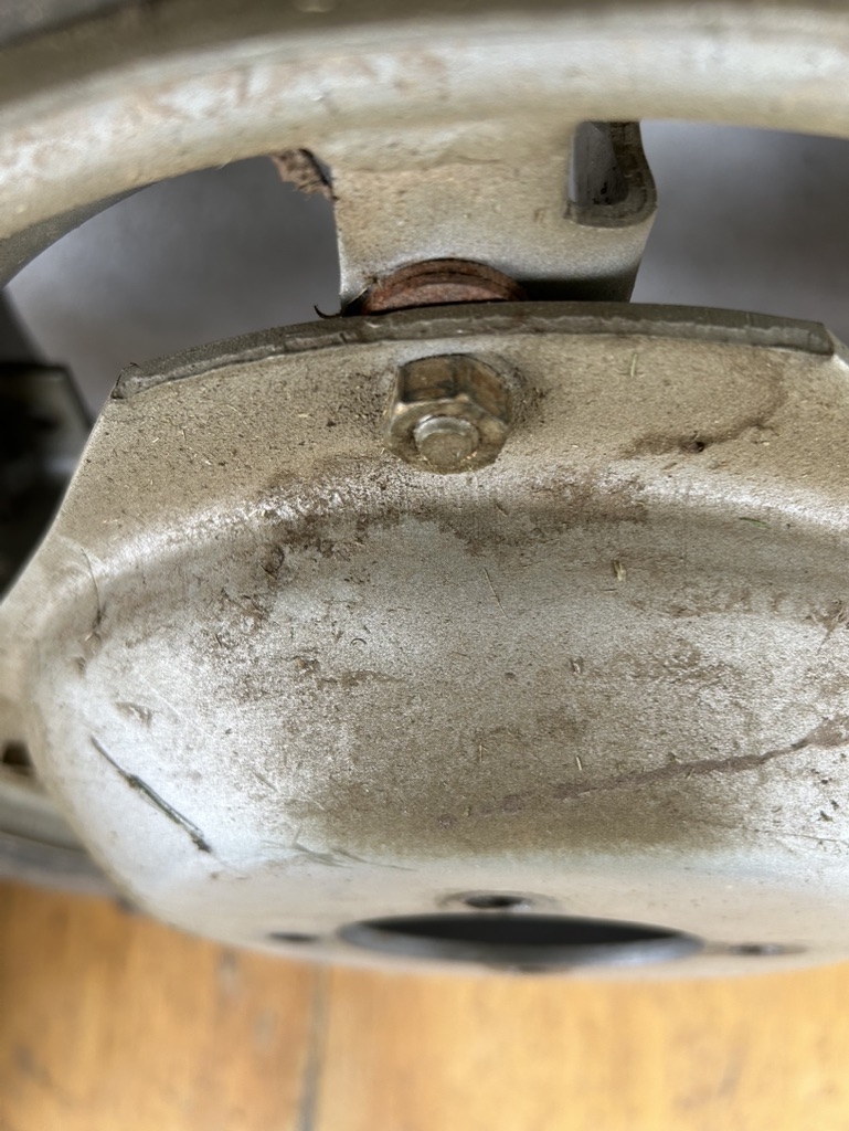

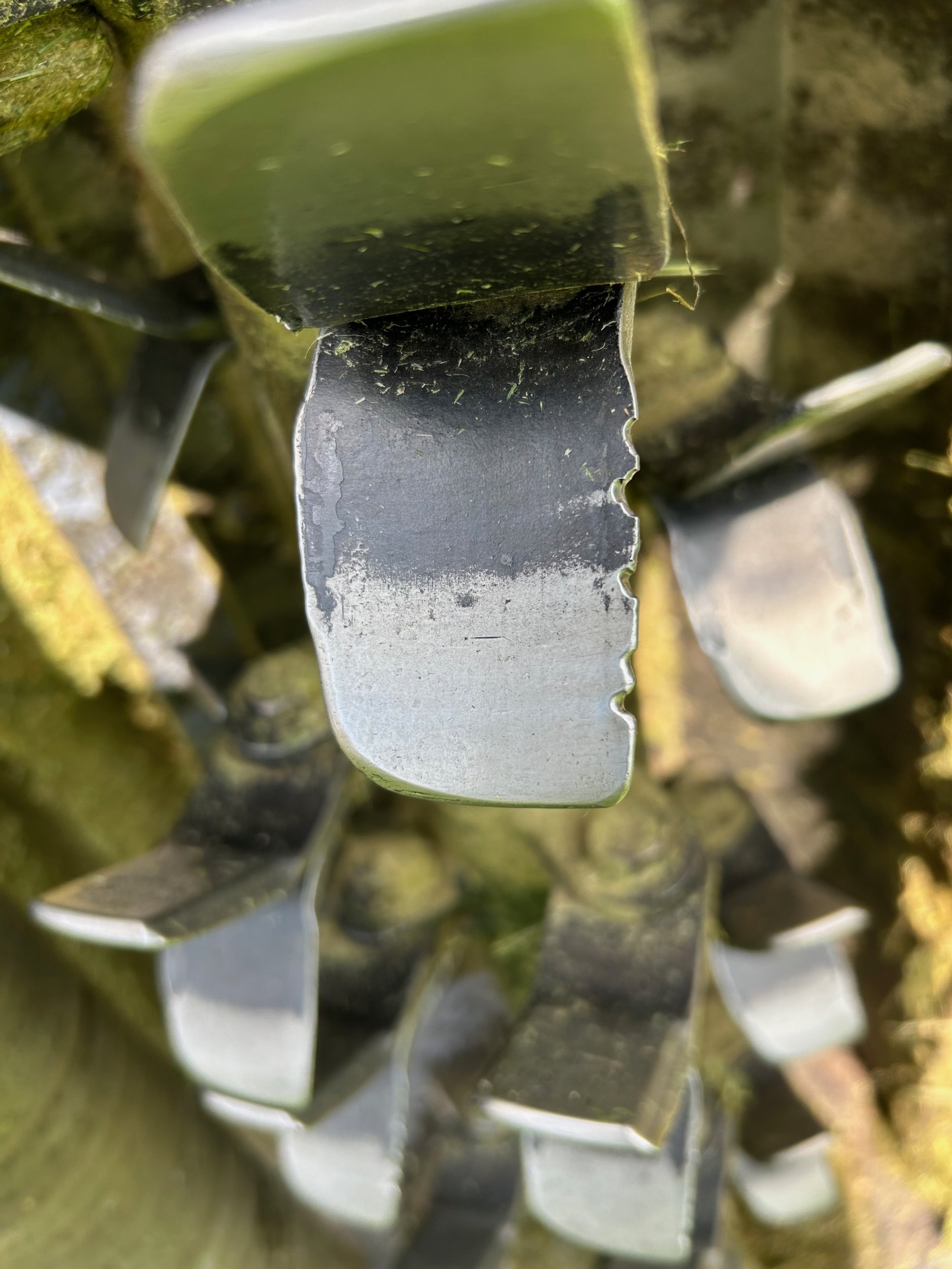

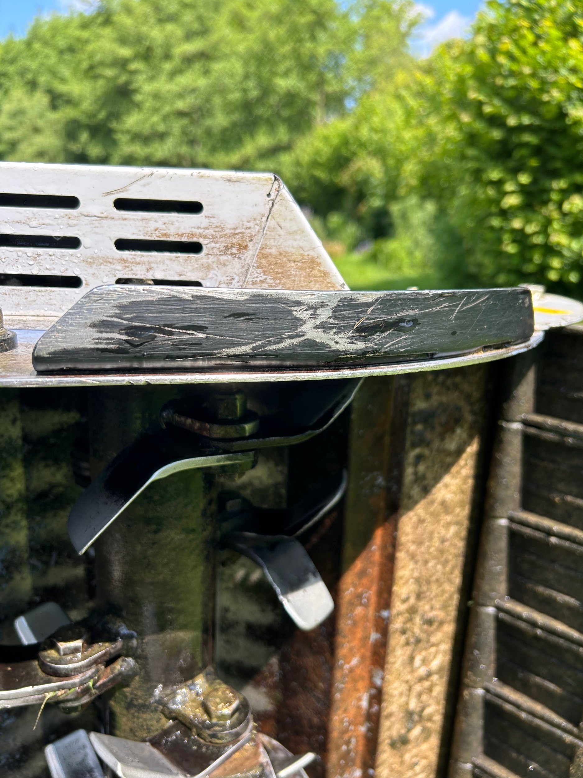

While mowing along a hedge last week, my Berta again picked up a string of barbed wire from an old fence. That’s one of the risks when mowing in tall vegetation in unfamiliar terrain, but luckily the flail mower is not that sensitive to fence wire. This time there was no damage done, but this is how one of the flails looked after an earlier encounter with barbed wire:
Due to the latest incident I wanted to check the mower thoroughly as I got home, and at the same time give the mower a good wash down. As I noticed the wear on the „Anti-Scalp Skids“, I thought that I would post this little update on the topic.
I got the skids last summer as mentioned in post #74, and since then used them for around 20 working hours. It is of course difficult to tell for sure whether they help or not, but looking at the wear of the skids, I think they do:
The photo is of the right-hand side skid, and it clearly shows that especially the rear part of the skid has taken some abuse. I feel that the flail mower „floats“ better since it got the skids, and it follows the terrain better, leading to hardly any scalping.
Best regards
Jens

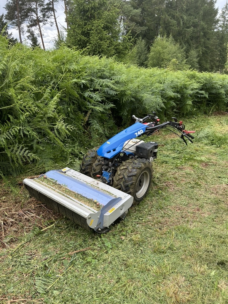

Hi Big wheels are better ;)
I have had the same experience as WesKootenay, when it comes to weeds that has been mowed with the flail mower; it actually takes longer to grow back, and I think that it comes from the different ways different mowers works and cuts.
I basically mow in 2 different ways: either I cut the material with the sickle bar mower/drum mower close to the ground, and it is hand raked and removed, or I cut it with the flail mower, and it is left to decompose. The first case is usually very „grassy“ material, and the second one is pure weeds like common bracken/eagle fern.

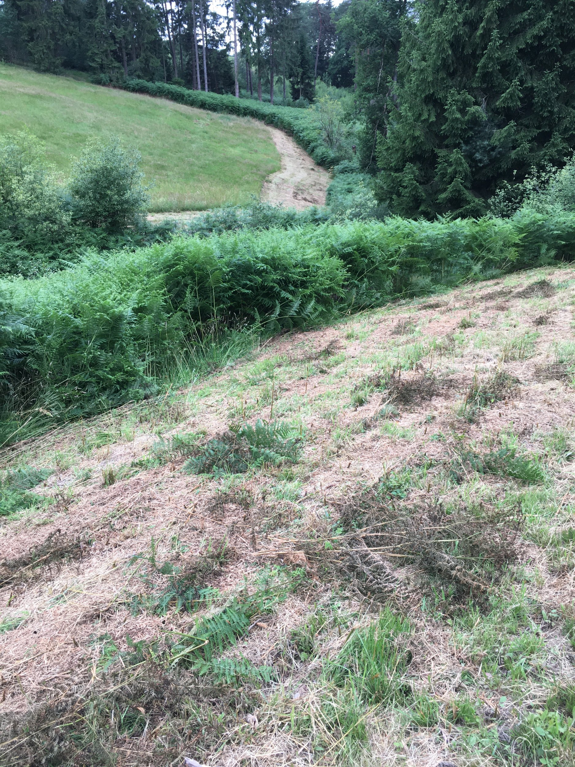

Here I am mowing up to 6½ feet tall eagle fern with the flail mower a month ago:
When mowing with a well adjusted sickle bar mower especially, you will get a very clean cut, leaving the stems intact and the plant ready to grow again. When mowing with the flail mower however, the stems are more torn apart than actually cut. This leaves a much bigger wound to the plant, and a much larger surface for it to loose moisture. This will set back the plants a lot, and hamper new growth.
It is probably difficult to see on my foto, but just in front of the Berta, there are some stems left standing.
I hope this makes sense?

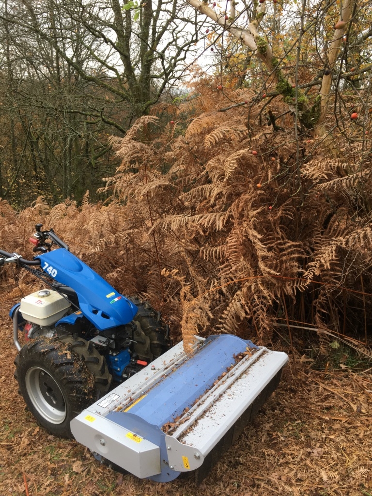

That eagle fern should dissolve like tissue paper, might be the case when talking about the finer parts of the leaves, but the rest of the plant - especially the stems/stalks - takes years to dissolve/compose in my area.

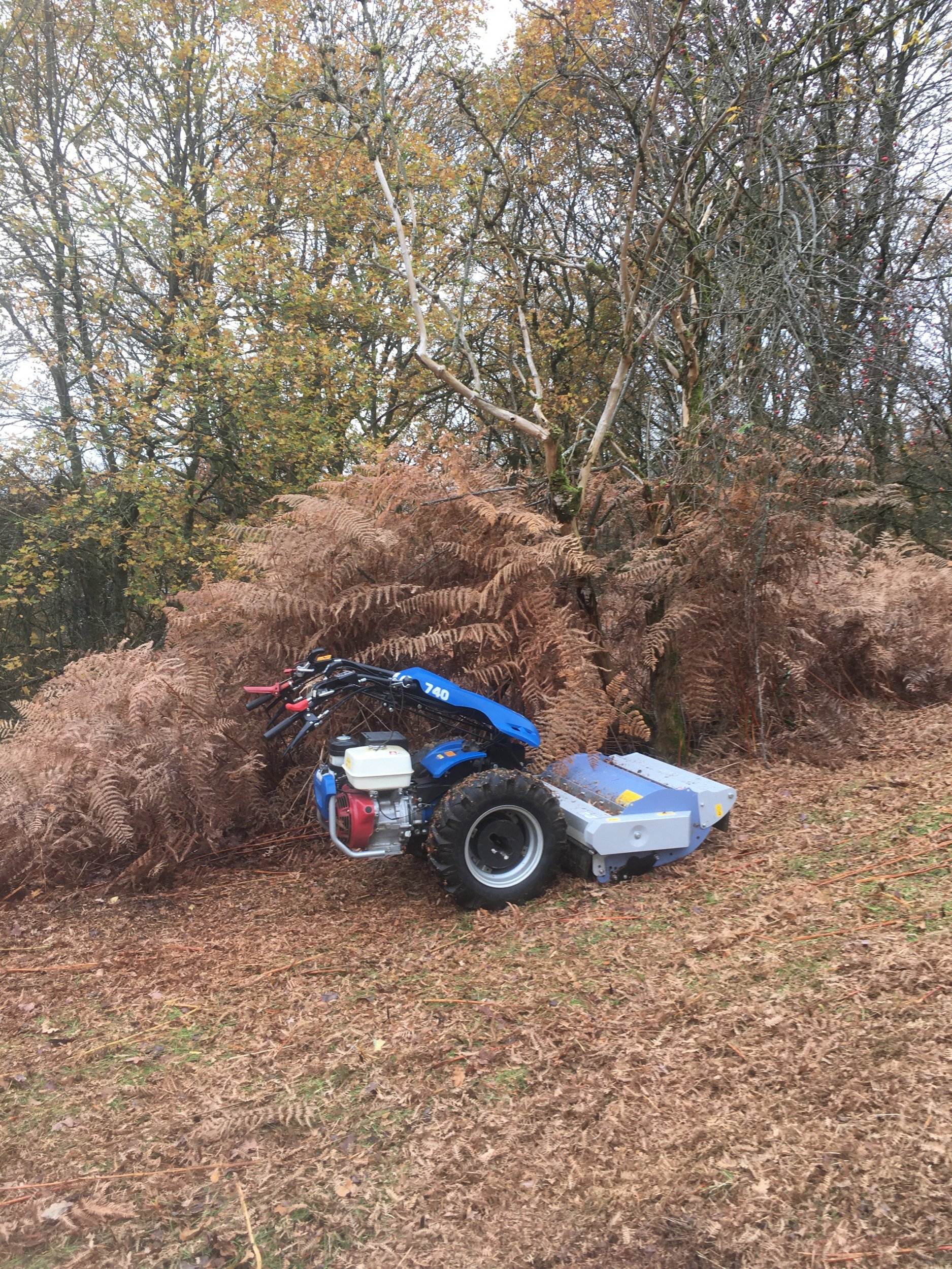

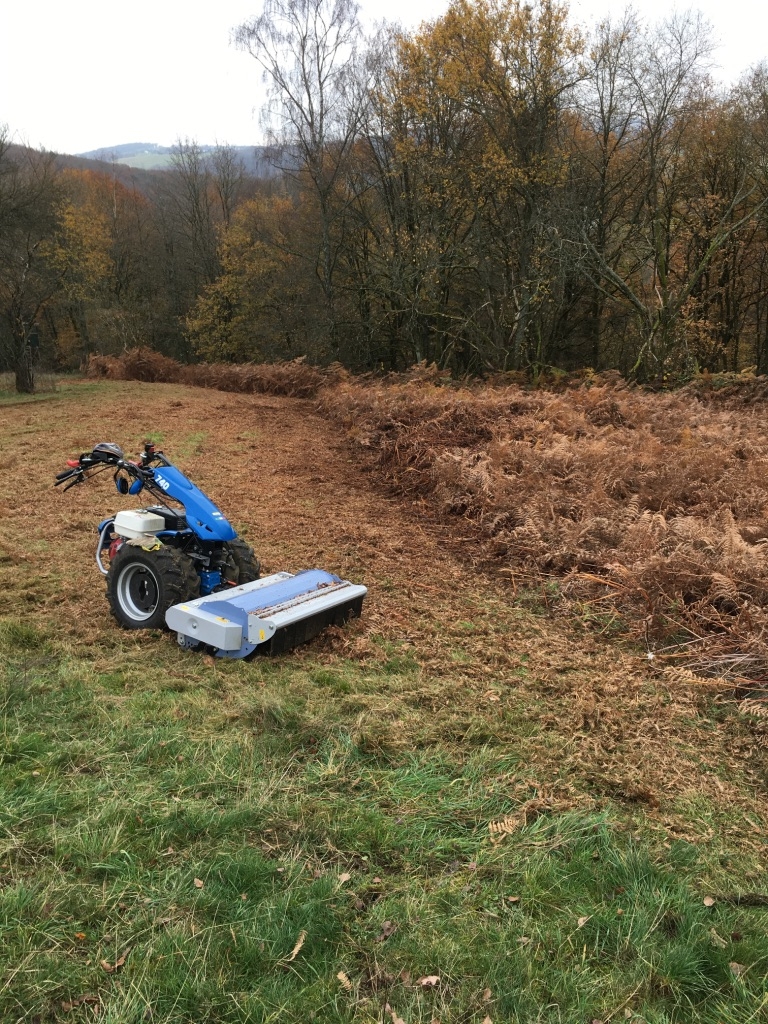

24. November 2020, I was called to mow a plot where the eagle fern had build a dense thicket along the outer perimeter, and was about to take complete control of the pasture, leaving less and less room for grass and other plants every year. Here, the eagle fern had been allowed to grow to about 6 feet tall for several years, but as the plants had withered by late November, Berta managed to cut them all down, leaving a tidy pasture for the coming year, and a very happy owner :)
On the pictures below, we have finished about ⅔ of the job:
When the eagle fern is this tall, the stems are up to ½ inch thick 2 inches above the ground, which is the mowing hight of my flail mower. This tall, they also get very fibrous, and they are impossible to tear apart by hand. One can imagine the amount of power it takes to not only cut these stems, but also to shred them into small pieces. On such tough jobs, I need to mow with ½ the normal working width to keep Berta and my Honda engine happy.

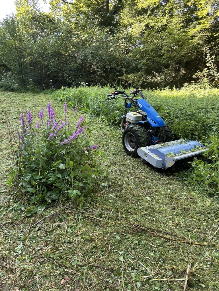

Depending of where one is living, one or more of these invasive plants really are a menace, as you rightly say.
If I’m right, you live in the northernmost part of the US, and probably in a climate somewhat like the one we have here in central Europe. I would therefore expect that on top of the Japanese knotweed, you also have giant hogweed and Himalayan balsam in your area?
These 3 invasive species are to my knowledge the most common ones in my area, and I sadly don’t see how we are going to get rid of them anytime soon. :cry:

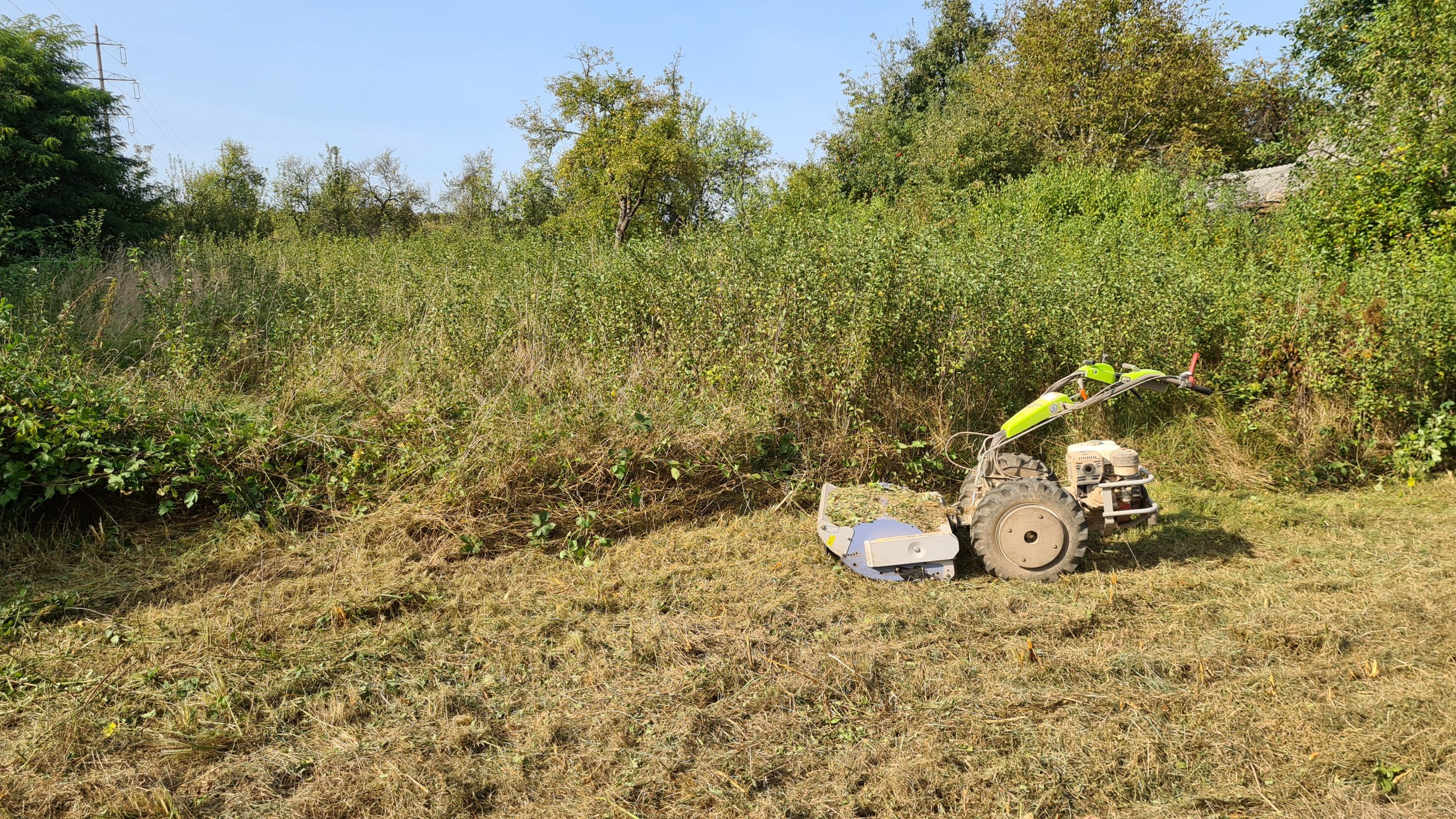

Not only invasive species might become a problem, some of our native ones might as well. Some 6 weeks ago I was asked to mow a meadow where stinging nettle and blackberry was getting out of hand, taking over perhaps ⅓ of the plot.
After a few hours of hard work, Berta and I had cleaned up, and we had one more happy customer in the book. A few purple-loosestrife had been able to grow despite the tough competition, and I had to spare them. This plant is one of the most insect-friendly plants in my area, and on sunny summer days, they are full of insects from sunrise to sunset :giggle:
