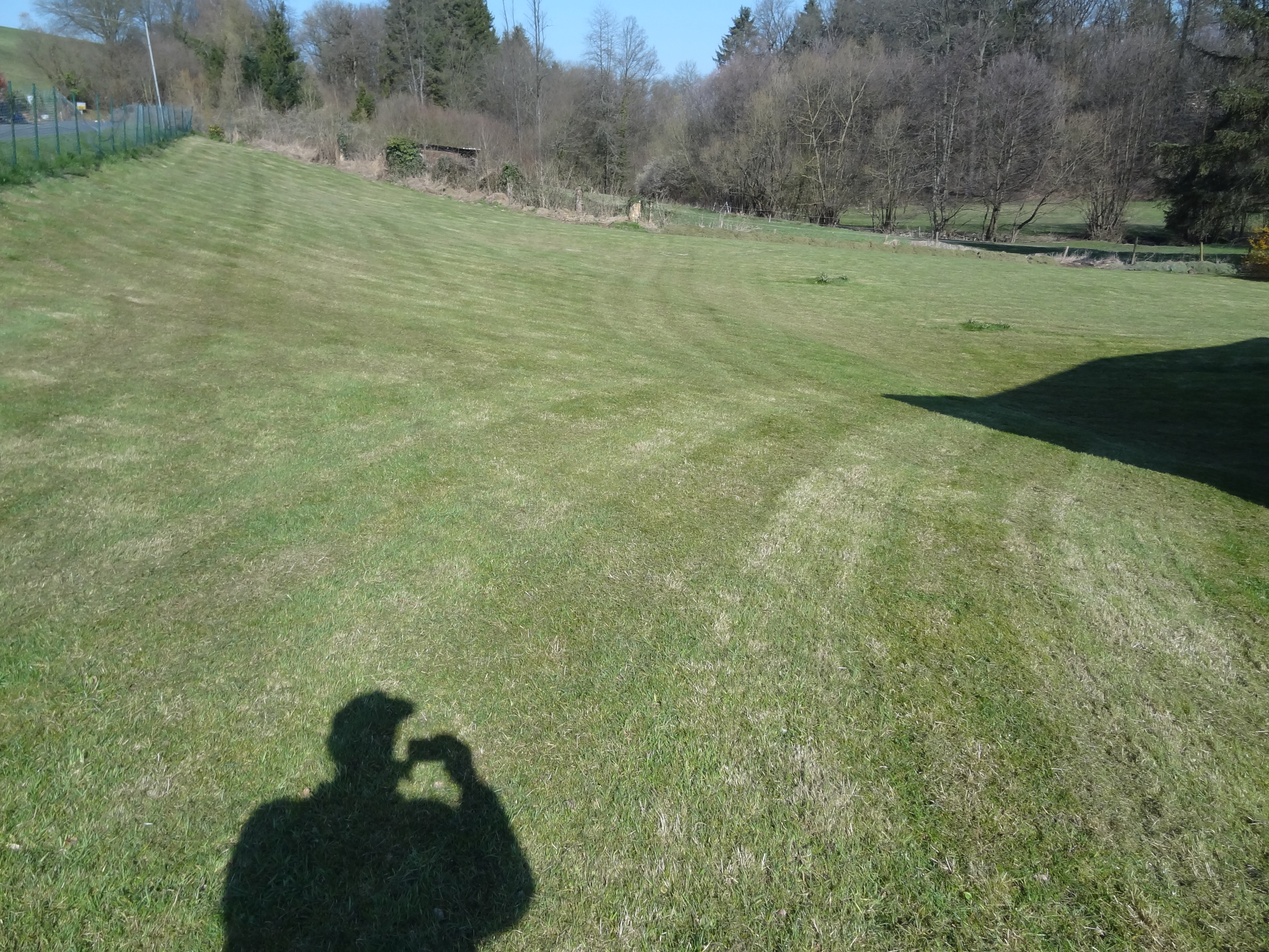

As I wrote post #6 in this thread, I hadn't any pictures to show, so it was probably a bit difficult to visualise the results. Now I have pictures, and I hope they might help a little 🤔
The above 2 pictures shows one of these areas, where the wild boar had turned the sod upside-down. On the first picture, the "damaged" area is on the left, and the area that I'm working on, is on the right. This is how it looked after one pass. On the second foto is the finished result, after 2-3 passes in total, with the cutting height set at around 22 mm. As a first try I was rather pleased with the result, but I will probably tryout an even lower setting later.
As said, I also tried to use the Berta at its lowest 8 mm setting, as a sort of scarifier/de-thatcher. Here is how it looked:
I began my mowing the lawn like I always do, with my Zanon lawnmower set at 8 cm cutting height. Then I changed to the Berta flail mower, and worked the lawn one more time. Whereas the lawnmower can easily work in 3. gear, the flail mower had to work hard in 1. gear! For me it was "a walk in the park" though, as I just had to walk slowly behind the tractor - and on top, I didn't have a bag to empty all the time 😉
This is how the same area looked the day after, and after my nice neighbour had removed the clippings with his ride-on mower:
As an extra - and to me unexpected - bonus, my lawn has grown much better than in other years, and become much nicer to look at. Especially the honeybees are just enjoying the white clover so much 😊

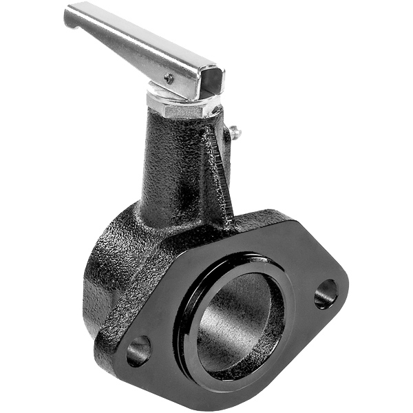

I order today the berta for 2674 usd with quick coupling included.it arrives in max 3 weeks.Can you post some pictures of the grillo with berta ?

this is for the grillo and is the tractor side .
