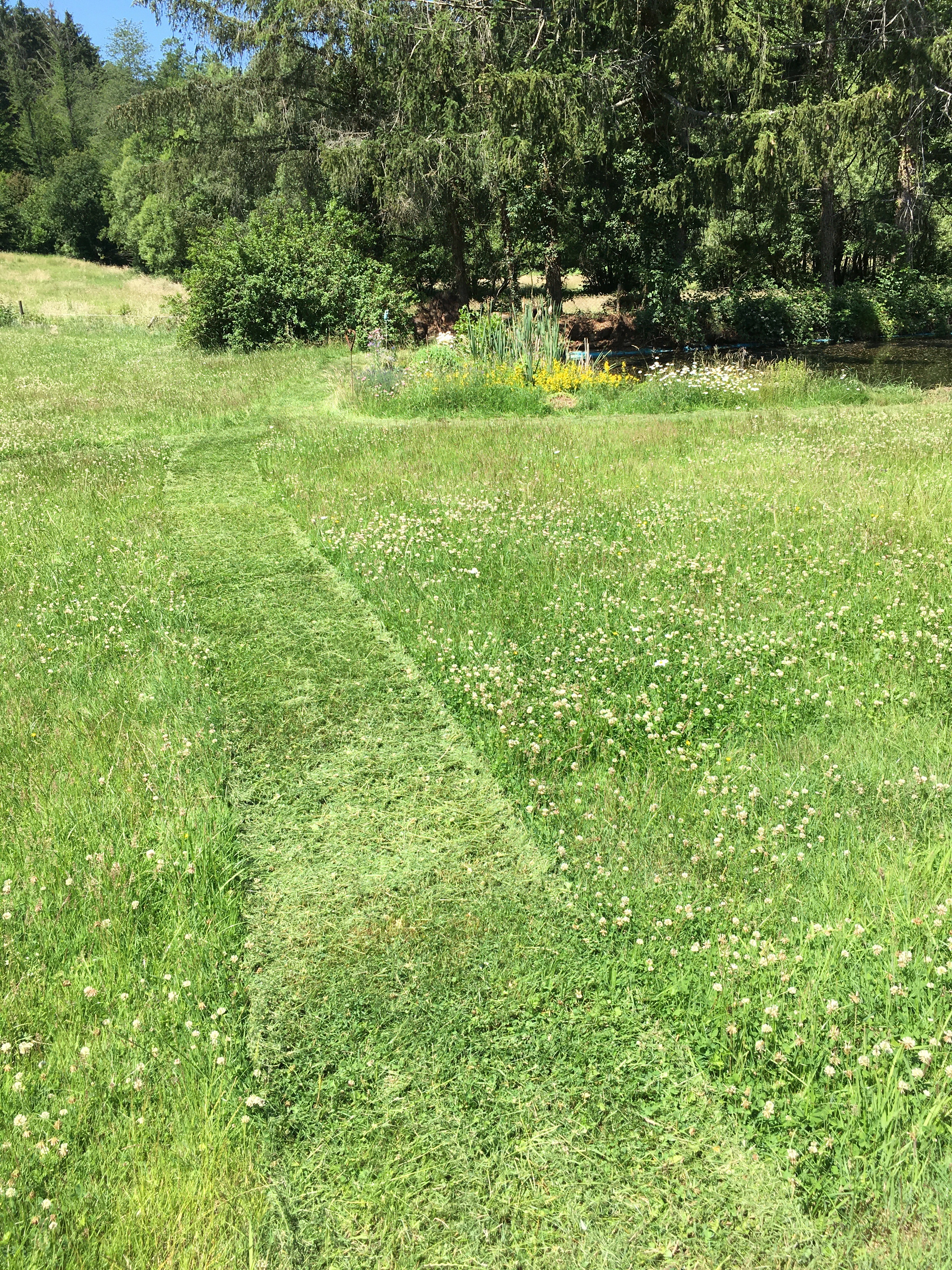

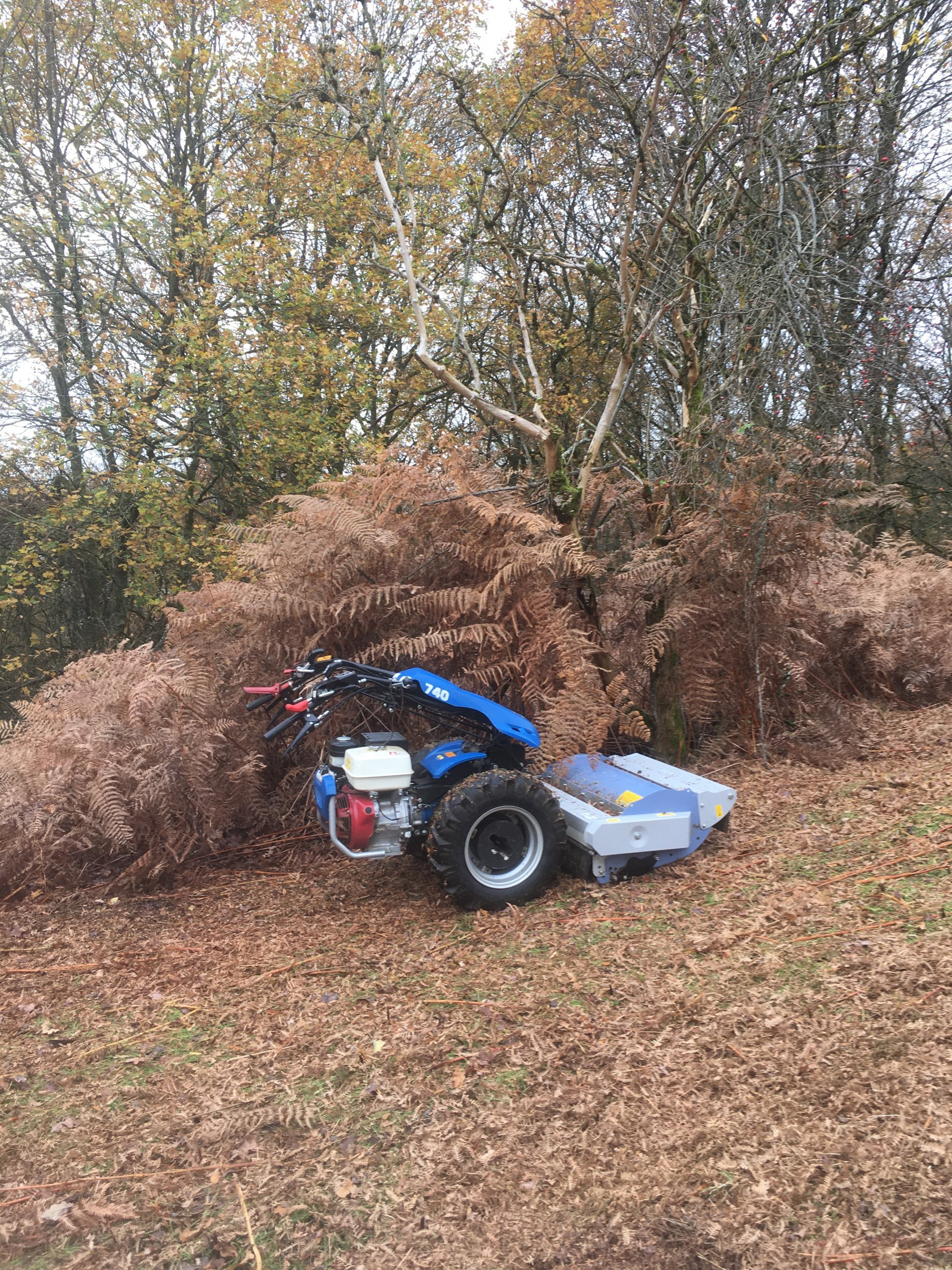

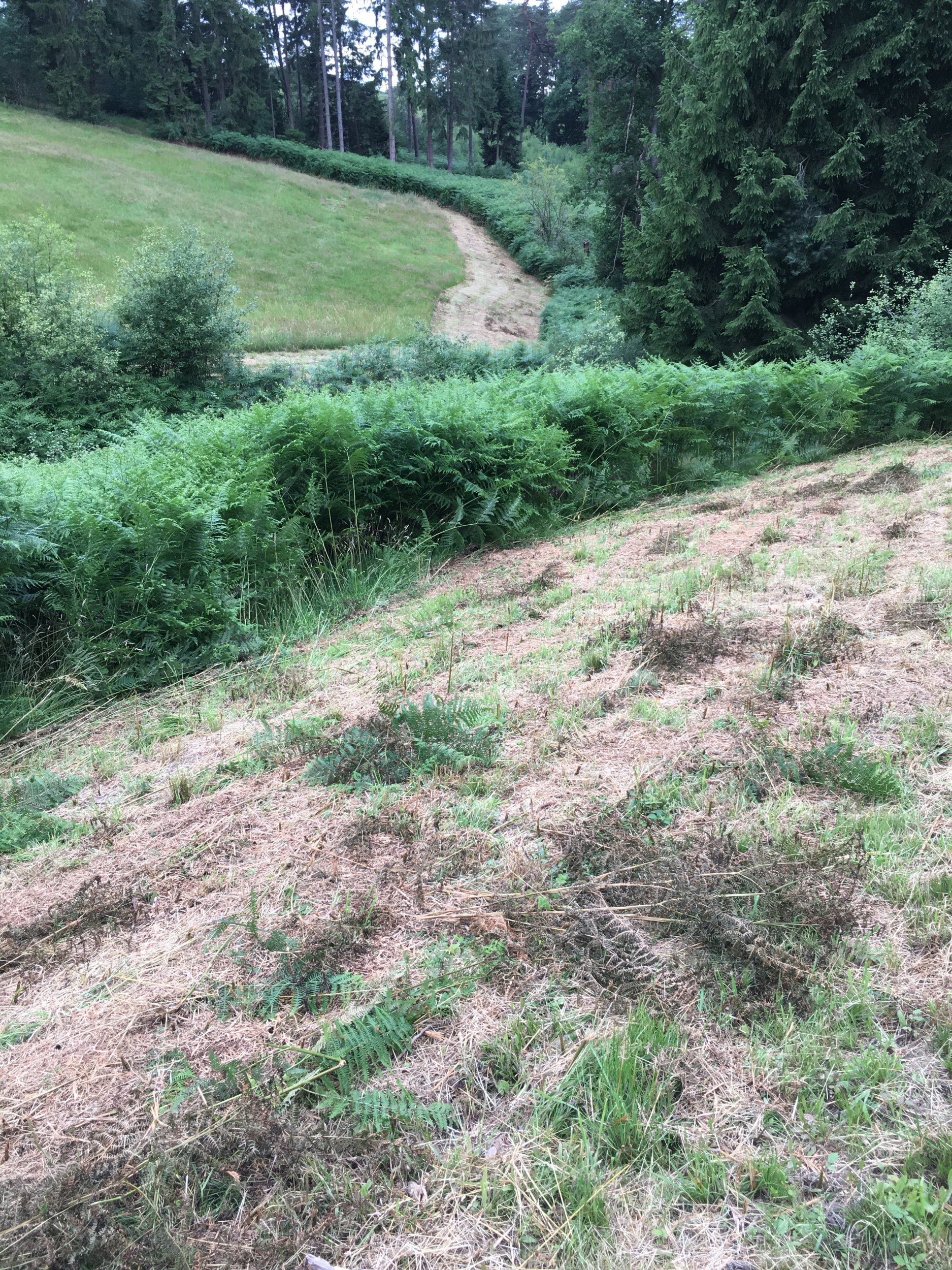

I have had my Berta flail mower for some 1 1/2 year now, and I have used it for almost 50 hours.

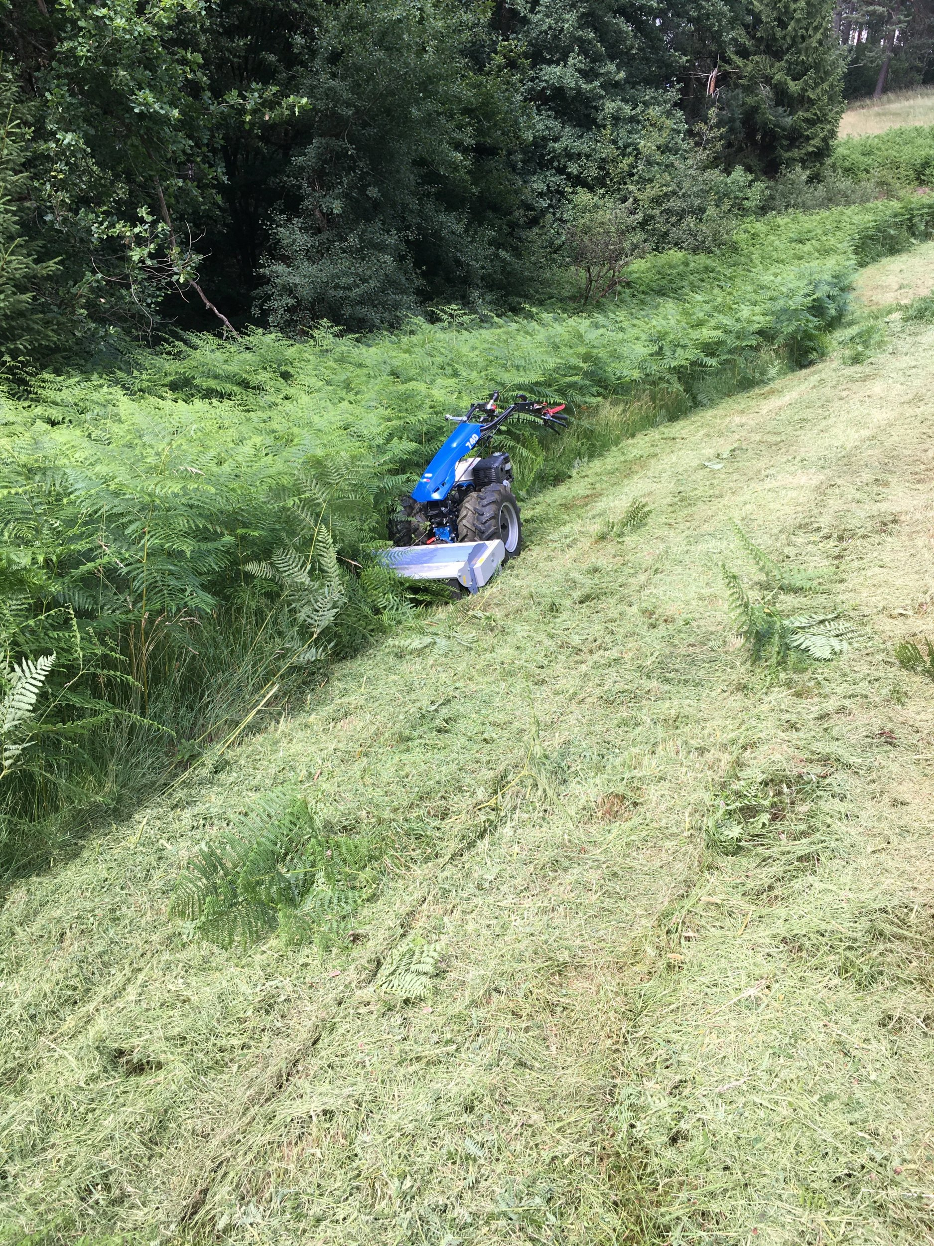

Like other members, I have experienced that the flail mower tends to rise when mowing uphill. This is physics, and it is what we might expect with all front-PTO implements. For me it begins to be critical when approaching around 20 degrees of slope, and then I only mow downhill, and walk idle uphill. With a light implement like a sickle bar mower, I mow across the slope up until around 20-30 degrees, and then again only downhill. I haven’t been able to successfully mow across a slope with heavier mowers, like the Berta flail or my Zanon lawnmower. Gravity is simply stronger than this old man :cry:
One task where the flail mower has proven very efficient, is getting rid of up to 2 m (6 1/2’) tall eagle fern, which tend to invade some of our meadows:
I mow with the cutting hight set at its maximum of 5 cm (2’’), and then I mow in first gear taking half cuts. This way the Honda engine stays on top of things, and the cut material gets a second treatment.

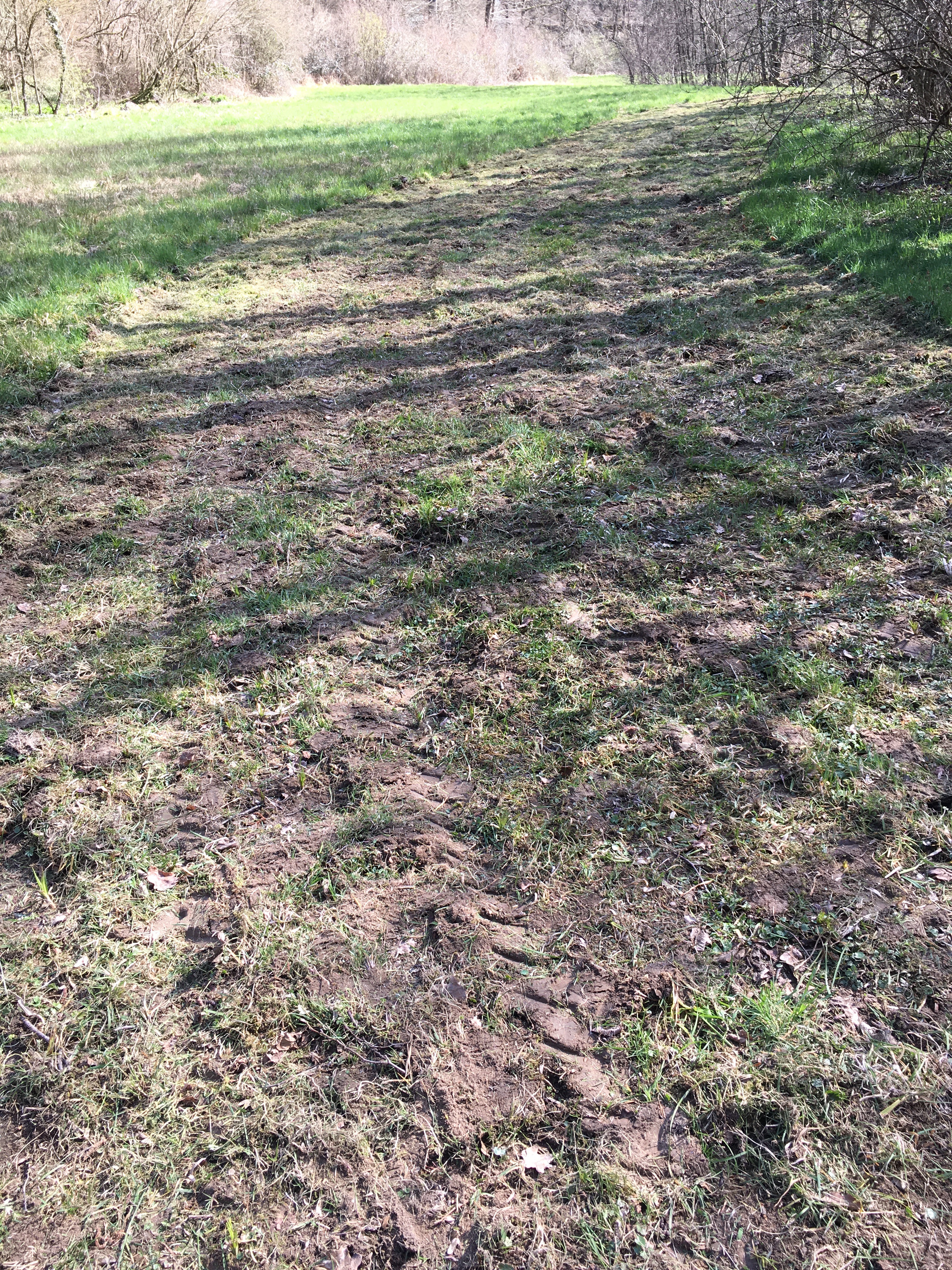

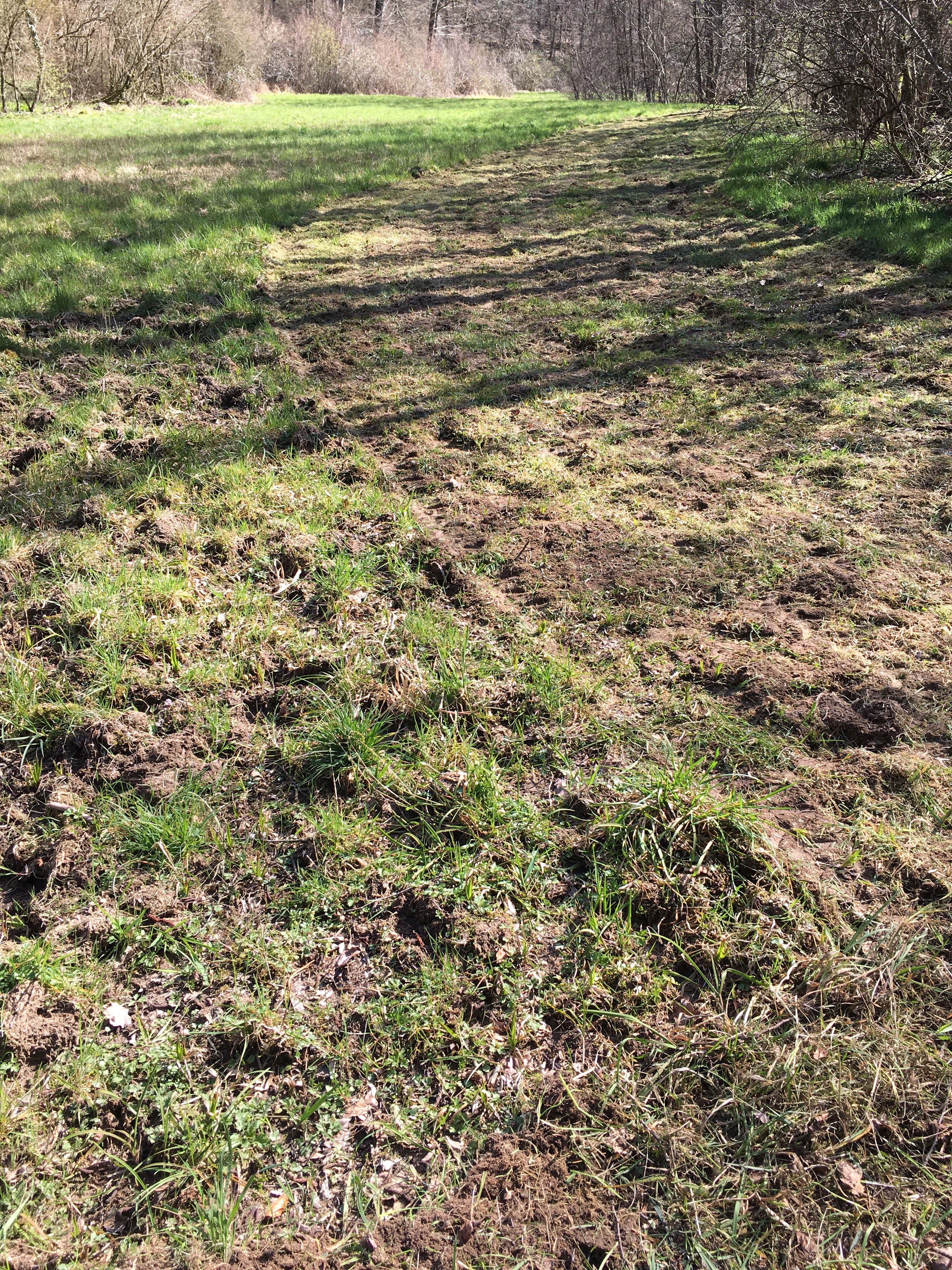

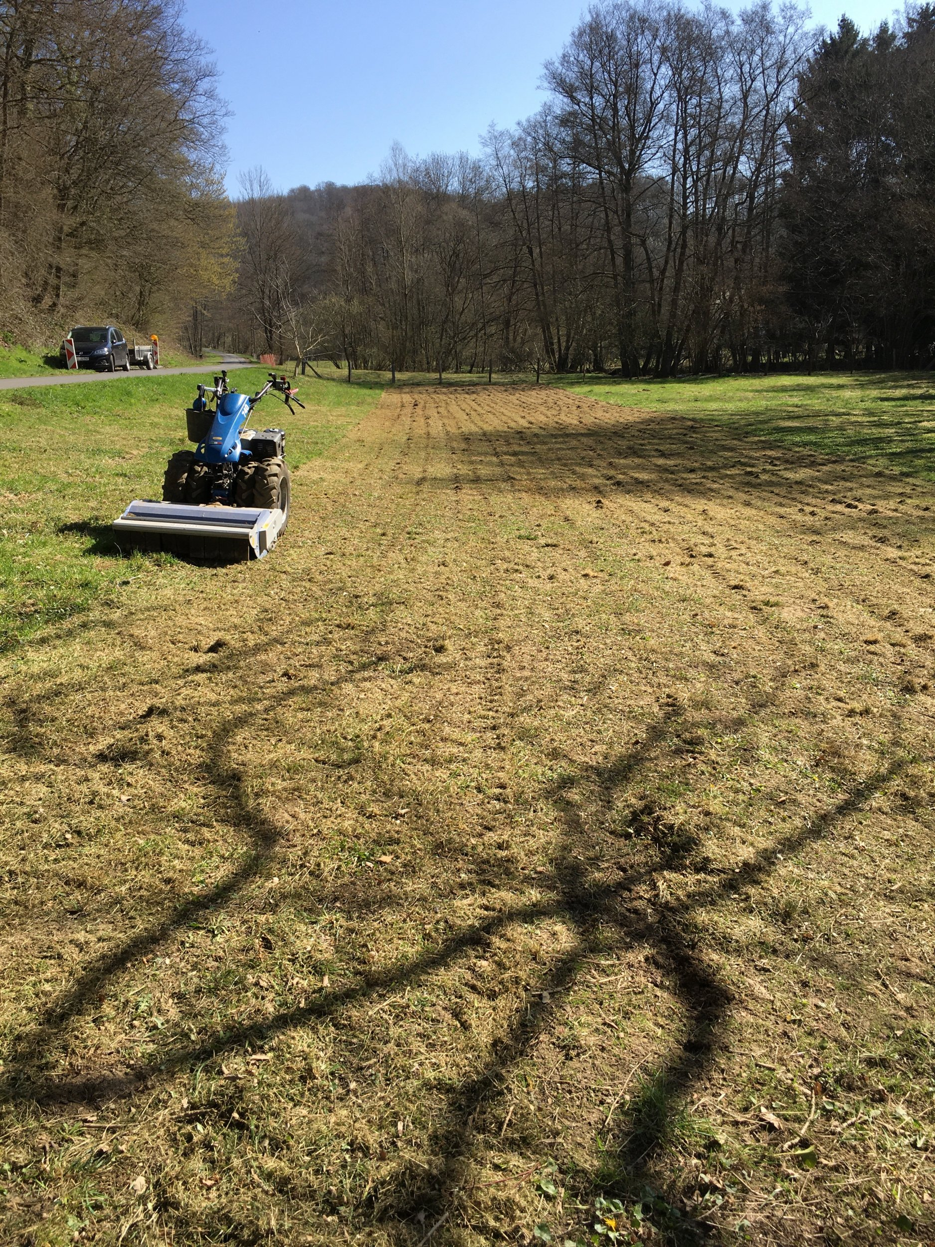

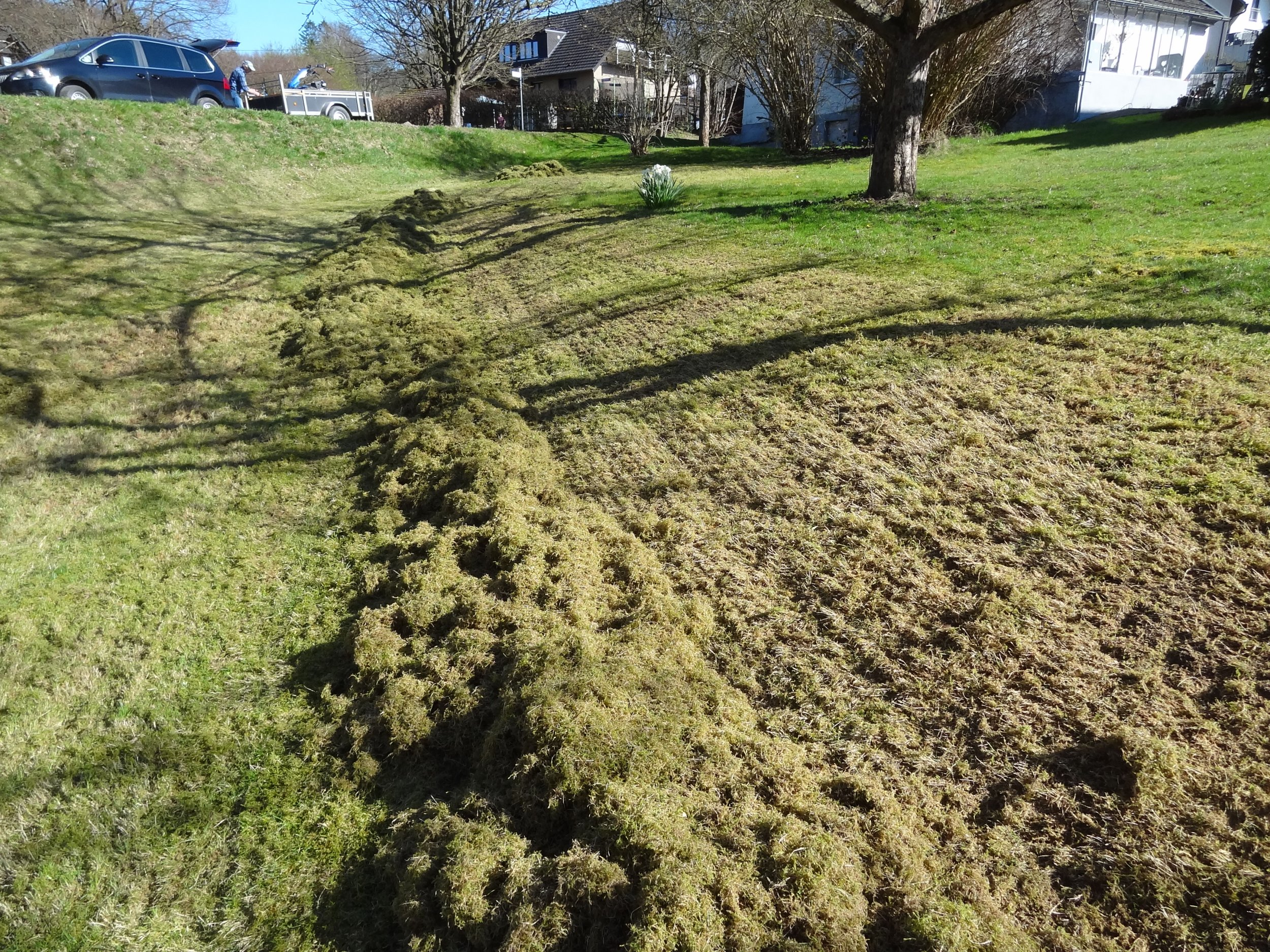

As mentioned in some of my earlier posts in this thread, I also use my Berta as a sort of scarifier/de-thatcher, to remove moss and old/dead plant material. This foto is from a lawn, where the moss had taken control:
This one is from my meadow, where after the grass had been mowed and removed, I used the Berta to prepare the plot for seeding wild flowers for the insects:

Nice! I have around 90 hours on my flail mower and wouldn't be without it. I find that my hammers need some touchup work every fifty hours or so and that it helps immensely with cut speed. Dull hammers suck more power which means a narrower cut.
I find I can mow side-hill pretty well on, I guess, a 30 degree slope. I find the key is to have the downhill to the right (because my clutch is on the left handle bar), then on the hill, I straighten my left arm out and "hang" off the bars to the right, pulling the back end downhill and the mower uphill. Of course I also have diff-locks on and use the steering brakes to help.
I don't get a perfectly straight line with ideal overlap, but I get it cut without doing endless circles of wasted mowing. I find this technique doesn't work near as well with the downhill to the left, possible because I can't reach the steering brakes.
The steepest sections are still downhill though, but I try to work it into a circular pattern to minimize covering ground repeatedly.
