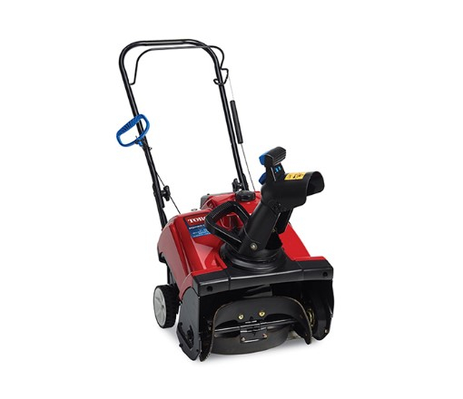

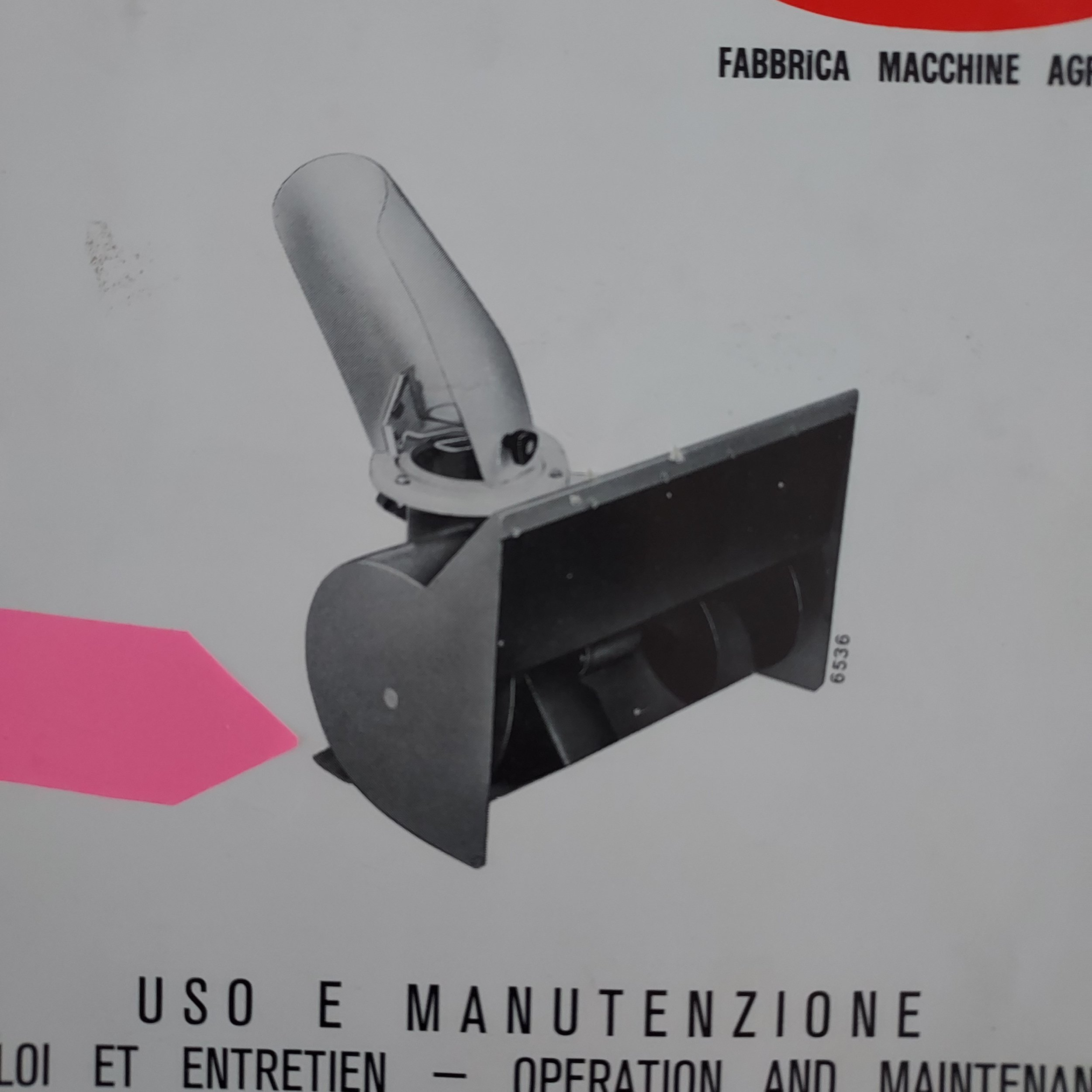

On many of the small, single stage blowers the rubber edge of the auger is designed to contact the surface being cleared and provides the tractive force (e.g. Toro "rotor propelled" 518 ZR). These do a good job of clearing right down to the porch boards, walkway pavers, or driveway asphalt but tend to pull grass and scatter stones. Older and generally larger single stage blowers have skid shoes that raise the auger or fan.

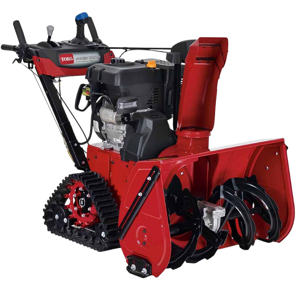

For use on gravel or grass surfaces, I would seriously consider a blower with tracks instead of wheels such as this one from Toro:
They're pricey but eliminate the need for tire chains and they "float" better on uneven surfaces.
