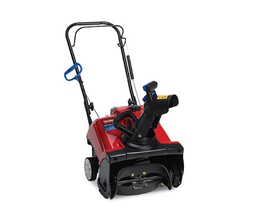

On many of the small, single stage blowers the rubber edge of the auger is designed to contact the surface being cleared and provides the tractive force (e.g. Toro "rotor propelled" 518 ZR). These do a good job of clearing right down to the porch boards, walkway pavers, or driveway asphalt but tend to pull grass and scatter stones. Older and generally larger single stage blowers have skid shoes that raise the auger or fan.

A single stage blower has a fast spinning paddle or auger that tends to grab the grass.
A two stage blower's auger moves much slower, moving the snow towards the high speed impeller for discharge. It doesn't tend to grab the grass nearly as bad or fast.
Maybe we’re talking about two different things.
Is there’s 8”+ of uncut grass sticking up in the snow?
I don’t understand how an auger, single or double stage, is going to grab frozen grass (that is at mowed height) from under the snow.
My understanding is the height of the snowblower’s shoes will determine how high the snowblower’s cutting edge is above the grass. This will determine if the cutting edge grabs grass.
For me, it’s only a concern when there’s no frost in the ground’s surface layer that unpaved surfaces, (grass, dirt, gravel) get ripped up.

single stage can rip grass. dual stage doesn't . I snow blow over a lot of grass.

The grass is 2.5" tall. The skids ride on the dirt, not the grass. Unless the skids are set up more than 2.5", that high speed thrower is gonna grab the grass, or at least tear the heck out of it.

As said before . Single stage blower have a spinning set of rubber paddles that contact the surface and throw the snow out the chutes.
Dual stage blowers first have a scraper blade on the bottom of the chute opening. I like to keep this blade 1/8” off the ground . You set this height by the shoes on the outside of the chute . When the first auger spins it breaks the snow up and funnels back to the second stage which throws it out the chute. I have never scalped or dig into my grass if the shoes are set correctly.
