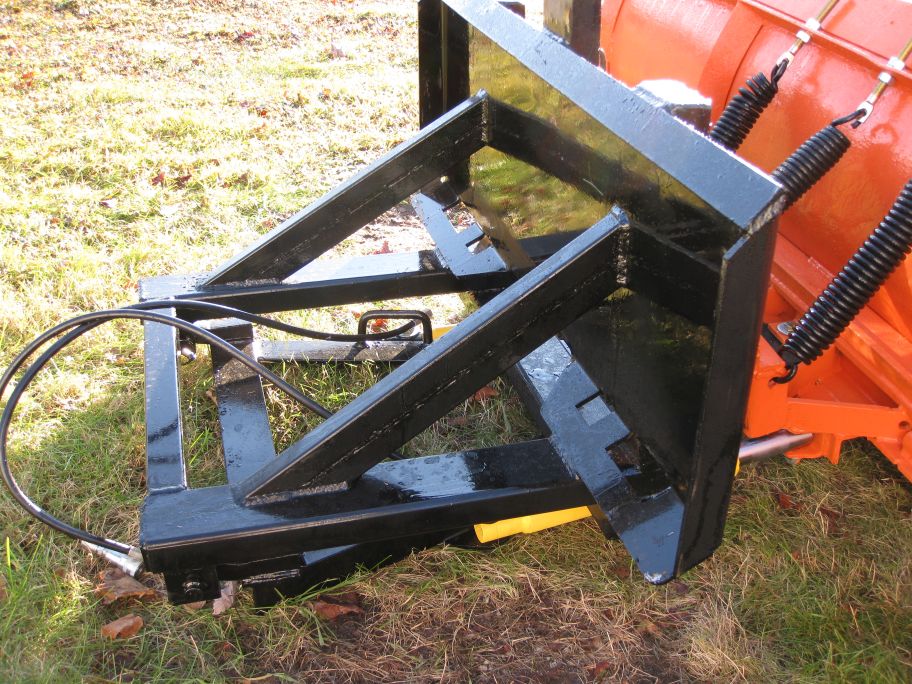

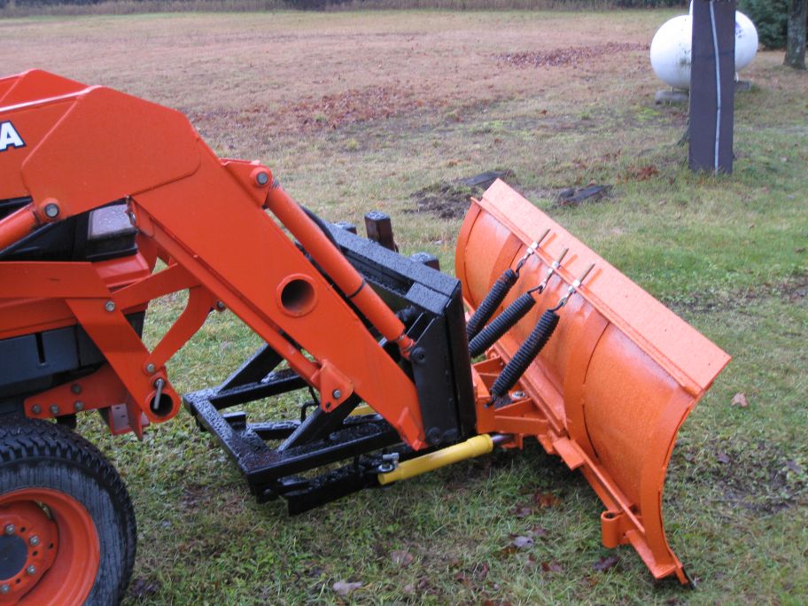

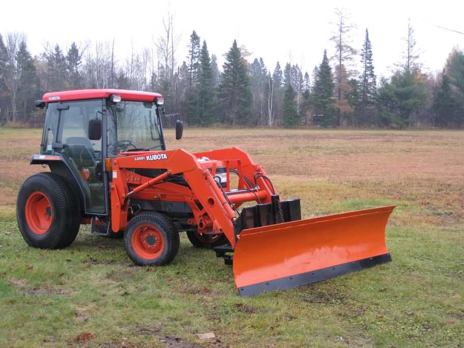

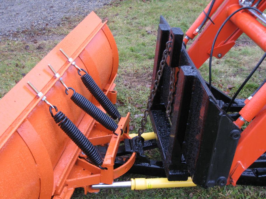

This is my set up controlled from rear remotes and it works great, manual angle would be a pain.
/ snow blade tilt? #16
I could not do the plowing that I do in without the hydraulic angle function. Ok, I could but it would take 3 times as long easy. No way I would live without it.
Chris
/ snow blade tilt? #17
Rayclar's is the bees knees, since it keeps the blade close-in. Plus it's beautifully done.
My 8' Fisher hangs off a modified truck A-frame setup welded to the Ford quick-attach. Power angle works fine off the rear remotes with 2 s/a cyls. Speeds up plowing over manual angle at least 2x. Steering is fine. I keep a heavy Gannon box on the back and weight distribution is good. I'd guess my setup weights 6500# or so, R1 tires. YMMV with a lighter rig.
