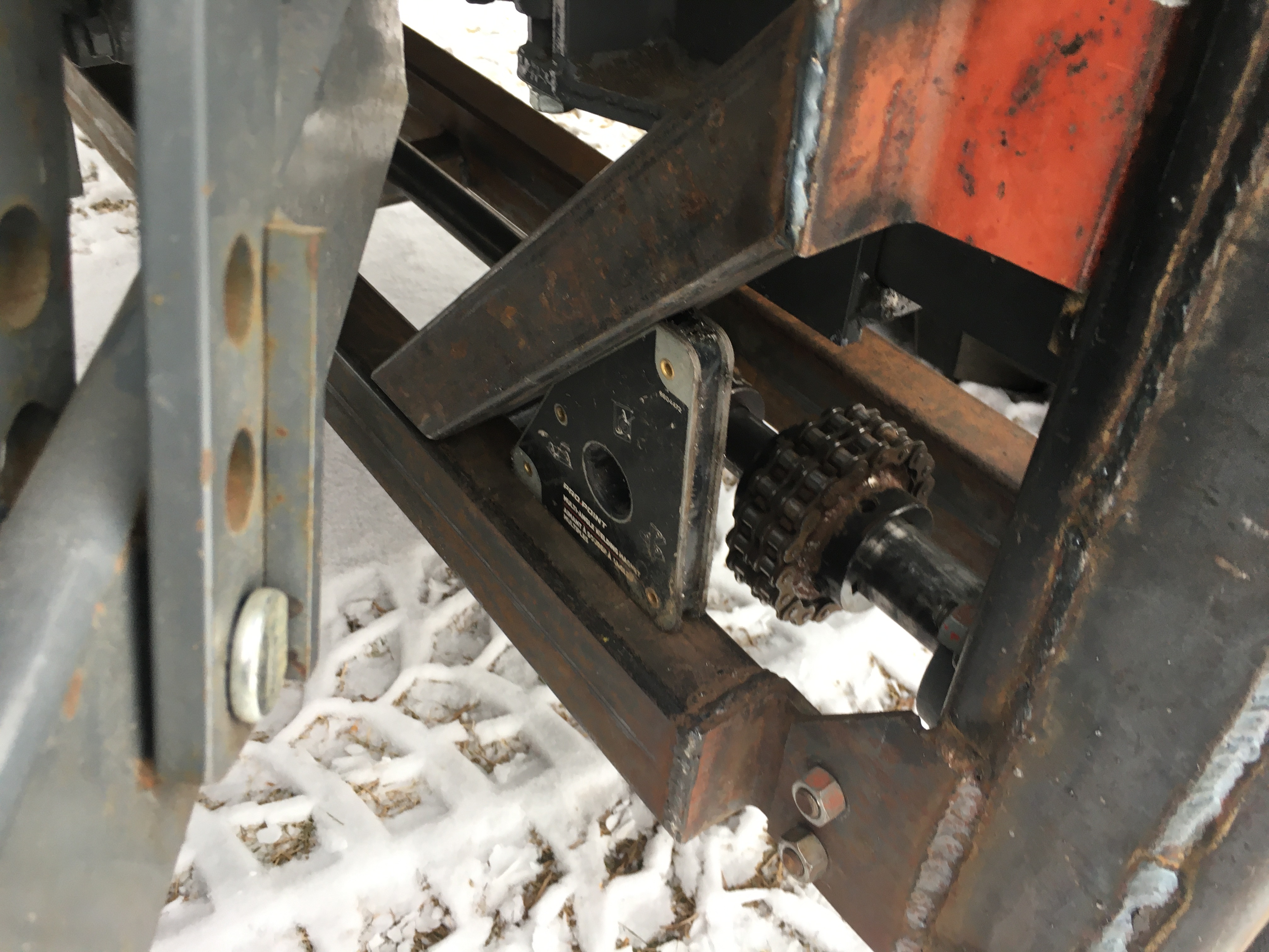

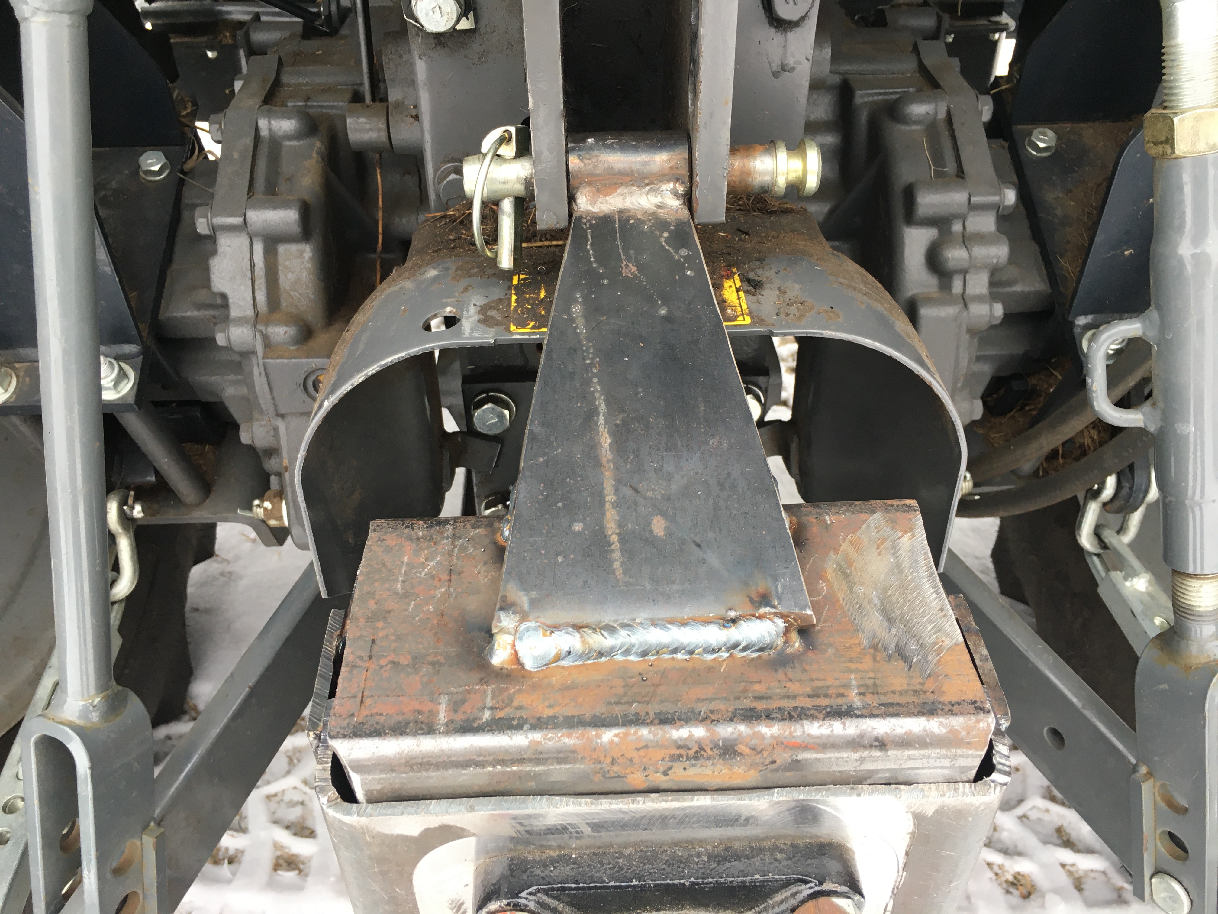

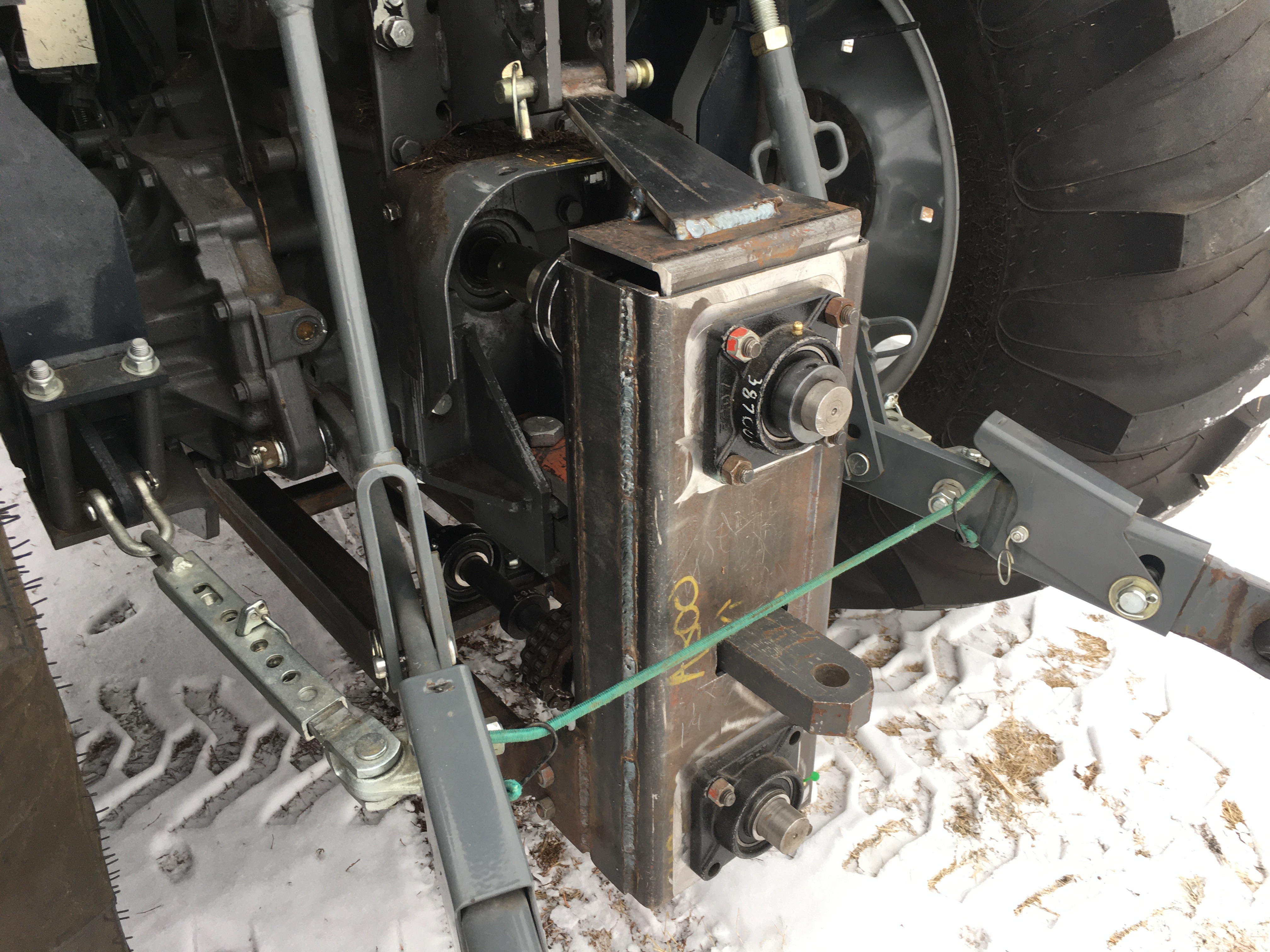

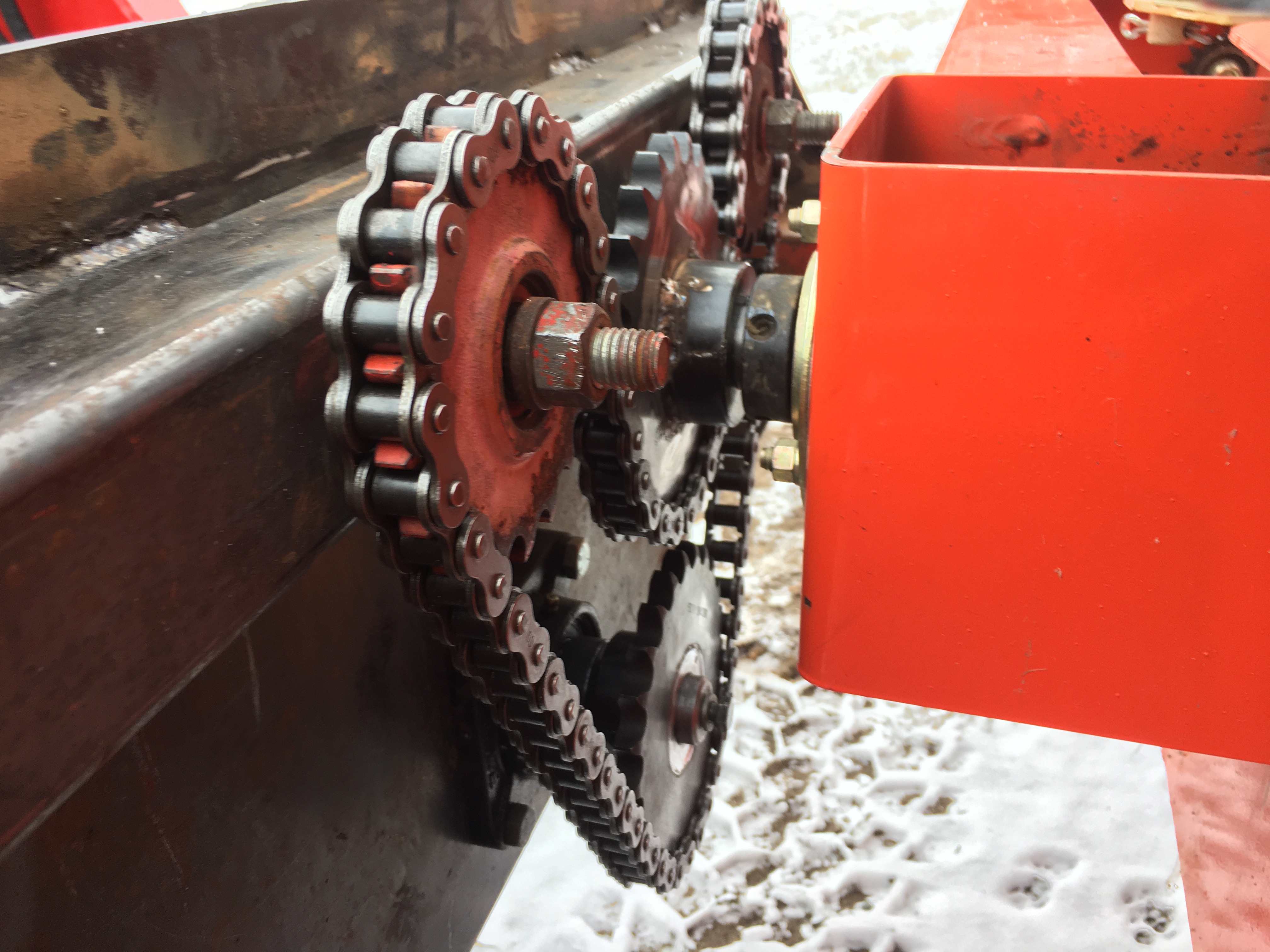

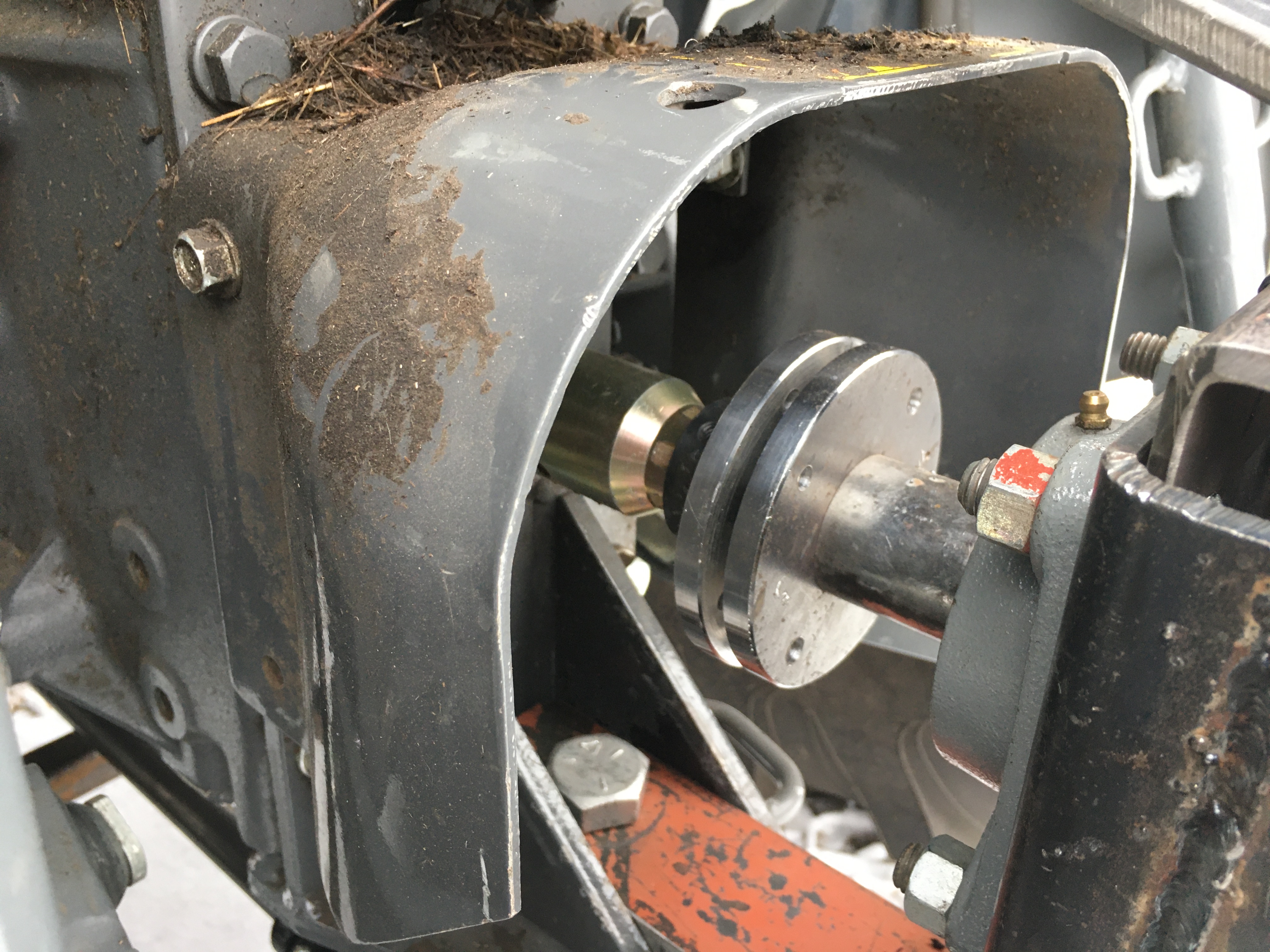

#34
I can feel it getting closer. A couple of pics. The top brace had to be welded in position, the angle braces will also be welded in position to keep things aligned . AD4A4ED2-3CE1-4BBA-AECA-FD1A21504F3F.jpeg1F72AD48-AE5E-44CF-AFF1-5F41B6122DA6.jpegC7A9ADC6-CC4F-495A-9C69-A23D6B8A47BD.jpeg1338A6BA-9AE3-487D-AACA-2F575F03D5D3.jpeg99DD6851-87F2-47FC-AA88-095618BDC047.jpeg

Unfortunately the tractor does not fit in the garage I use for a shop. Main quonset with floor is not 220 wired, smaller one is wired but packed full. Too much of a pain to move stuff out for a couple of welds. I try to plan for as little outside work as possible, sometimes it becomes neccessary though. Once everthing is aligned and securely tacked , the whole thing comes off with three bolts and a pin for final welding. Still have loader function to put it into the garage. Then I can pull it out, position it, back up and lift into place. The draw bar goes through and acts as a guide. The draw bar pin gets removed and is replaced by a 1" bolt through the 1x2 3/4 main mount on the chain case. Push a cheater on the front pto, lift and block the assembly up and install two bolts. I still have eight inches of clearance underneath. Hope my rambling makes sense.

Maybe I was not clear, just a couple of welds have to be done outside. The joy of still having the loader, I can move things into the garage for welding, take it out for fitting and thinkin, put it back in for more welding. I have a home built wood stove in the garage.
