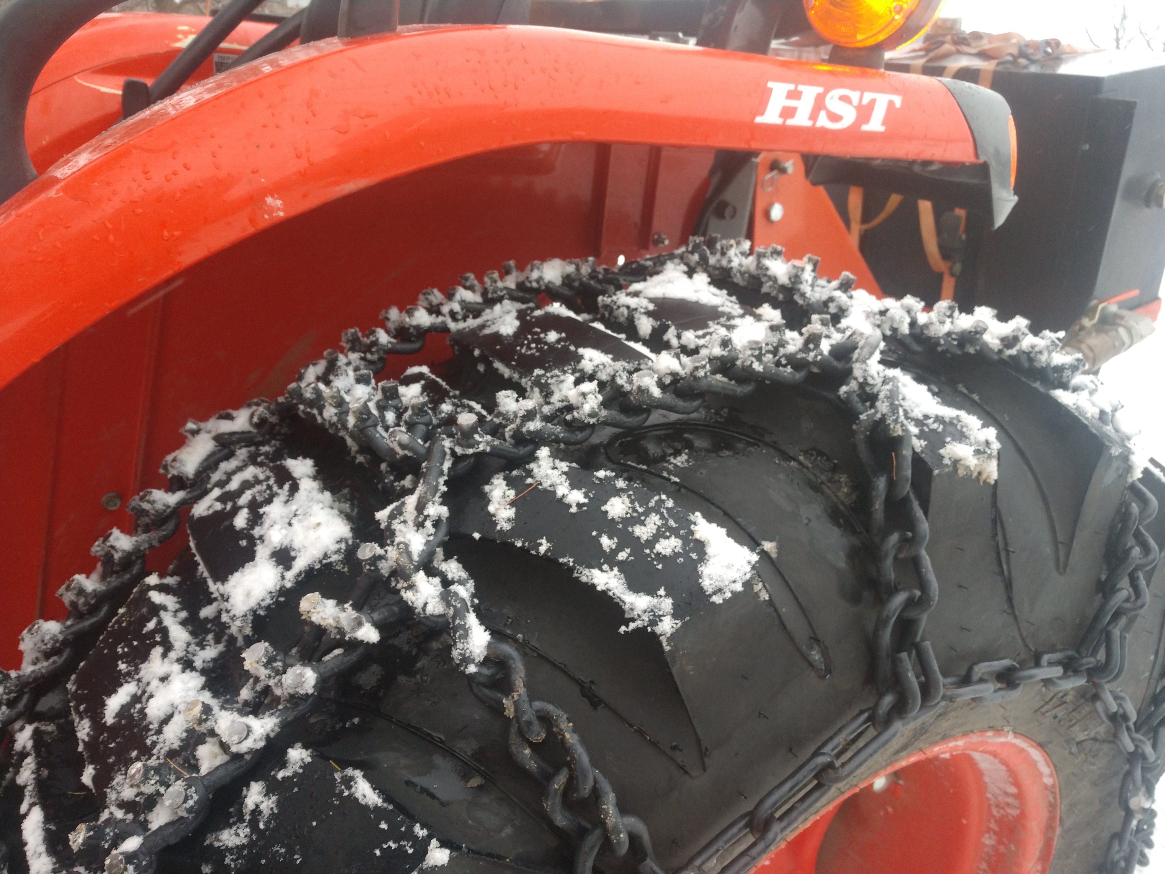

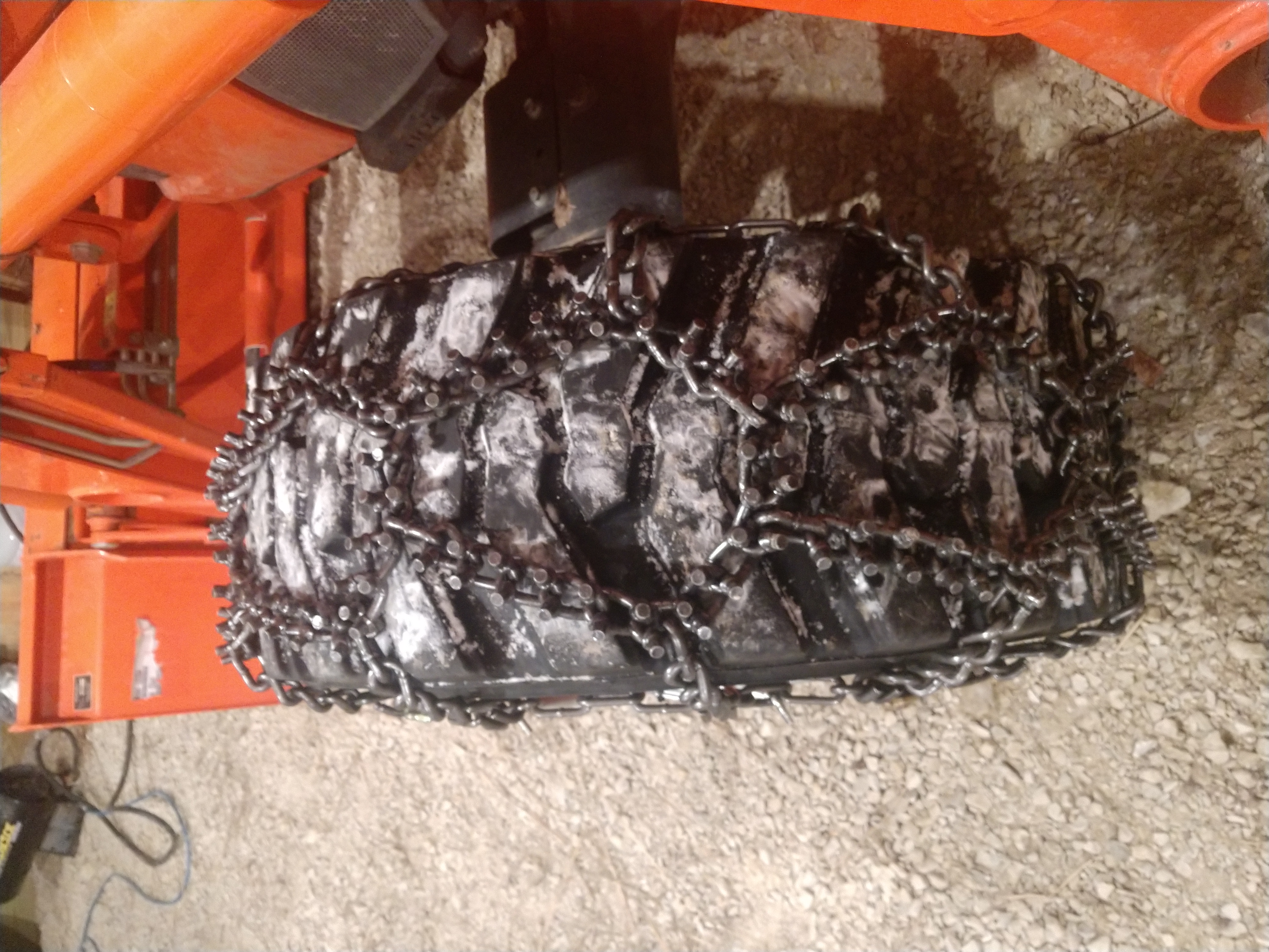

I've described them as "ice magnets". They are as close as it gets to being magnetic to ice. :thumbsup:

At the beginning of this year we got 48" of snow in 24hrs and it was a surreal time in our area. I was lucky that I had just purchased and installed ice chains on all 4 tires and had the rear facing snow blower on at the time. Otherwise I would have been screwed, like a lot of my neighbors. My next door neighbors have a dozer, excavator, tractor and skidsteer and they couldn't deal with the snow. The dozer was in a back field and they couldn't get to it, the skidsteer didn't have chains and was useless, the tractor had "H" pattern chains and they were useless. I ended up clearing their driveway going uphill while blowing snow. They were amazed at where my tractor would go and immediately ordered a set of euro ice chains for the their tractor. You should have seen the smile on the neighbors face when she first pulled her tractor out of the barn with the new chains installed. Then she put it to work and could not believe the difference those chains made.
They are expensive but I am very glad I spent the money. Not saying everyone should have them or needs them but for my conditions it was one of the best purchases I have made for the tractor.
Your story along with the ending statement says it all. I would/could not be w/o euro type chains here.

Every year our driveway ices up and it's steep. Before last winter I decided to get a bunch of sand/salt mixture and a spreader, so I could at least spread some on the bad parts and make the driveway a little safer. That worked OK and was a slow process but I discovered something that worked better. I would just run the tractor up and down the driveway, in the wheel paths and the ice chains would chew up the ice, leaving a very rough texture that was better to drive on, than when it was sanded. Now I have a bunch of sand and a spreader that I will probably never use again. As an added advantage, it is way faster to drive up and down the driveway than it is to go slowly spreading the sand mixture.
   / Snow痴 coming #114
I do the same thing. Our road is way to long to sand. I find ice chips from running the chains on hard ice work just like sand. And in the spring when there are daily freeze thaw cycles I run up and down the road just before it refreezes and tries to slick over. The pock marks gives enough texture to drive on.

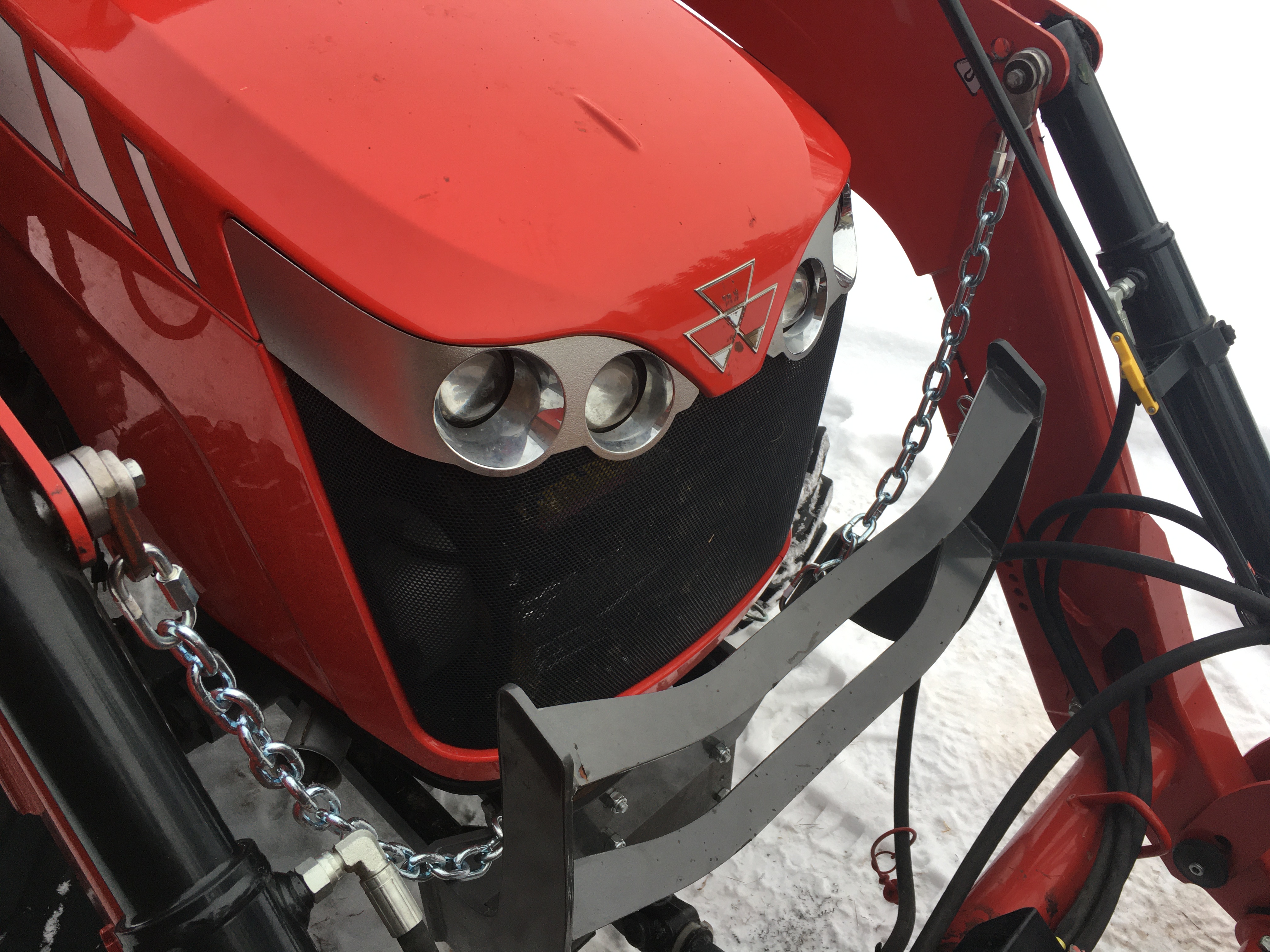

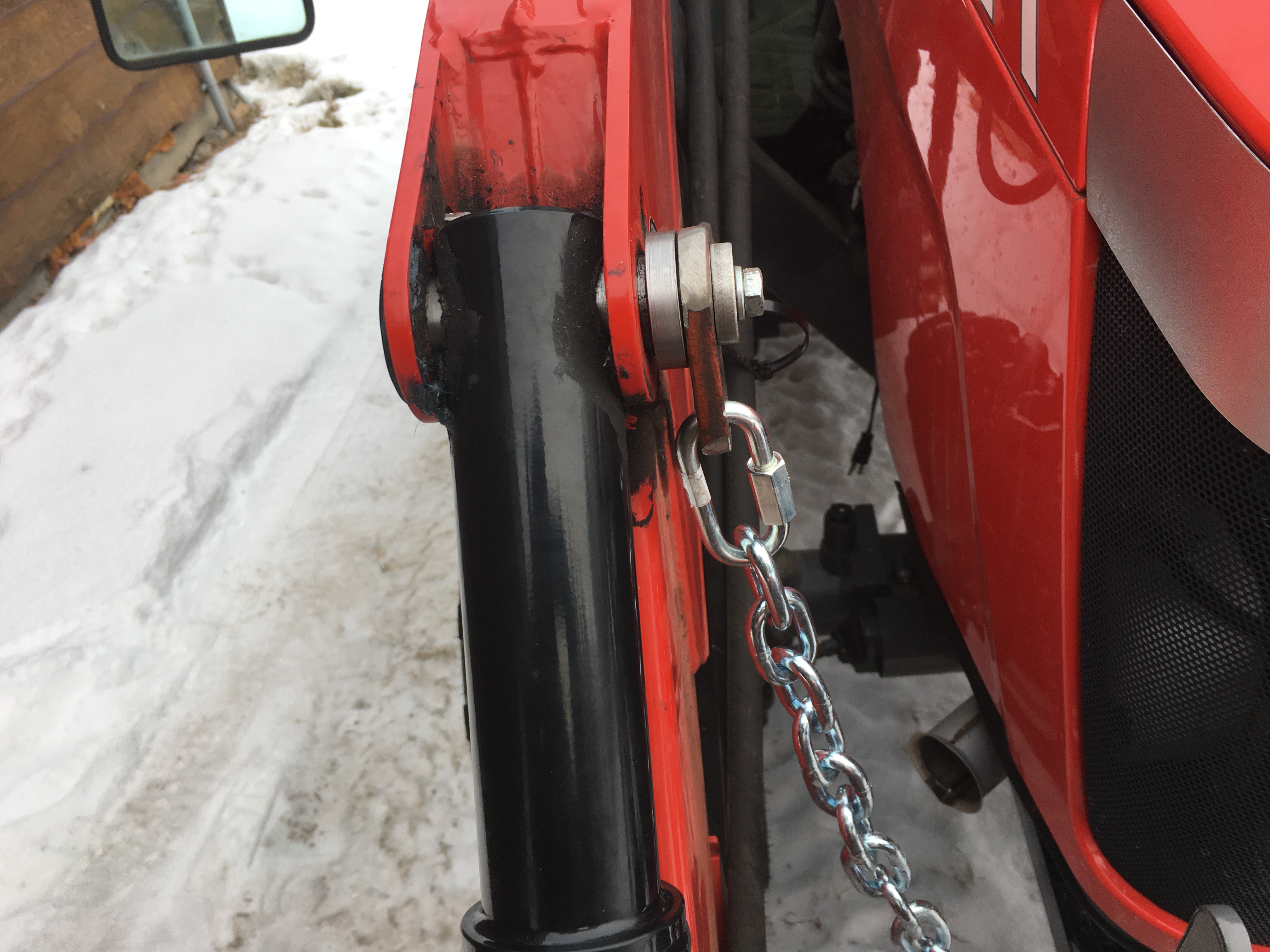

Final bits coming together. Easiest seemed to be limit chains. The cylinder pins were not long enough so had to make new ones. Highly doubt the little bolts in the ends would hold the cylinders. New pins have one inch stubs. More of a visual indicator as the hydraulics can torque up the front end. E2310400-3496-49E9-8C53-AF654DD85A2C.jpeg4CD85831-9974-4192-8BFD-56041EDB1E6A.jpeg

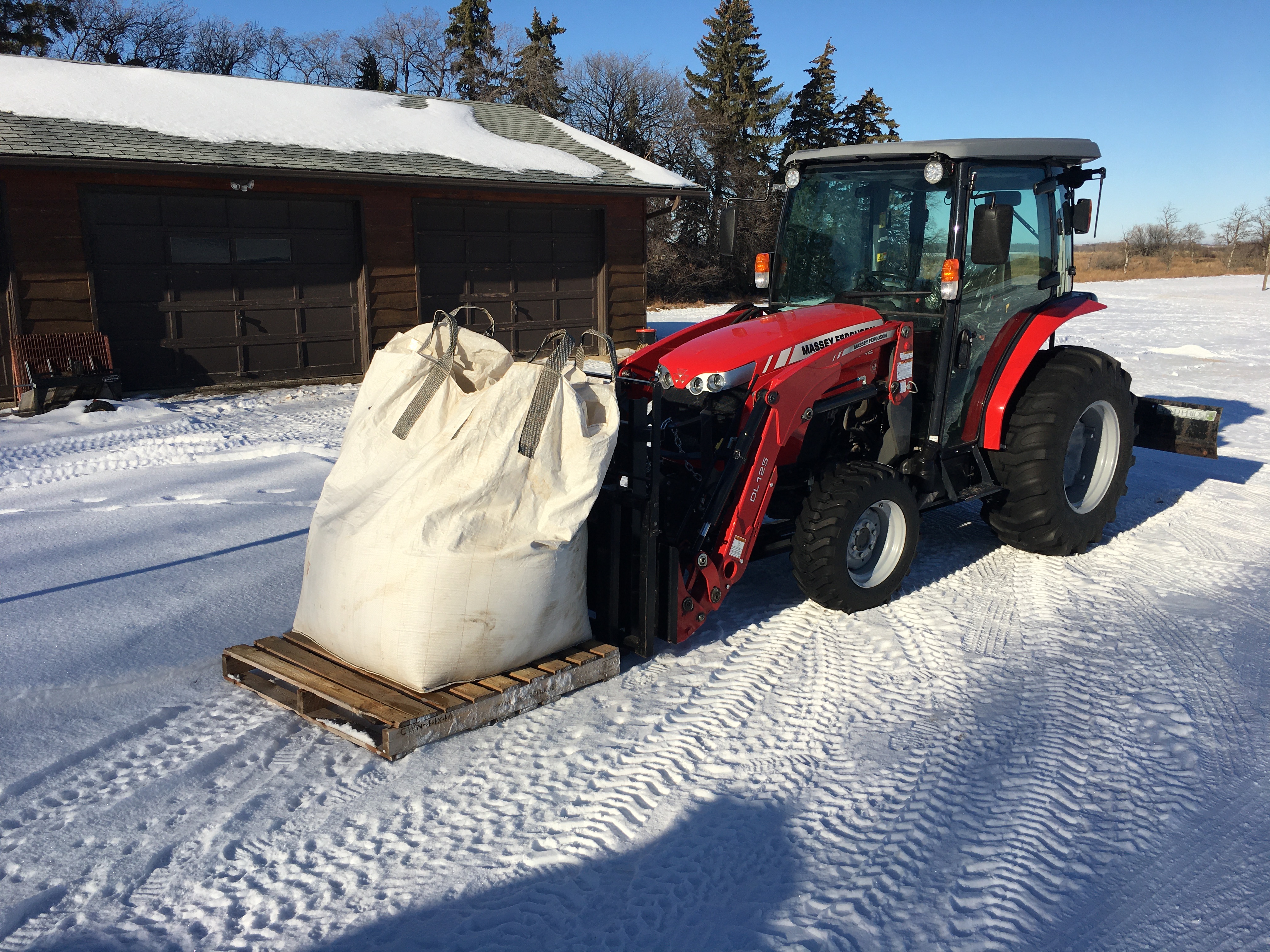

One of the reasons I prefer to keep the fel on. Got two bags of peas, thousand lbs each for deer feed. Have to get it when the seed guy has it. I get him to do two bags as one full one is too much for my loader. 94DC9497-411A-47BA-828E-FD9F7D519ACB.jpeg
