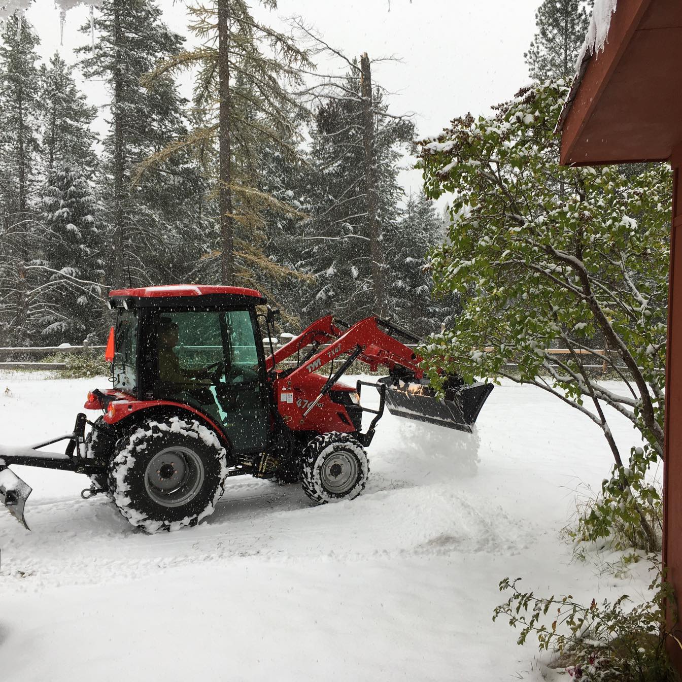

First snow of the season in NW Montana. Gotta use front bucket/rear blade carefully until ground is frozen, THEN the MK Martin inverted blower will be the weapon of choice.

We got a couple of inches of snow yesterday, but it was so warm, it was gone by the time I got home last night.
If you put Edge Tamers on your bucket's cutting edge, you won't have as much problem with pushing snow over soft ground. Won't help with tires rutting things up, but that's another subject.
