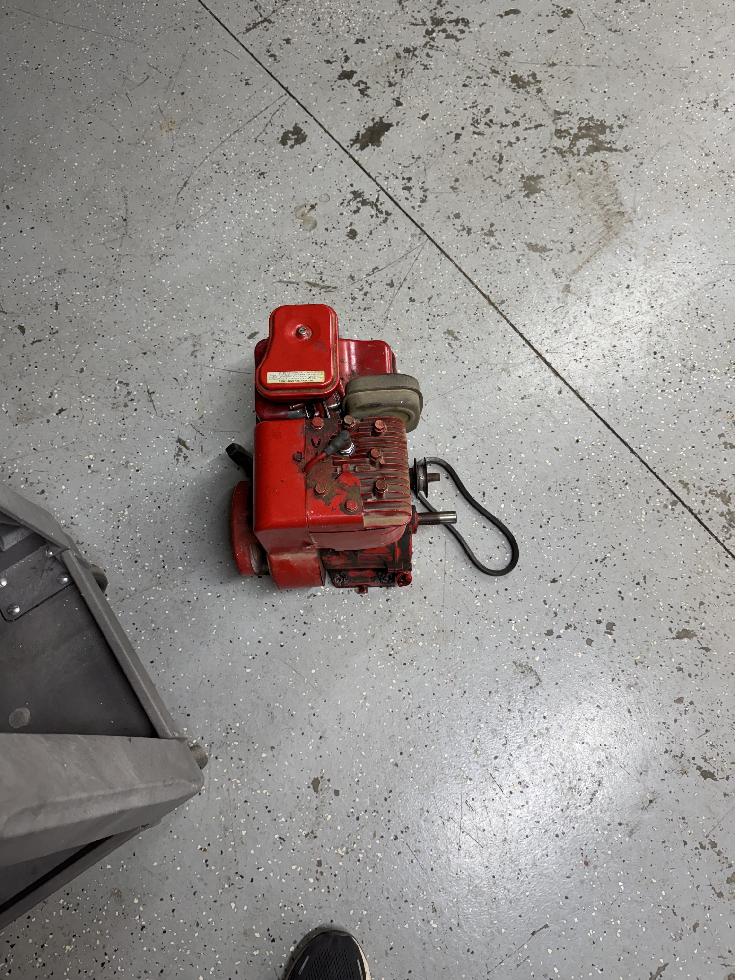

No longer than it takes I pulled the head. Neither valve will spin when fully closed. I liked that idea but I don’t think that’s it.
I should also add that there is a small chamber under the short intake tube under the carb. That chamber is filling with gas on its own.
That is what the diaphragm you replaced is meant to do!
The carb sucks from that little chamber,
The diaphragm pump pulls from the main tank and keeps that small chamber filled.
You have eliminated a lot of potential problems. Next is to get that fuel up into the carb on it's own!
You can do this! ;-)
/ Small engine with points? #62
The valves appear to be sealing enough to not cause major issues. And that small well is supposed to fill with fuel. Basically the fuel pump diaphragm pumps the fuel from the tank into that well, and then vacuum created in the carb venturi caused fuel to flow up the short tube into the carb intake. Basically atmospheric pressure will only lift fuel something like 1-3/4 inch. Since the vacuum created can't lift fuel from the lower level of the tank.
Just to be science-terriffic-er, Atmospheric pressure will lift water EXACTLY 14.7 FEET (STP conditions)
Gasoline being lighter than water, can be pushed even higher.
Added science, 14.7 feet of water is equal in weight to 760 mm of Hg.
But that is all useless information for these purposes.
(Even though I did once suck all the Mercury from a four barrel carburetor balancing manometer when I rolled off the throttle....;-)
If you can't dazzle 'em with dribble, baffle 'em with BS! ;-)

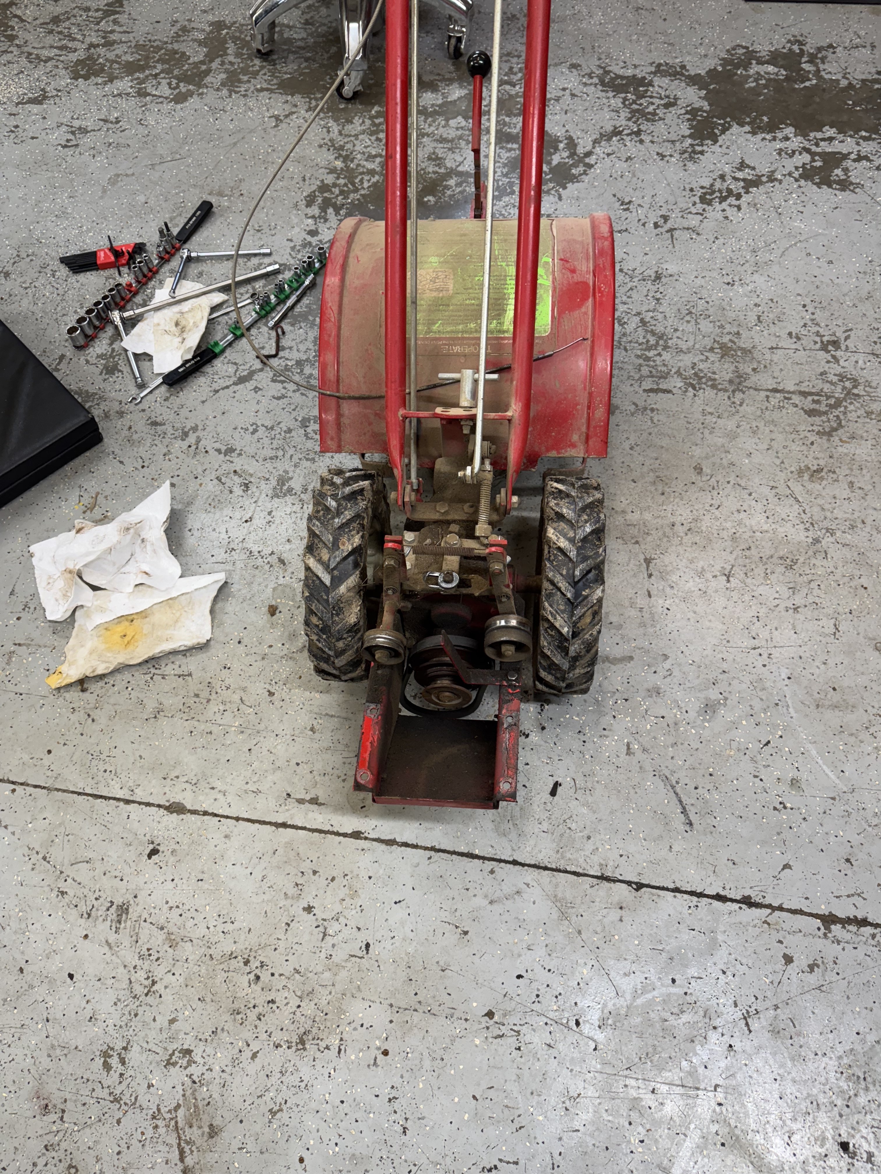

Unless by some miracle it starts on its own in the next couple of days it’s not getting fixed. The tiller will be repowered.
In a perfect vacuum. And the inlet low pressure area created by the inrush of air isn't close to a perfect vacuum. And that fuel lift distance wasn't my idea that came from Briggs. If the 14.7 feet was true in this case they wouldn't need the small well to deposit fuel to be drawn into the intake.
Gosh, You kicked me into reason.
What was I THINKING? NOT!!!
14 .7 is the PRESSURE in pounds exerted by the air column above us (at sea level.
The resulting Column of LIFT available from that pressure is closer to 34 FEET!
My bad! Sorry for the confusion.
Even at idle, an IC engine can produce 20 inches of Hg of vacuum.
That would lift about a foot of gasoline no problem.

I got the old engine off. Waiting for him to show with the new engine.
