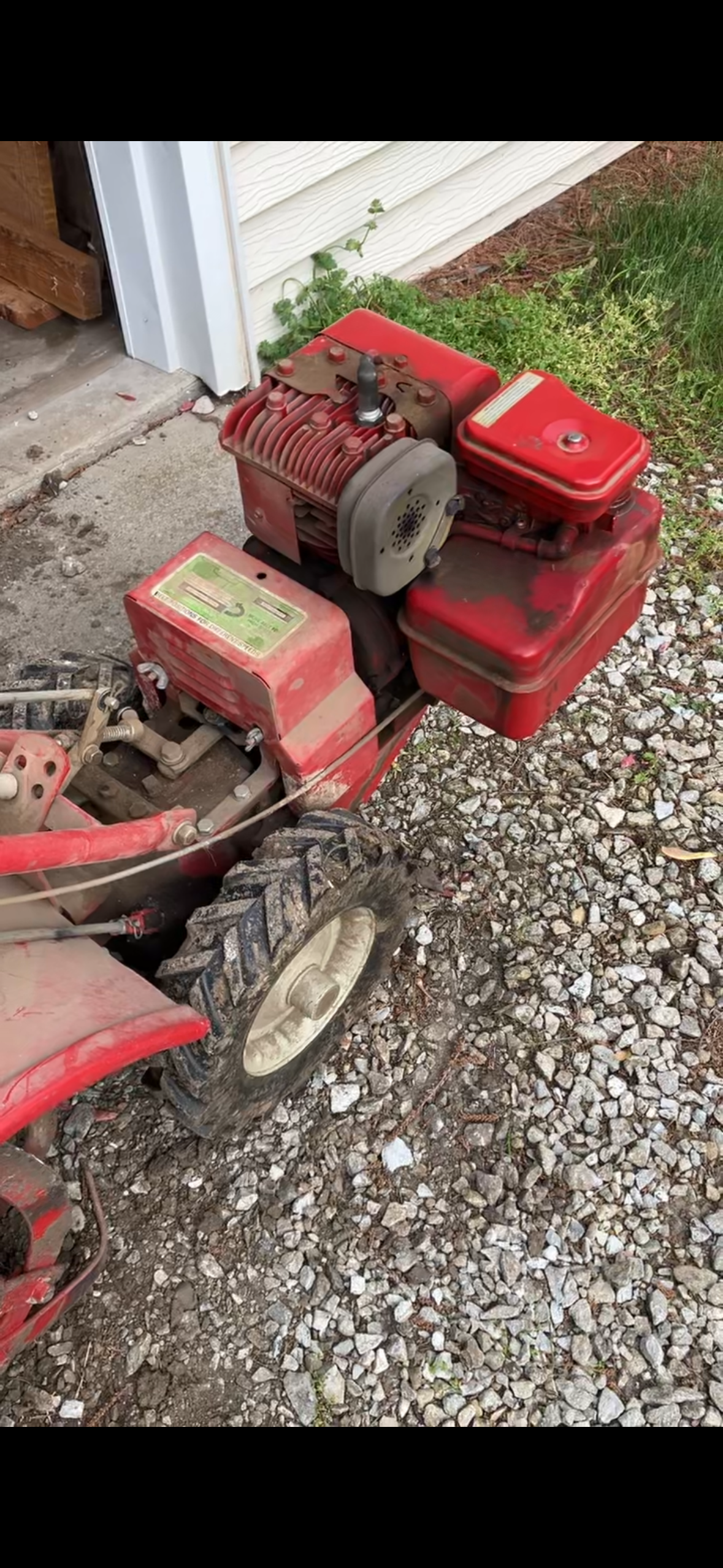

He was looking at a repower but it has two shafts coming out of the engine. I think ones for reverse, it’s a pretty unique engine setup that a repower probably wouldn’t work without a lot of fabrication.
/ Small engine with points? #16
I would like to see a picture. Have not seen that on a tiller before.
#17
Here is a picture of it. The larger pulley on the right part of the engine case is part of the reverse setup. I’m not sure but I don’t think it’s a powered shaft but it does go into the engine. The main drive shaft has two pulleys and the belt can be swapped for slightly higher or lower ground speed.
/ Small engine with points? #18
That's an old one. I had a Horse with a similar setup, but don't remember much about it. I do recall swapping the engine for a 5HP Tecumseh which my father had lying around.
/ Small engine with points? #19
I suspect, but can't totally assure that Troy Bilt used commonly available engines with the same bolt patterns so they could offer engine options using the same mounting and accessory bolt patterns. It's possible that the reverse pulley would fit in the accessory mounting bolt hole on the HF predator, but I don't know for sure.
Also, Surplus Center currently has some new Kohler engines that might bolt up.
