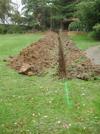

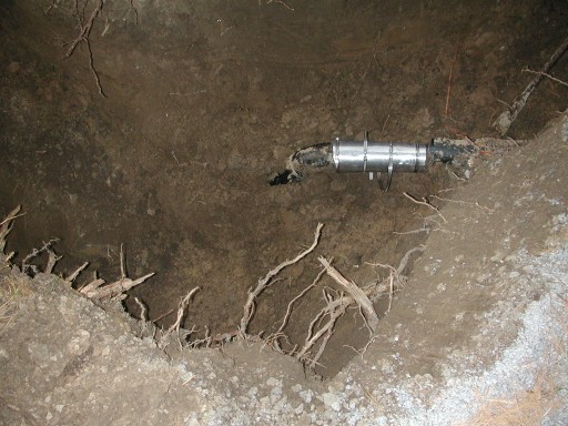

The new sewer is something the township put in last fall and is about ready for us to be told to hook in to. No option.
The old line went to the septic tank...it will be history soon. I will cut off the old pipe and swing it over to the new pipe going about 250' down the slope to the point where I tie into the public sewer...
Nothing was wrong with the old line until I poked a hole in it with the backhoe... (or maybe a rock I did not see did it...) Yea, that's it! A rock did it! It wasn't me at all... /forums/images/graemlins/grin.gif

You're right!! It's the rocks. I had the same problem a couple times in the past. /forums/images/graemlins/crazy.gif
You're much neater than I am. I re-checked the pic of the trench and particularly, the fix. It appears you've removed EVERY rock. /forums/images/graemlins/grin.gif

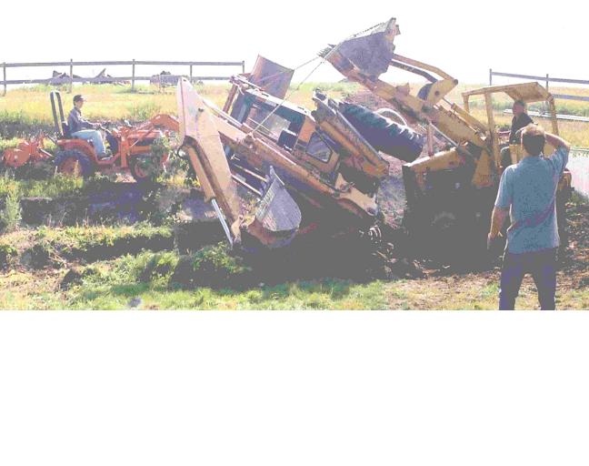

Here is an example of how NOT to move a backhoe. The operator was fine but mad at himself. Apparently this was the first incident in 30+ years of operation.
Back to the subject... it took two days of digging to trench from the house up this 23 degree slope to just behind the photo position. Lots of clay and shale boulders.

And in case you're wondering, this is what it took to upright the backhoe. Naturally during the uprighting process the back tire under the backhoe popped off the rim.
The bulldozer couldn't do it alone so Kubota to the rescue!
