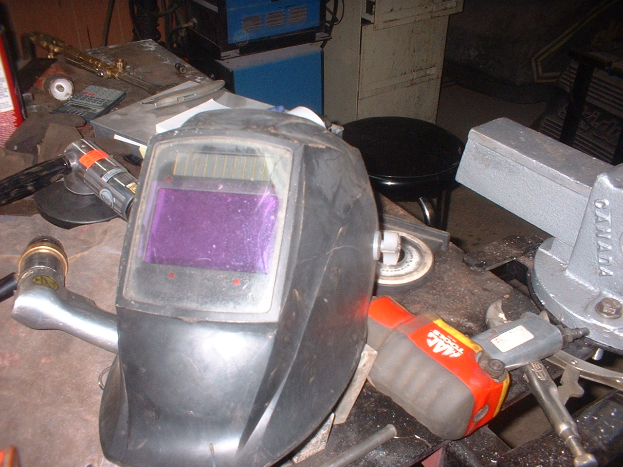

It was a correct assumption that I only stick weld. If the arc does give a little more time in that case, I feel a little better. I have neither the need nor the funds to venture into TIG so it's all good for now.
My Northern Tool helmet also has Hi-Low sensitivity, delay and darkness settings. It has no batteries as it runs on solar panels. It is so sensitive that when I pick my head up from the the work a 20w compact fluorescent light bulb 7' above me makes the helmet go dark.
