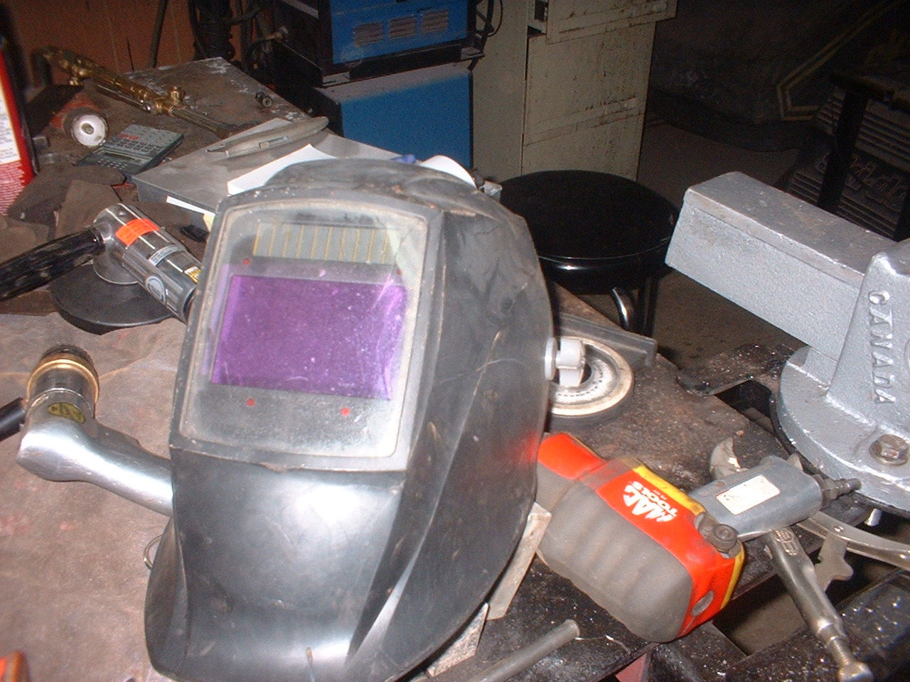

David from jax
Heres my helmet. Its a Miller Big Window Elite. I had it a couple years now.Its been very good. I like the large viewing area. You'll notice it lacks the Orange County Choppers Approved graphics:rolleyes:
