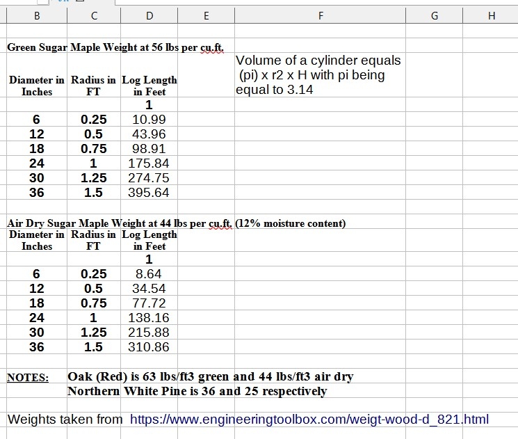

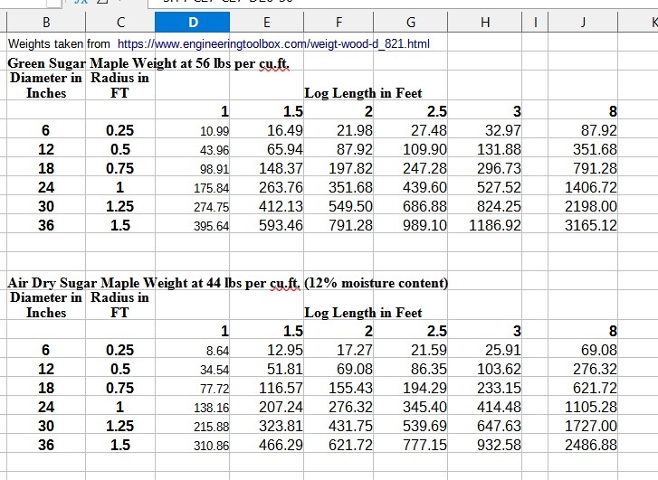

For anyone interested just out of curiosity about how much a given log weighs I would refer you to this website - Wood Species - Moisture Content and Weight Several years ago I put a spreadsheet together when I was curios as to why I couldn't manhandle 16 inch long piece of an old sugar maple I had cut down. It was about 50"'s in diameter. Once I saw the results I got out my sledge hammer and wedges so I could make the pieces small enough to get them to my vertical splitter. Nothing like good old exercise and fresh air on the side of a Vermont mountain in the frosty days of November. That wood kept me warm more than once. 😊I have attached a couple of screen shots of my spread sheet. Any questions feel free to message me however. Oh, by the way I now have a winch on the back of my tractor and have pulled out a good many logs. Bought it 2nd hand since I have been retired for over 17 years. Now wood I used to manhandle when I was young I now have to try to work smart even if this old brain doesn't want to.

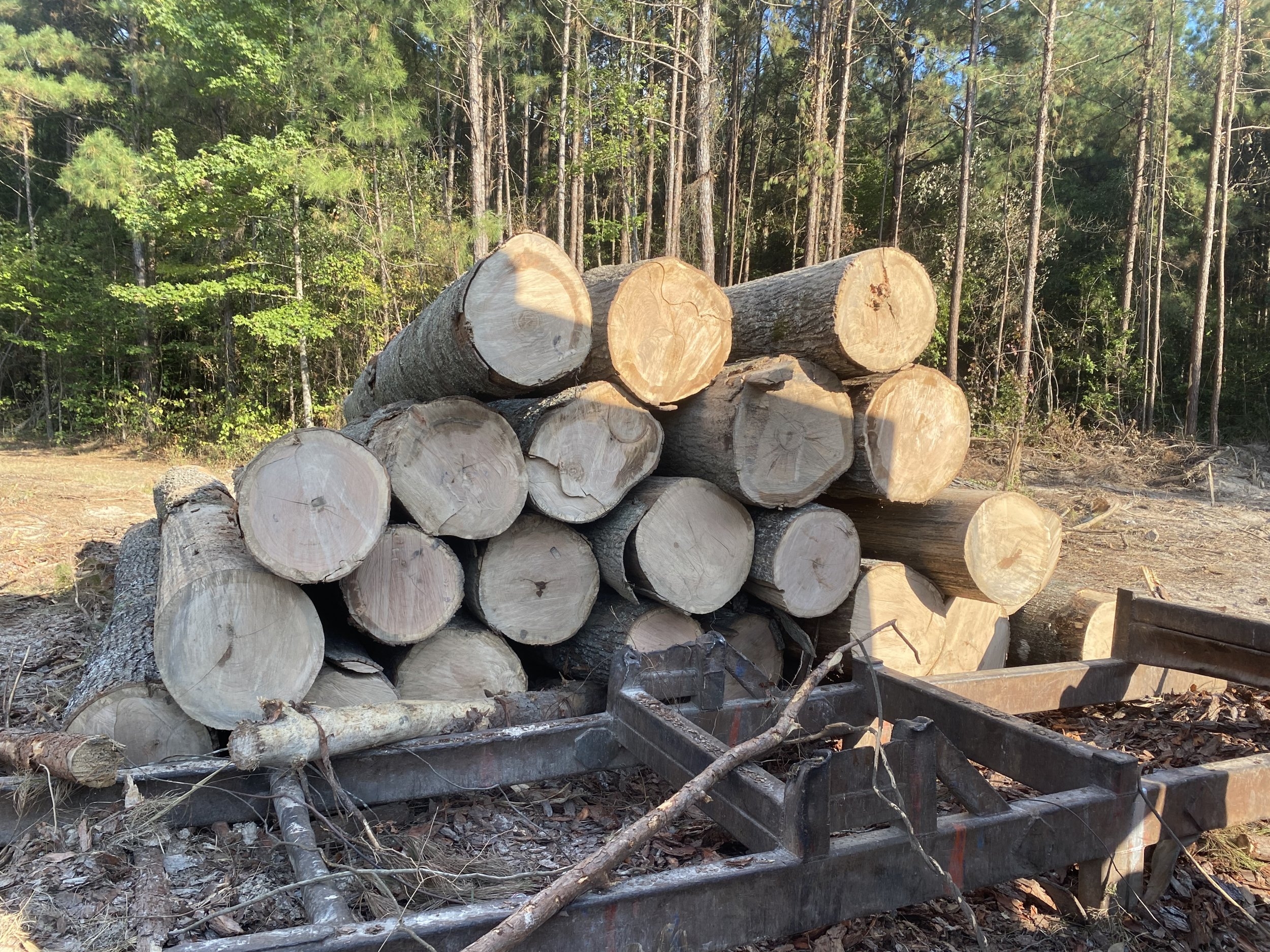

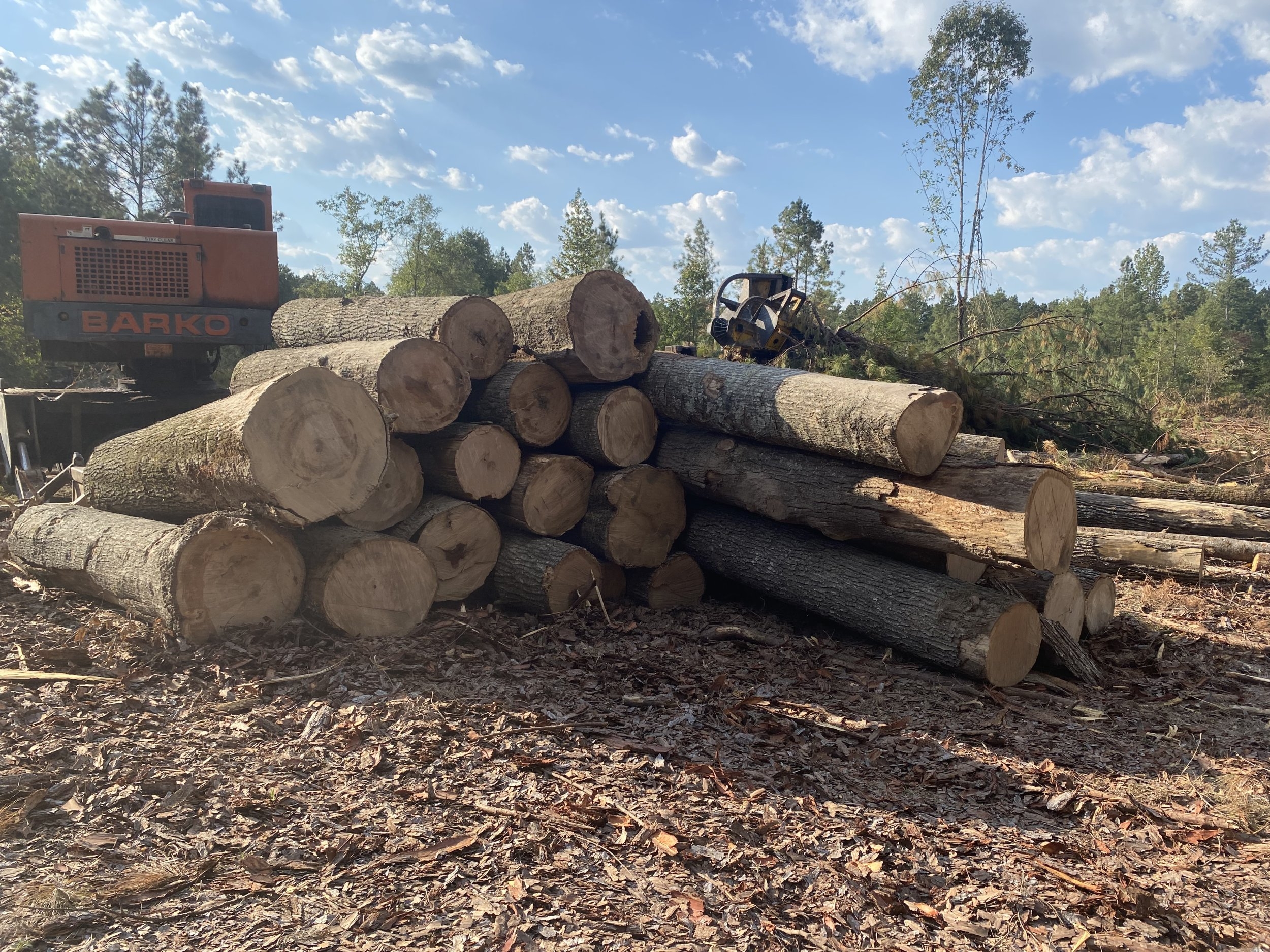

We went out today and got quite a few. We ended up with 17 logs 9’6” and 7 logs 19’. Putting a short log in the forks or grapple and skidding another worked well. We just hooked the long tongs to the top hook on the quick hitch. The jd quick hitch top hook is welded on, the kubota quick hitch is adjustable and ended up breaking the bolts that hold in the top hook and bent that part of the attachment so that will have to be replaced with thicker metal.
We hauled all the logs out to a road and loaded onto a gooseneck trailer then drove down the road where we are having some pice cut and set them off with the loader. We will have them hauled off to the mill Monday. Looking forward to seeing how much it weighs. The largest log was 38” at the butt end.
