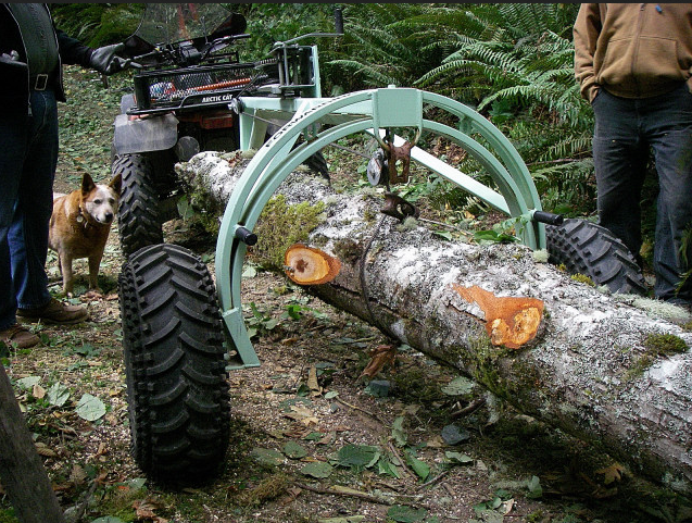

I think that for those who are not willing or want to drop coin on fancy smancy forestry winch setup. A 3 point logging tong setup is cheap and easy, together with a possible solution like this with a heavy set of wheels and an arch like construction was on my mind. But my fabrication skills are not up to this level quite yet.
/ skidding logs #89
Might be time to push the envelope, fabrication wise....
