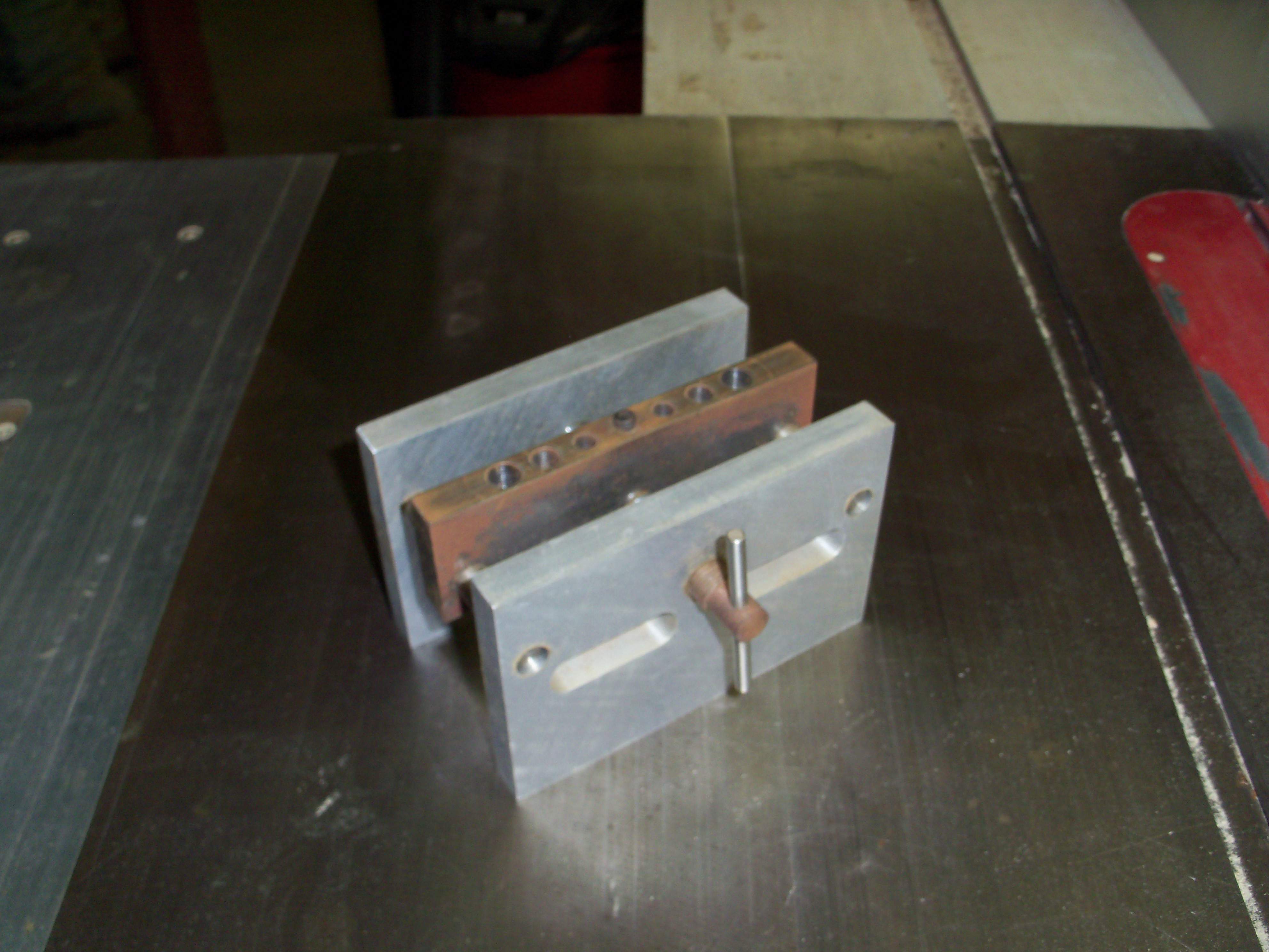

Thought ya'll would enjoy this. Pops came up with his back in 1999, been using ever since. Perfect for lining up round stock of wood, metal, etc for placing a straight hole or pass thru to the other side in alignment 20140827_185921.jpg20140827_185921.jpg20140827_185926.jpg
/ Show What Tool You Made* #303
Is your goal to drill the wood or the steel rod?
/ Show What Tool You Made* #304
This go round, I was drilling the wood and the rod. The "Roller" is for a weaving loom. We found that using a 3/8 rod pressed in 4" on each end and pin with a 1/8 roll pin provided the best results. the metal "axil" will mount into the loom allowing free roll of the roller.
