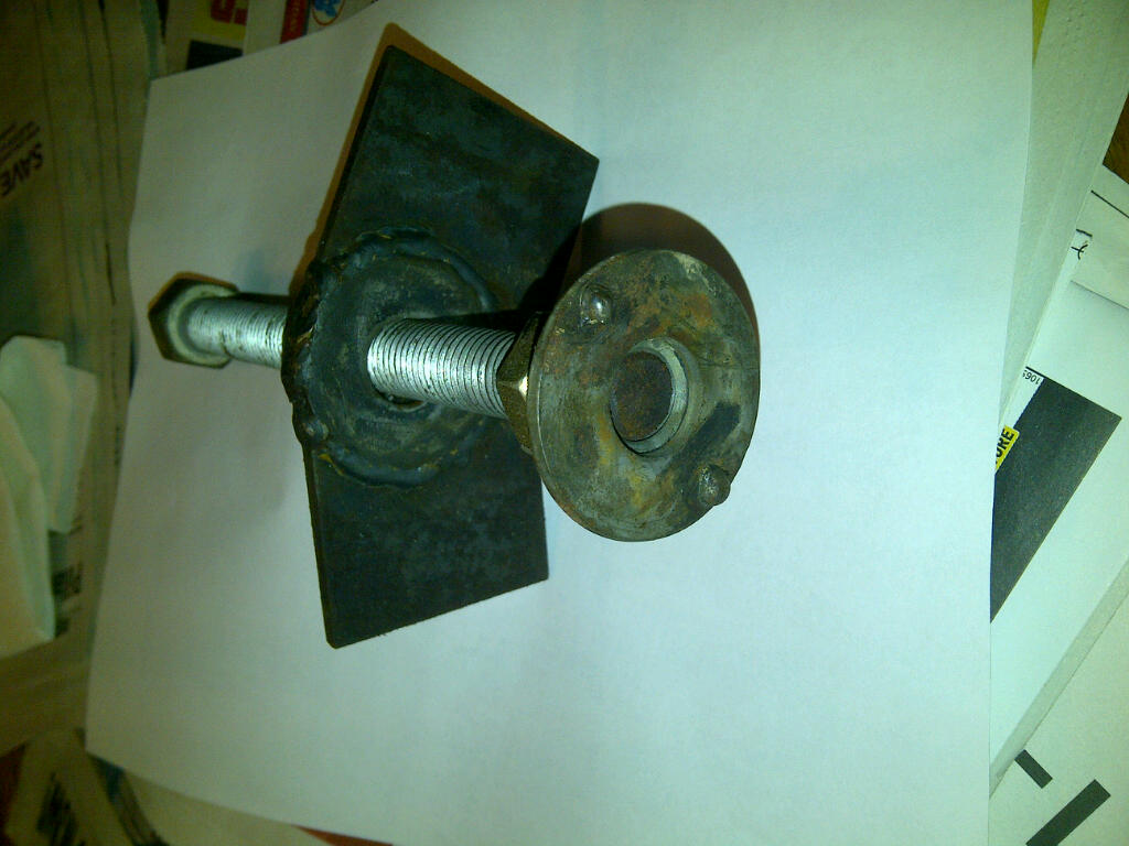

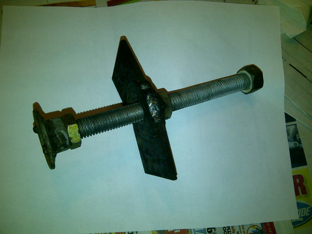

I build this tool some years ago, i call it the "axle saver"
I used it to crimp the threaded end of a stub shaft on a floating rear axle from a dodge 3500 back to round so the nut would fit again.
The nut had worked loose and the wheel and drive shaft where about to exit the axle and had buggered up the threaded end.
Only other alternative would've been a new axle.

An OTC 7402 outside thread chaser would have save you some time and will work on OD's from 1 1/4-5" with more than a dozen thread pitches.
I did have a shaft that lost too much off the major diameter of the thread once and built a nut much like yours out of a split set collar, so it was a locking nut, for the axle on an 8n.

A tread chaser would've been no good.
The threaded end was a 1/4 out of round and was split on the keeper key way.
With my tool i could squeeze it back to perfect.

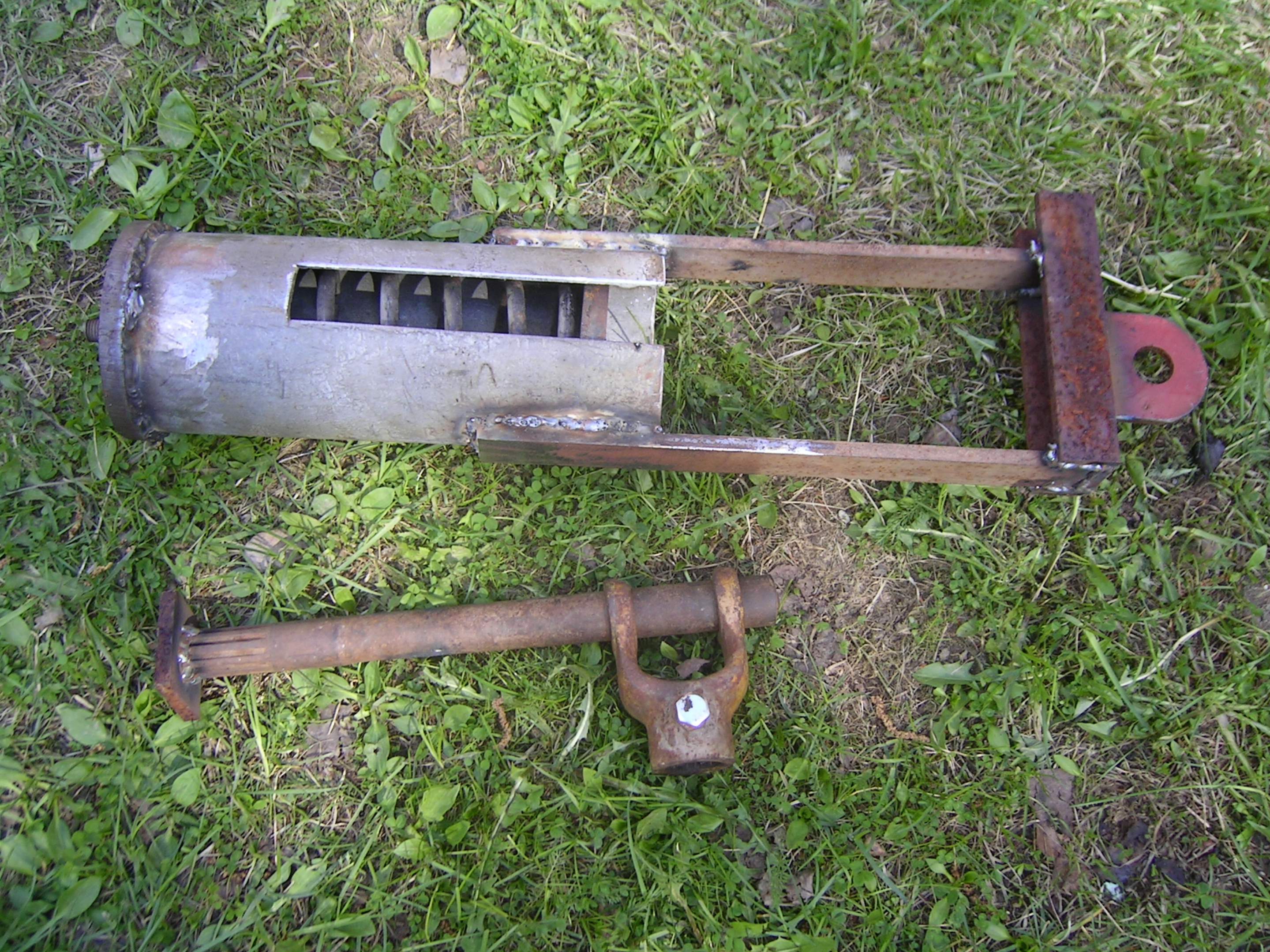

Got my interest ... could you post how it works? thanks
I think this is a great tool so I try to help out.
The link with the pin is barely visable in the tool. You use the link to connect the two ends of your ice chains. With the two chain ends in the link you drive in the pin in against the tire to capture and connect the chain end links. The hard part is getting the pin backed out when you want to remove the chains. Tor Arne's tool is an anvil and a driver solidly connected together so you don't need three hands to hold hammer, pin driver, and an anvil all while you're trying to drive from the tire side out.
