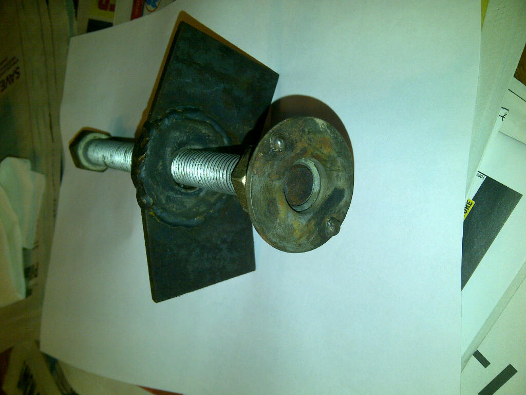

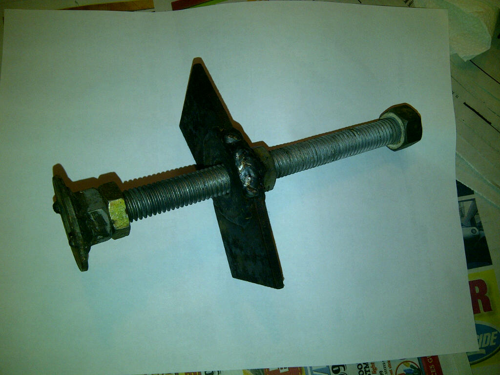

I made this doing the brakes on the other son's jetta:
Was doing rear wheel bearings & brakes on my Son's Jetta. Rear calipers are a stupid screw-in design rather than the normal push in style. Mechanic buddy of mine lent me his snap-on set doing the first side but had to give it back before I got to the second after fighting with the bearing for a week. Dug thru the "too good or too many to throw out" bins and made this in about 15 min which is about the same amount of time it would have taken to drive to his house and back.
Did the job and actually worked about as poorly and the snap-on one did. As a bonus, the head is removable to compress regular calipers if I want rather than using a big C clamp.
