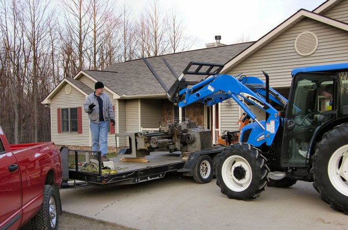

Well we got the lathe home yesterday. The guy I bought it from loaded it on the trailer using a tow-motor so there was no problem there. However once we got it to my place I wasn't able to get it off the trailer. /forums/images/graemlins/blush.gif Turns out the weight is 3800 pounds which is more than the lift capacity of our TC40D. Borrowed my neighbors TN70D and the loader has enough guts to easily lift the lathe unfortunately even with the biggest box-blade loaded down with my weight bar on the back the rear wheels come up off the ground when making the lift. (big pucker factor) We are going to mount his BH today and give it another try. This South Bend is a monster, see picture.

What the he** are you going to make with that thing, airplane parts?
That is one big lathe my friend, you are a lucky man!
   / Should I Use A Rotary Or Static Phase Converter?? #19
looks a little short for turning his own custom post hole augers from solid stock...

Kenny I have been watching eBay for months trying to find a nice Sears or Logan lathe. Those would have been much easier to move (less weight).
But then I ran into a seller that had acquired 4 of these identical South Bend lathes from a high school in the Cleveland area. He made a BIG mistake of listing 3 on the very same day, all starting at $0.99 and with no reserve. his auctions I figured what the heck they most likely were not abused, and had regular maintenance. The lathe is solid, all the controls function smoothly, and there is no slop or backlash in the mechanisms. The guy even threw in a 12" 3 jaw chuck, a 12" 4 jaw chuck, chuck wrench, left, right, and center tool-post holders, and a big faceplate. How could I say no to a deal like that?
A little clean up, maybe a bit of touch up here and there and it should look factory new again. Check out the South Bend web site to see what a 17" lathe is going for new and you'll know the true meaning of sticker shock. /forums/images/graemlins/blush.gif
The good price got my testosterone to flowing and good reasoning flew out the window. Mass rules anyway when it comes to lathes. /forums/images/graemlins/grin.gif Anyone need any magnesium wheel hubs made for a 747 Jet?
