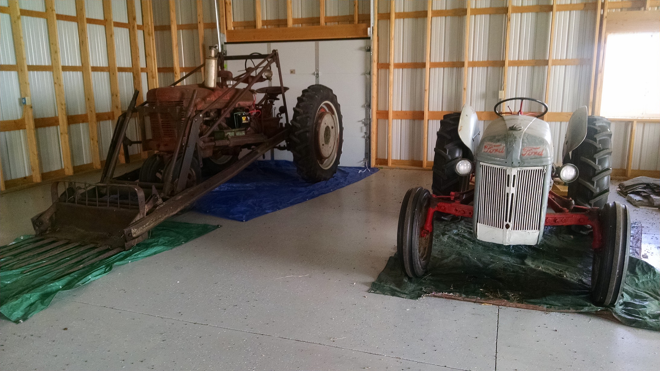

Hi everyone-
This is probably a question with no right answer but I've been kicking it around for months. I would really appreciate some input...
We moved into our acreage (about 5.5 acres) in Nebraska about 5 years ago. Back then I actually asked for some advice on what I should purchase (used/new/size) that sort of thing. Even though I was considering a new sub compact (wanted something that could mow the yard and do other acreage chores) it was never really an option due to all of the other costs associated with the new house. Anyway after getting the yard installed, I ended up buying a cub cadet riding mower just for mowing the yard and an 8N for snow removal/5 ft shredder for area outside the yard. After getting some fuel tank issues sorted out on the 8N and replacing maintenance items I've have great luck with it. I doesn't work very well moving snow (about 200 ft driveway) with the rear blade but we haven't had much snow since we've moved in (we are due though...). Also I have seemed to start mowing more and more of my brome grass outside of my yard with the Cub Cadet because it's just easier than using the shredder/8n and it looks nicer. Now I've also acquired a Super H that was my Great Uncle's tractor. None of the heirs wanted it and they didn't think it would sell at auction so I got it for nothing. Installed a new battery, changed the oil, and it started right up with the hydraulics seeming to work fine on the loader. A friend at work says he has a better loader and a bucket for this tractor he is just going to give me for some beer. So my plan is to use this tractor for moving snow. I've included a picture of both the tractors just for reference...
Here's my question-Should I again consider buying a new tractor? It seems like the Ag econ is driving prices down and financing terms are up (but my memory from 5 years ago may be off). I haven't test drove anything and I've never been one to bother salesman unless actually really wanting to buy something. It would still be used for shredding brome and moving snow from the loader (if I'm at home and we do get snow someday staying home is not an option with my job). Latter on I would maybe get a belly mower (I've be mowing more and more brome with my cub cadet due to ease of use/looks over 8n with shredder and have to believe a belly mower on a CUT would be better made for this) and a rear bucket (guy at works says best thing ever for moving snow). So I don't need anything to mow the yard, I have the storage room, not many obstacles, and guys at work say if you actually want to use loader the smaller SCUTs aren't that safe or useful. So just started looking at Kubota and I am thinking start with the L4701 or MX4800/5200. The thing I'm struggling with does it even make sense to buy this big of tractor in my situation? I see what guys on the forum are doing with their tractors and I just don't have those kind of chores on my land. On the other hand I would hope to have the tractor for the next 30+ years and do I really want to keep fighting the limitation of 2 60+year old tractors and still end up probably buying something like a 3020/4020/Ford 4000 (which aren't exactly cheep) in the next couple years? While I'm at a place now where I can afford a new tractor (and financing makes it even easier) I don't want to throw $25,000+ on something that is complete overkill for my needs. But I don't want to buy small (as everyone always says), a lot things can pop up in 30+ years, so I don't think I want to consider going smaller (especially since I don't think I will save a huge amount of money going smaller). So it will probably be buy something new that is overkill now and may always be overkill or just stick with what I have and like I said by something late model when it comes along. Also worth mentioning I don't have any mechanical experience and while I have old tractors I don't really have the knowledge to keep them going if major issues occur. So the new warranty really appeals to me over buying late model. While I've enjoyed working on my 8N it would be a lot more fun if it was a hobby/learn at my own pace and not I absolutely have to get this thing going to shred before the birthday party tomorrow :).
On a side note I am keeping my 2 old tractors due to their attachment to relatives and I don't have hardly any money in them at this point. So that really doesn't affect my decision.
Thanks so much for your thoughts!

Hi my primary uses will be shredding (I have a 5 ft shredder), moving snow (about 300 ft of crushed concrete between 2 driveways), doing driveway maintenance (though it seems like crushed concrete stays put pretty well), my major landscaping is done around house and building (so would just be if I want to create a brand new area someday), wife wants to open up small garden area each year, and using loader to move our large dumpster and unload things out of the back of my pickup. Anytime I open up the native grass I always end up with erosion damage it would be nice to fix with a loader. I would think other things would pop up. But I wont have any livestock, crop work, or logging (only one existing tree on acreage when we moved in) which I see a lot of people asking specific questions about.
My current acreage is 5.5 acres and I don't plan to move or expand. But if I did have to move I would probably try to move up in land area.
I would answer you 3rd question by saying I would like to stay around $25000 with the loader but if there's a deal and I can finance I would go up higher. I guess the main thing that has my attention is it seems like the prices are actually lower now than they were when I originally looked at SCUTs 5 years ago. I also seen 2-3 year old used tractors going for about the same to slightly higher than a brand new tractor. Maybe this is due to lack of pollution controls on older models or maybe I'm all wet. If prices a historically good now I'll finance. If I'm wrong and prices are just what they've always been I think I'll just plan on saving money for a year or 2.

I don't know. For five acres and a short driveway it sounds like you're over-equipped now. Keep the 8N for gardening and snow removal and get a ZTR. Turn the rest into lawn. You can mow 5 acres in just over an hour with a good ZTR in the $5k range. Spend the rest of your Saturday morning tending the garden.

I have photos of my father-in-law moving snow with a bucket like that on his Farmall in the 1940's. It worked, but it was slow, tedious work. The guys at work who say the loaders on the smaller SCUTs aren't that safe or useful, are simply full of beans. You can find hundreds or thousands of CUT and SubCUT owners here on TBN who safely do real work - including snow removal - with their little tractors. You can even watch it happen on YouTube or whatever. Actually, loader operation on that old Farmall, with its crash box transmission and high center of gravity, would be both slower and more sporting.
But you really need to get some seat time on a modern CUT or SCUT to form your own impressions.
