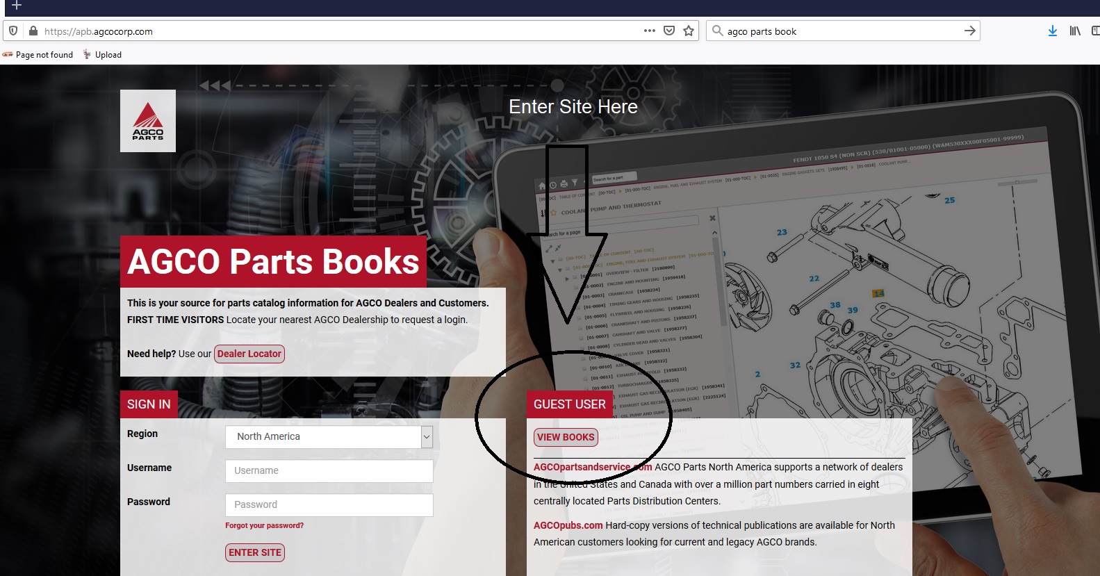

Am I able to download a owners manual for the 1723e? I looked around their website but no luck.
Looks like the accessory socket is $30 in parts.
Not a manual, but just as important.
Welcome to AGCO Parts Books

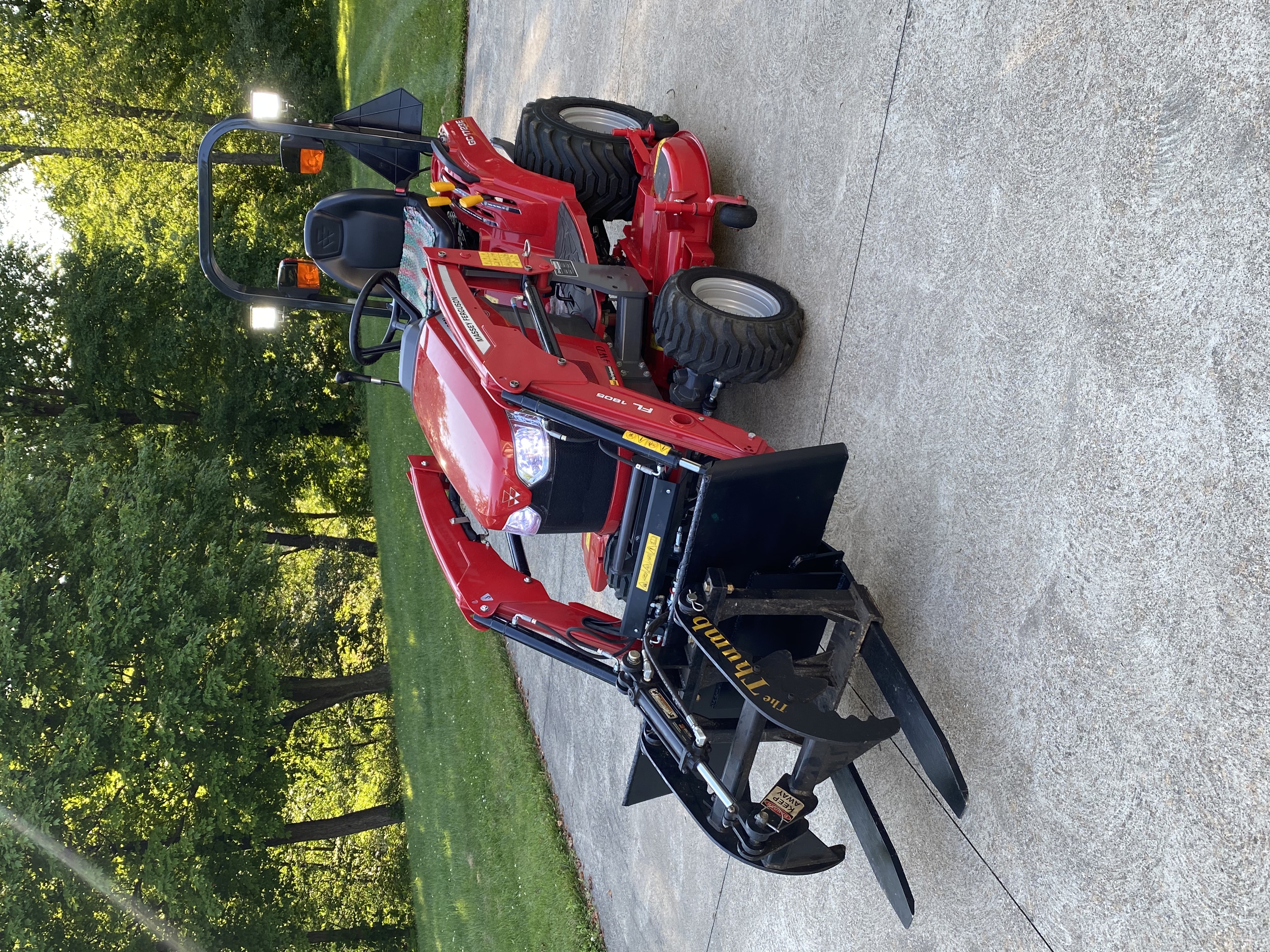

Putting the lights on the inside is a good idea. As far as adding the power socket - is it prewired plug n play?
When I moved my turn signals to the inside I made two small brackets and mounted them over the old lighting holes using existing hardware. I added LED lights to the outside of the rops and boy are they bright. $17 for a pair off of eBay so not worried if I break or damage them being on the outside of the rops. I hooked up to the existing wiring as well. I replaced all the bulbs on my tractor with LED bulbs so I am hardly using any amps for the lighting.
On the back of the tractor is a wiring harness with 2 hot/ live leads in it connected to a 15 amp fuse. I used only one lead from it to connect to a lighter/power socket in the little storage bin. I got the lighter socket off of eBay as well I think for $1.50 with free shipping. I also drilled a hole and connected a light switch in there next to the socket so I can turn on and off additional rear LED lighting. Works great for what I need. These are both fed off that 15 amp fuses wire. I am not worried about over loading any fuses since LEDs use probably use 1/10 the amps a regular incandescent bulb uses.
