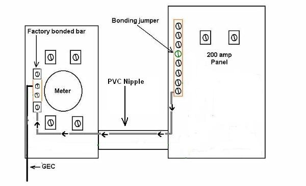

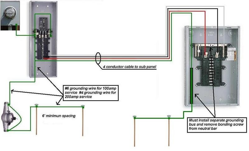

Is this going to be a main panel with it's own meter or a sub panel fed from a main panel? The grounding is different. The GFI is the same. Individual plug in service boxes grounding is the same.
   / Shop electrical wiring....
#15
My shop will have its own meter. So im speaking of the meter and remote service panel that is next to the meter.
   / Shop electrical wiring.... #16
You are correct, that the ground from the rods and breaker panel are connected in the meter box. The ground has to be run from the meter service entrance box uninterrupted to the grounding rods.

#17
looking at these diagrams...which is the correct way to attach the ufer? I assume it does matter
