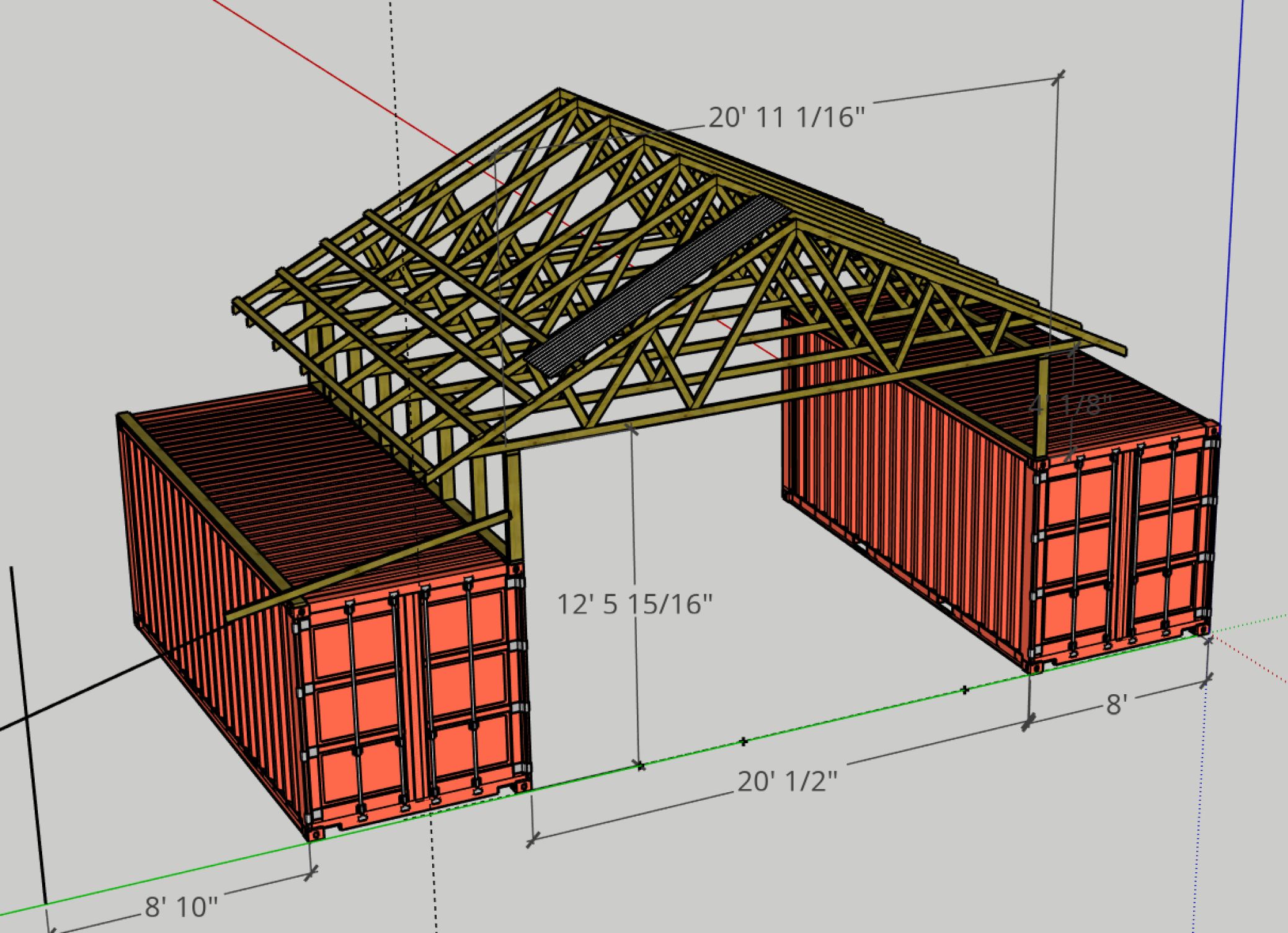

I've been planning something similar to the OP. We are in the process of splitting up some family land co-owned by my cousins and my dad. Dad and I currently have a couple of 20' containers near the existing tractor barn on land that will eventually go to one of the cousins. Dad has 50 acres he separately owns that adjoins one part of the property and we are going to move the containers there.  I've been playing with arrangements to put a shed over the containers to store a tractor and dozer. I was thinking I would just use the 20s but have decided to go ahead and buy a 40' high bay container and put the two 20s end to end and the 40' spaced 30' foot away to create a 1200ft^2 barn. It will look something like the sketch below but with different dimensions. Each end will sit on 1.5' x 8' x 6" slab poured with two 36" deep piers. Taking note up thread, I will put in some weld plates into the slab to weld down the containers and using translucent panel for light. I'm planning on 4 or 5' tall pony walls to get at least 12' clearance under the joists to allow for indoor storage of a travel trailer.
That is a much better drawing than my crappy sketch! I’m going to save that one.
What is your plan for attaching the pony walls to the containers?
I am worried about bracing it against side loads wanting to rack the whole roof structure. I am thinking about using structural steel so that the bracing doesn’t intrude into the open area of the barn, or will a lean-to style roof over the containers be enough structure to keep it from wanting to parallelogram?

That is a much better drawing than my crappy sketch! I知 going to save that one.
I am worried about bracing it against side loads wanting to rack the whole roof structure. I am thinking about using structural steel so that the bracing doesn稚 intrude into the open area of the barn, or will a lean-to style roof over the containers be enough structure to keep it from wanting to parallelogram?
Below is a great pic of the roof of a container for reference. I plan on bolting the pony walls down onto the beam that runs from end to end on the roof. This beam is about an inch shorter than the corners and the corrigated portion of the roof. I'll plane down a treated board so the bottom 2x6 of the pony wall sits flush across the corners and roof and use construction adhesive and through bolts.
I'll put some diagonal bracing front to rear on the pony walls and I think that the lean-to will provide side to side strength.
