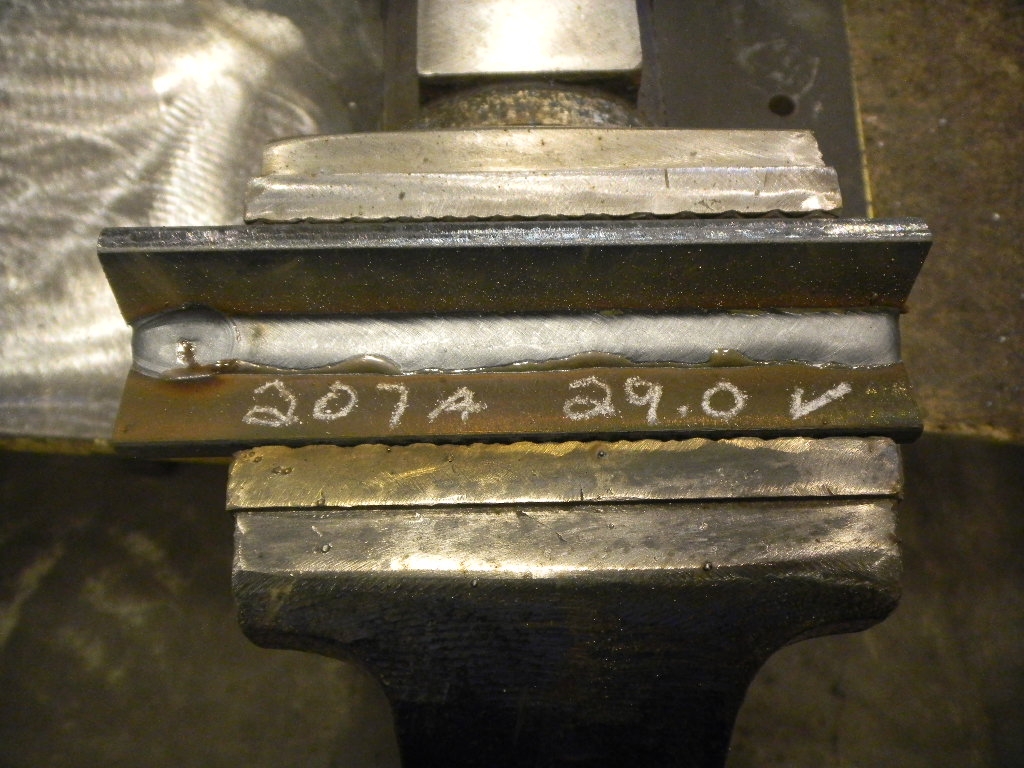

If you really want to turbo charge your welds, go with some C10. Or 98% argon, and 2% oxygen.
This weld was made with C10.

SA- that weld was done on spray transfer?

Hey shield arc I like the spray transfer. I also like to see some character to the bead. When I was in school they taught us less heat and more technique. I personally like the mig welds that take on a Tig welded appearance. Man we could lay some pretty welds with the 3 phase units at work.

Hey Ericher, I run .035 hobart wire. When I was welding everyday for a living most all the factories I worked in used 75/25. I'm running a miller 252 I bought last weekend.
I'm still not convinced of the structural value of that Mig like Tig technique, but it does look:cool:

You forgot to mention the industrial machine needed to even get into spray transfer. From what I recall reading even a 250 class machine (linde and esab exempt) that can get into spray transfer will have such a low duty cycle at that point, that it is almost slower than short circuit mig. So it seems if your serious about spray transfer, you need something like your invertec or a 350 amp+ transformer.

Very true!;) And it is very hard on equipment. The contact tip on my 200-amp Mig gun was soft and wanted to bend after a few beads.:shocked: If I ever do much spray welding I'll have to use my 400-amp gun.

Pulse Trumps Spray any day. You do need about 90% argon to get to spray but remember the old 75/22/3 Argon Co2 with 2-3% O2..You could get close to true spray with a smaller machine ( ESAB 250 ) but you suffer from adding Oxides to your welds. Some still believe in it. Praxair called it Stargon. Old School gas.
