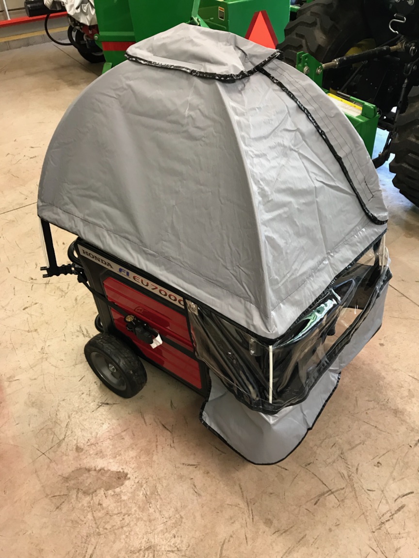

I need some ideas designing and building a weather shelter for my generator. Only to be used when the generator is running, parked just outside my garage door. Usually only need the power when the weather is nasty, blowing and raining. The generator is stored in the garage, but we put it outside to run it to keep fumes out of the house and reduce the noise-it's loud!
Criteria:
1. It should be easy to collapse & put away, not taking up much storage space.
2. Should deaden the noise rather than amplifying it.
3. Should be able to attach it easily to the generator frame so it won't blow away.
4. Should be able to tolerate getting wet.
5. Must provide some ventilation.
6. I need to be able to easily get to the controls and cable socket.
The generator is about 30" high, 28" long and about 20" wide.
I tend to over build things, so I am looking for simple and elegant solutions.
What do you guys do to protect your generators out in the weather?

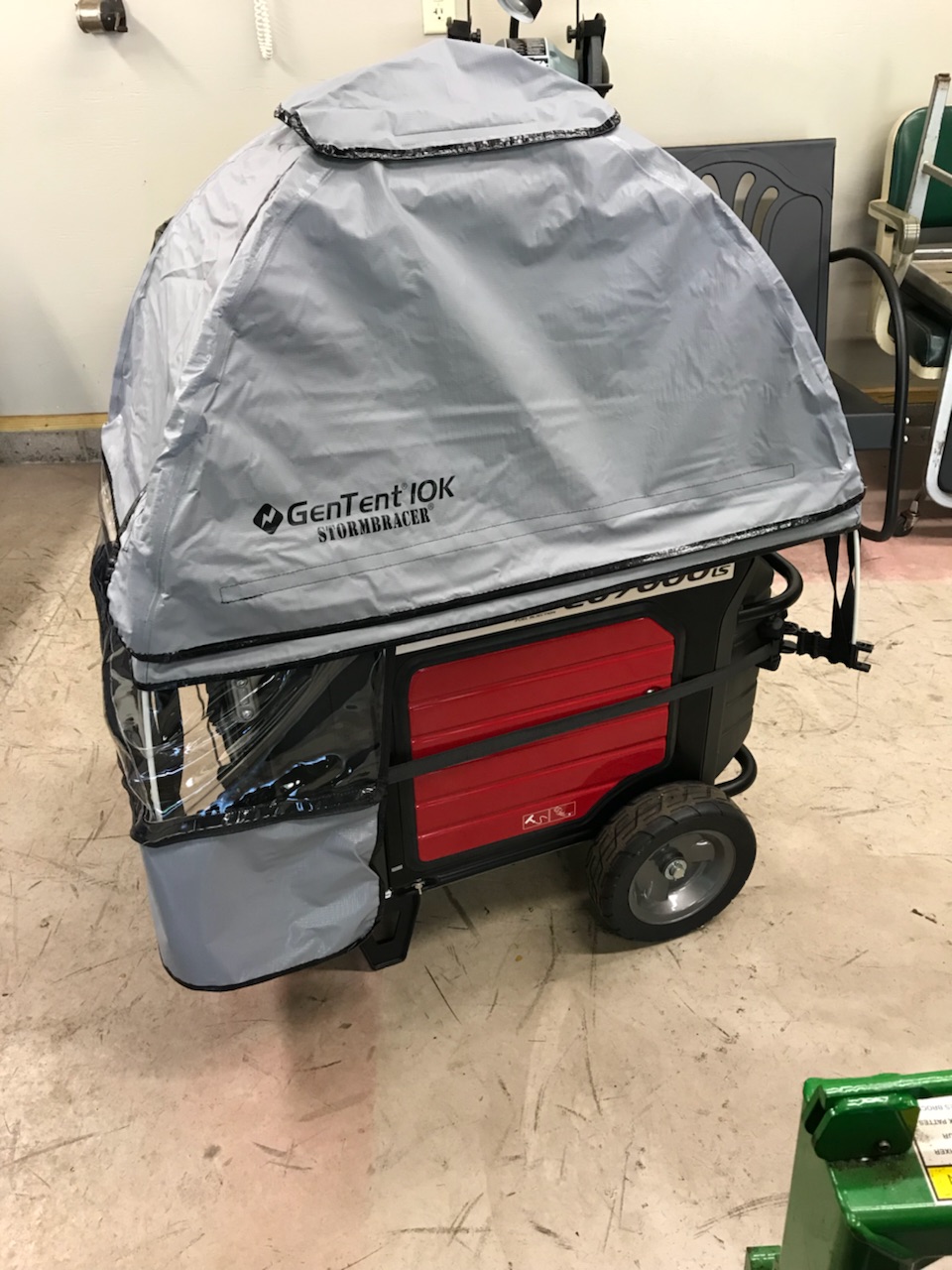

Thanks for the reply. Your idea is a good one but I decided to go with the GenTent because of where my generator will be located during a power outage. It will sit on a concrete sidewalk not far from the house where the larger canopy will be too big and I can't put anchors in the ground. The GenTent canopy works perfectly for my situation because it attaches right to the generator and uses the same footprint as the generator it's attached to. It may not suit everyone but I figured I'd post photos in case anyone is interested.

Does it stay setup like in the pics when the genny is not being used?
   / Shelter for portable generator #20
I could leave it set up like that for storage because it wouldn't take up any more space than it does right now with the Honda generator cover on it, but I took it all off and put it in the storage bag they sent me. Once I initially assembled the whole thing for the first time I was able to leave the ratchet strap and the corner pieces set up like a kit, slip it off and put it in the storage bag, and when I need it again all I have to do is slip it back around the generator and tighten the ratchet strap a few clicks. After that all that's left is to put the four fiberglass rods in place and lower the tent over everything. It's a five minute operation at the most. I think that's one of the best things about this product - it takes up the same footprint as the generator it sits on.
Another reason to take it off during storage is it covers the fold-down handles on the generator so if I want to move the generator I have to remove the cover. Not an issue during use but I do start the generator once in a while and I move it outside when doing so.
