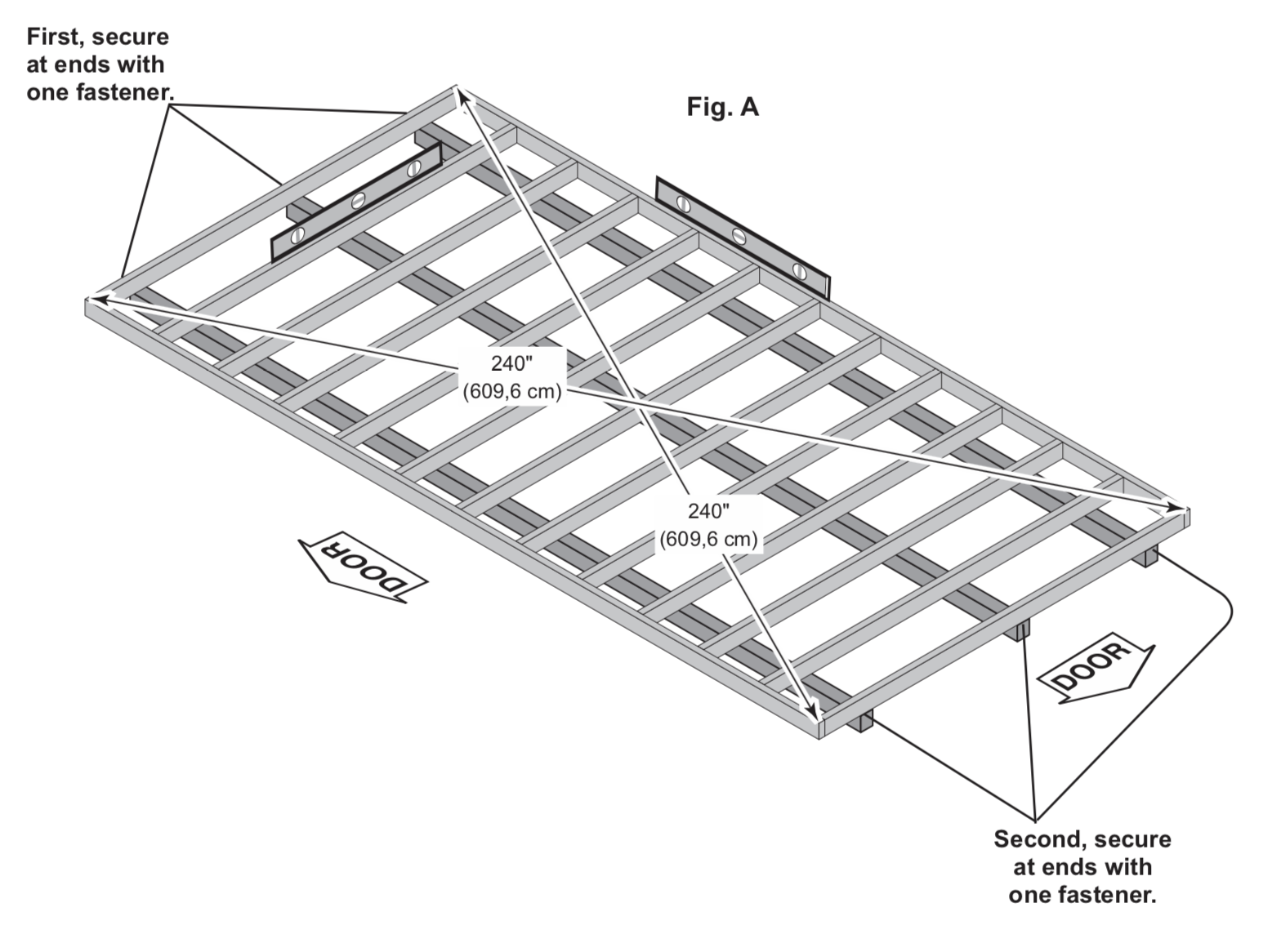

I like this idea. The difference between 16" OC and 12" OC over the span of 16' is 4x 2x4's.
The manager at Backyard Products offered to send down a guy to tear up the floor and rebuild it 12" OC, but I just don't even see how that could work. Even if it did "work", the guys that addressed the issues in the first shed had to beat it apart and made a mess of it. I don't think I want them trying to fix it.
Ultimately, it's the 3x 4x4's that are in contact with the shed pad. The 2x4's just distribute the weight. It seems to me I could put down 3/4" plywood (or something) to accomplish roughly the same thing, but I really don't know.

How wide is this building? From the looks of that drawing it's the 4x4's which actually are supporting the weight. Seeing that I don't believe that the extra 2x4s will make that much of a difference. Negotiate a reasonable (in your favor) refund, or expect an all new shed if they decline.

The difference between 12 and 16" OC would only be 3 or 4 if building fresh. To late for that. The only thing that would work would be to put 1 joist in between every joust so that would be many more, depending on the length.

Yet if you have decent wood running perpendicular to the floor joists they will provide more support than those few extra 2x4s anyways.
Looking at his diagram I believe that he has it covered, depending on the width of the building. If not he still will accomplish more by adding more cross support than the original plan.
