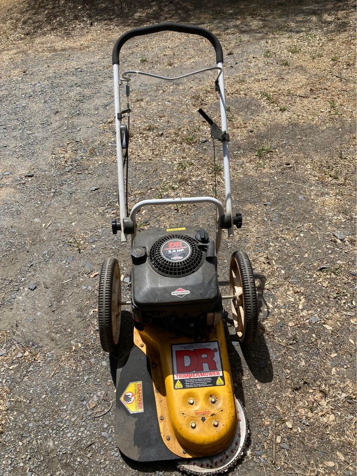

Check out cutting disk on this machine.... It popped up on local yard sale site just today
View attachment 751517y...
I have one, used it a few times, cuts well but how often are there no rocks around the base of a small tree? Seems like every time I used it, it hit something. But it did cut well if you can avoid them.

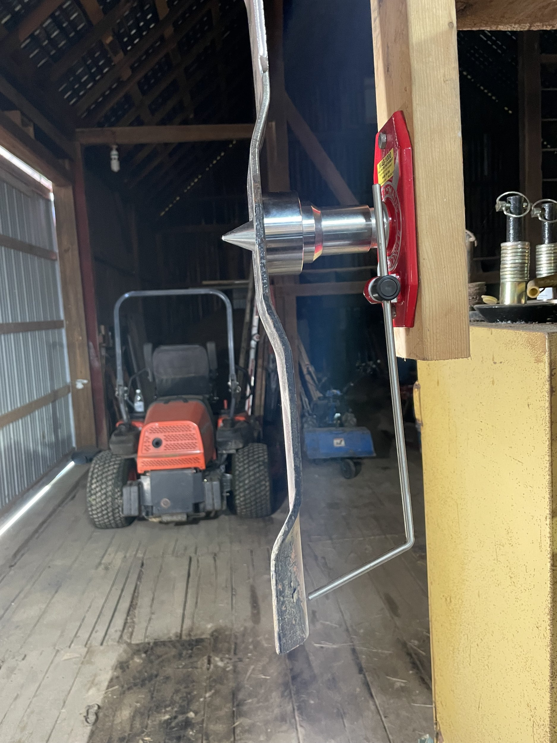

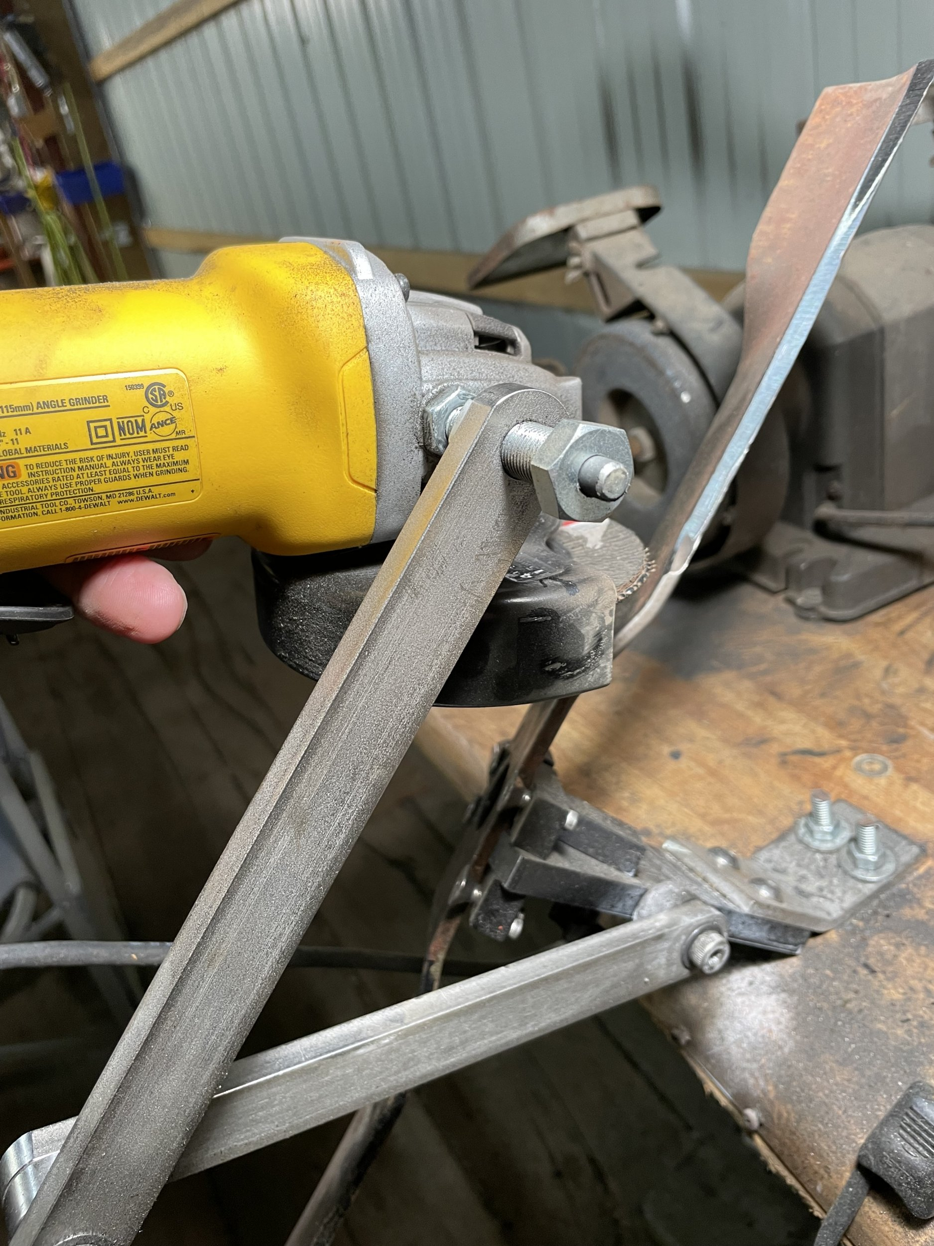

If you are like me you prefer sharp mower blades. I like to sharpen them with each mow. So I cycle three sets of blades for my Ferris zero turn. But it's still a massive $#$&@&$#*% PITA~!!!!!!!!! I got these great grinder disks from PFERD, They are fabulous I got them in 2019 for my large and 4.5" grinders. I've done a lot of sharpening and mill scale removal and the disks I installed back then are still on my grinders. Unlike flap disks, if used correctly (Read Do not lean on them) they last forever and cut steel like butter. Anyway, I got a triton gizmo vice thing to do my grinding outside instead of the dusty shop. BUT STILL, it was a pita. Set the grinder down struggle to get the blade out of the vice flip it clamp it and bend over for the grinder.
Yah, I know modern problems; they built the pyramids with copper chisels and rocks lashed to sticks. Anyway I repurposed a hunk of a pallet to this and it's fast and easy. I did all three sets in like 15 minutes plus balancing Tools I made or purchased - The Axlotal Tank

I use the same setup.. All American blade sharpener guide... perfect 30 degree cutting edge in minutes, and same balancer, for very accurate balancing.
I've always sharpened my own blades, and my 1997 Woods 61" mower decak is still running the original blade spindles. That's 25 years without a spindle failure, and I just replaced the original belts and idler pulley bearings this Spring, only because one idler bearing finally failed, and they were sealed bearings, so no zerks.
Had a friend that did not believe in balancing blades, and had to replace a spindle or 2, every 3 or 4 years on his Husqvarna commercial mower.

200 dollars for a gizsmo that holds your grinder at an angle?
My hands can hold my grinder at an angle just fine and it don't cost me nuthin'
Yup exactly, and that's why I don't have that thing either.

Well, I'm thinking about it. I don't trust myself with a grinder and I would likely just F it up. A new set of blades for my deck run over $100. I have 2 sets now. If I can sharpen both sets several times rather than replace them it would save quite a lot of money in the long run.

I bought one of those too, a "blemished" one so I saved on the cost. I also use an All-American sharpener to get the perfect angle, actually had to file it a little to get the correct angle but it works great now.
