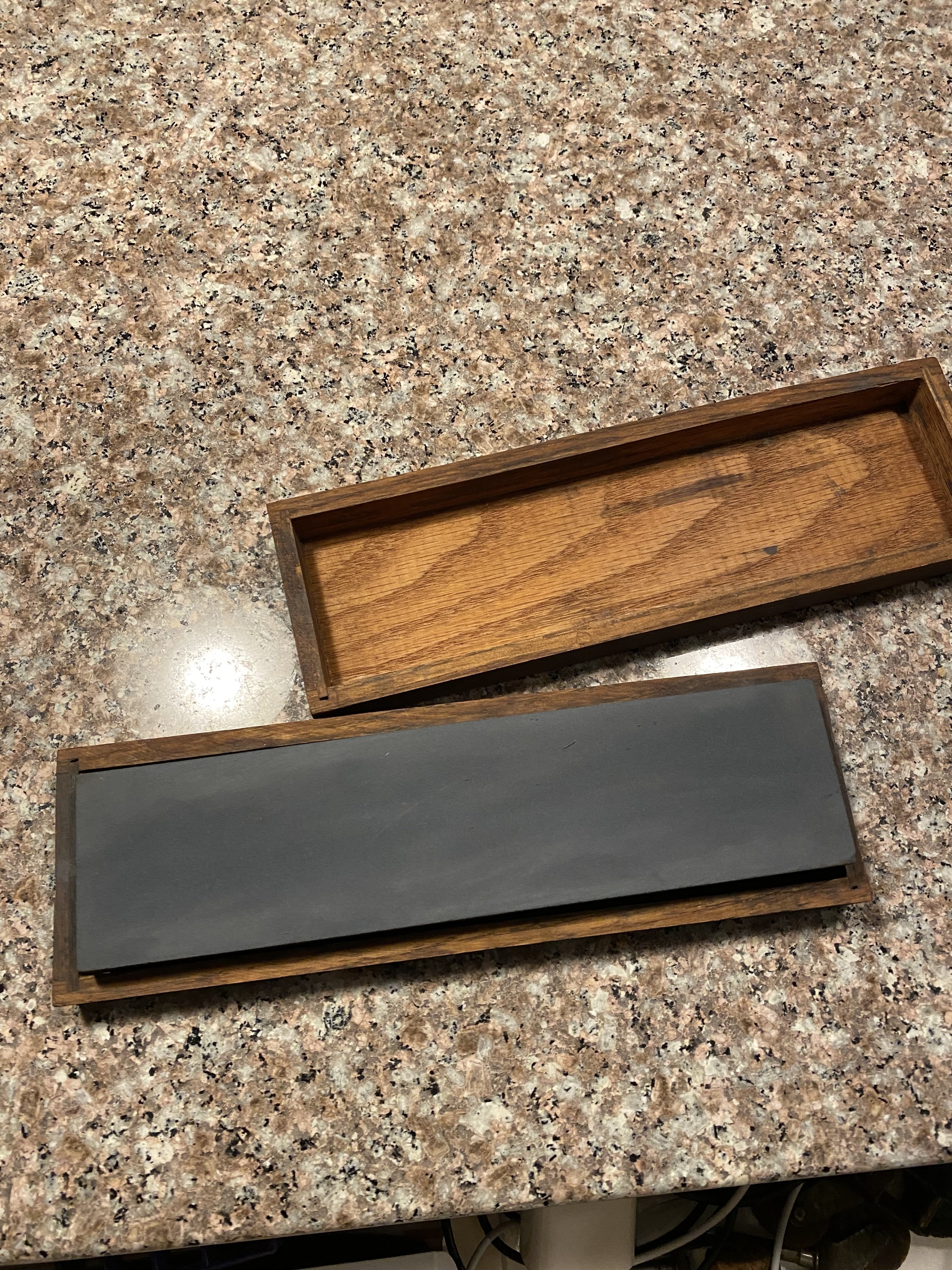

Not sure why the default is to mechanical sharpening. Grinders have a high probability of overheating the edge and possibly effecting temper. Unless your ax is really dull, a good two grit oil stone will sharpen it better than any grinder. If it’s really dull, start with a mid coarseness ******* file to bring the edge down before using the oil stone. If you want a razor edge finish with an Arkansas white stone (only lubricate that with water). Sure, it takes a few minutes, but the results far exceed a grinder with no over heating.

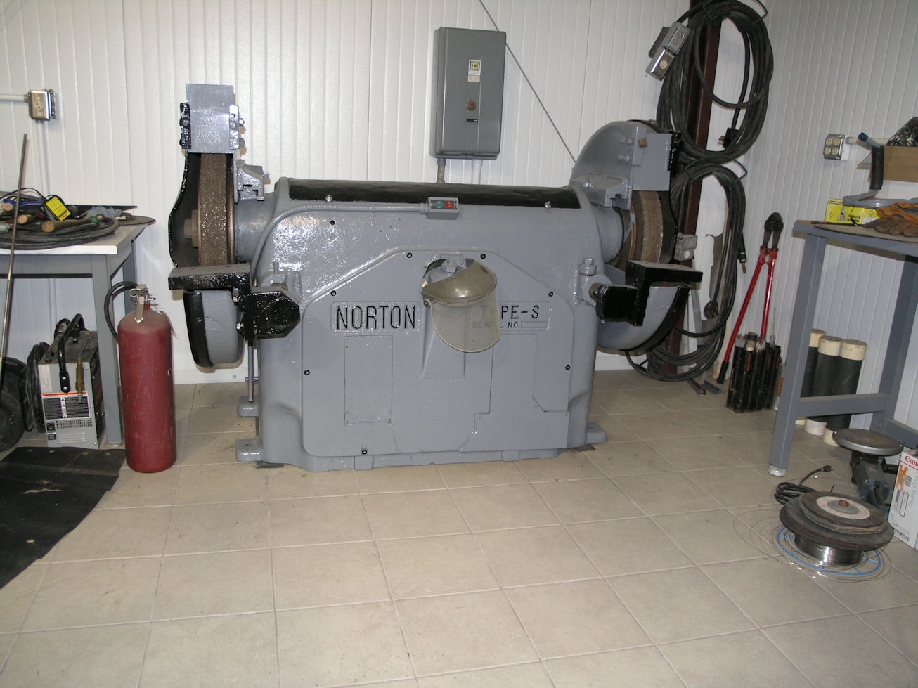

I have this grinder in my shop, two different grits might work on an axe but a knife would likely never be seen again.
All joking aside my dad picked one of those pedal grinders as a yard art piece. I tried it and you don’t really need worry about being out of round since at those speed whatever you are sharpening has time to follow the stone. I use a Work Sharp belt unit and it does a good job. For wood shop chisels I hand finish them on a diamond flat piece.
