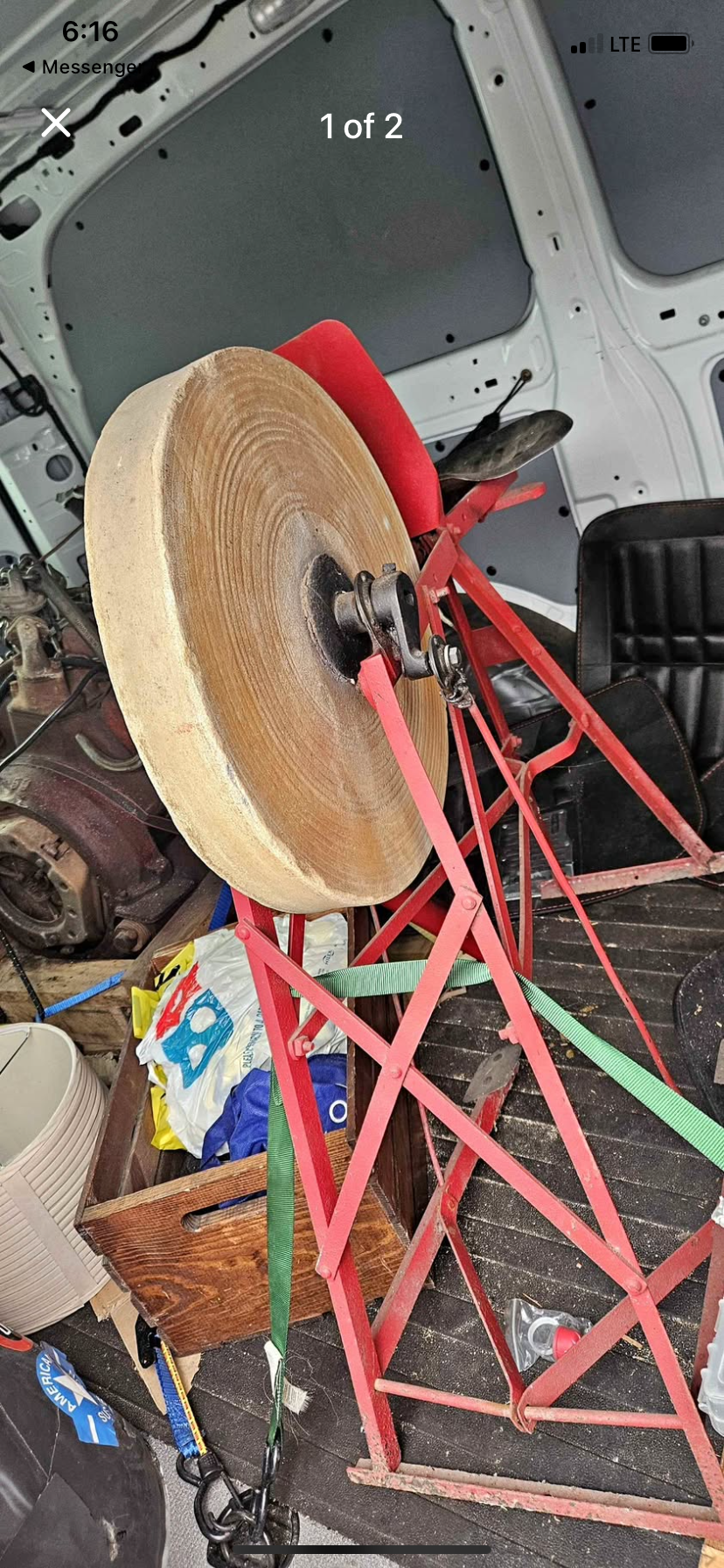

Good morning, does anyone here have any experience with these stones?
I know nothing about them but have been looking for something that will put an edge on my axes etc.
I’m assuming there are different varieties of stone?
Seller has told me that it’s not perfectly round as in it’s probably not intended for high speed.
It is pedal operated.
Ideally I’d like to be able to sharpen mower blades, chisels whatever with it but maybe these just were not intended for this purpose?
It’s about 2 hrs from me and he says 80 dollars
Worth it? What problems do I need to watch out for?

Grandpa used to have one. Used to sharpen hoes, mower blades, axes, etc. Once he got an electric bench grinder it was never used again.
We used to pedal it for him now-and-then when we were kids but the "fun" wore off pretty quick. It was easy to keep it spinning and he'd sometimes sprinkle water or light oil on it while sharpening.
I'd just look carefully for cracks. It's not like it's going to fly apart due to extremely high RPMs.

I have one, it was my grandfathers, used it for years and still do on a rare occasion. As others have said, check for cracks and find a way to drip some water on the stone while you are using it. The water keeps from plugging the stone with metal and keeps whatever you are grinding cool. The purpose of the metal shield between the stone and the seat is to keep the water off of you. I think they are worth whatever you are willing to pay. This is the first one I have heard of for sale so I have no reference as to price/value.

That one looks like it is fairly new, as in less than 50 years old. The antiques that I used as a kid were good enough to sharpen a shovel or a garden hoe. Things of that nature.
They also had a homemade trough under the stone for holding water for the stone to run in to soften and clean it as it spun. But I would use other means to put an edge on a chisel. Sharpening freehand is difficult to get a cutting edge on a stone like this.
But they are fun to use. For $80, I would buy it.

They can but it's not hard to avoid. Buy a low speed grinder (1750 vs 3450 RPM) and buy a soft wheel. A lot of grinders ship with wheels that are too hard and become dull and glazed easily. They rub instead of cut. The bonds in softer wheels break down faster to release dull media and uncover sharper media. People also tend not dress the wheels often enough.

55 years ago when I was but 14 years old I messed around with several very old grinding stones that were pedal driven. Where I lived you could find the stones just laying in a field or behind an old building. I think the stones were all sandstone. Anyway, myself and a few friends got some going that still had intact wood supports. We sharpened axes, hatchets, shovels, mattocks, etc. on the old stones. With teenage enthusiasm working for us we got things sharp. But not like knife sharp, the stones were too coarse. Still, sharp enough to easily remove a finger if the hatchet was swung wrong. The old stones turned slowly but were large enough in diameter that they cut pretty fast for a foot driven wheel.

Somebody has taken the time and energy to restore that grinder. I think it is older than 50 years as it has square head bolts/nuts. The only times that my dad used his was to sharpen his scythe. At pedal speed it was easy to keep the blade against the out of round stone as it turned. It was much easier to sharpen the long scythe blade on a wide open big stone. Back then there weren't hand held grinders, flap wheels, etc. And now there are much better ways to keep weeds under control.

Build a wooden tub that will hold water for lubricating the wheel and attach it under the wheel so the wheel rotates through it.

My grandfather had one of these, he used an old tire, cut in half for the water bath. Worked well for small things like axes, shovels and hoes, (50+ years ago).
