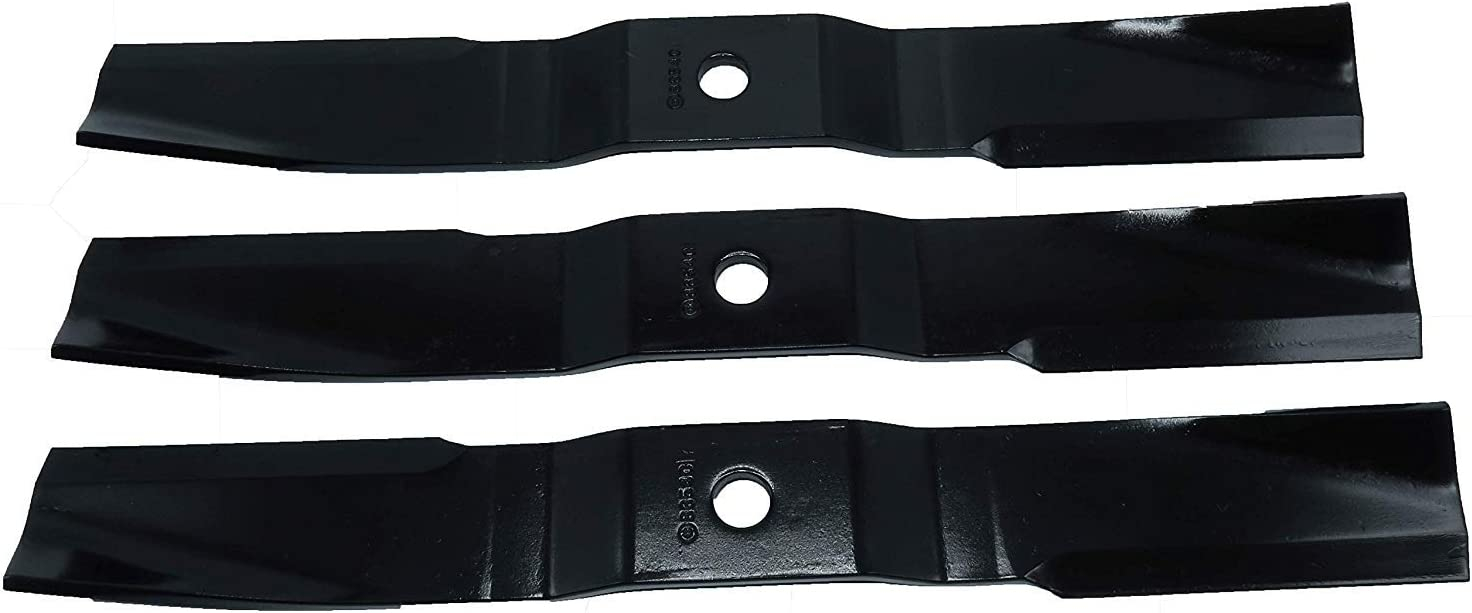

There are no alternative blades available, only the OEM parts. hube2
so is it the length or shape that makes them proprietary? so much aftermarket out there

I take it you got that 60" deck, right? That's the problem with Massey's deck, I could never find alternate blades for it either. Other problem is that you can't mulch with it (even if you were able to find mulching blades for it).
Yep
sounds expensive
They appear to be unique to the 60" Massey deck.
I did all the kind of measuring and looking thinking I could get find something. I was hoping to find mulching blades.
There are a lot of factors, the biggest one being the difference is height between the center where it attaches to the spindle and the blades combined with the center hole and blade length.

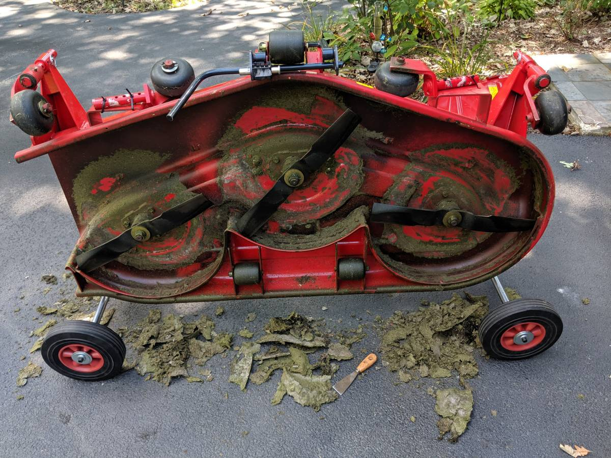

Yeh but even with mulching blades, the deck design won't allow for effective mulching. That deck is built for side discharge only, that's why it's got the open channel on the front there.
Decks that allow for mulching (with blocked chute or otherwise) are baffled on both sides with an open channel running down the middle toward the chute. And dedicated mulching decks (Massey has one) are fully baffled with no open channel at all.

I was hoping for a set of gator blades or similar. While not exactly "mulching" they do produce a finer chop even with the side discharge. Plus they were cheaper and lasted longer than the oem blades for the JD.
Where did you get the wheels for standing up the deck? They are wider and the wheels are larger than the set I have, looks a lot more stable.
Also, thanks for the pic, I like how the guide wheels are stored and I never thought of that. Much better then my method of tossing them in a corner of the shed for the winter.
Yeh gators are great, I hear ya on that. I got them on my Bradley right now, they're great year round.
Oh the deck storage wheel thingies, I build those. The wheels themselves I got off ebay.

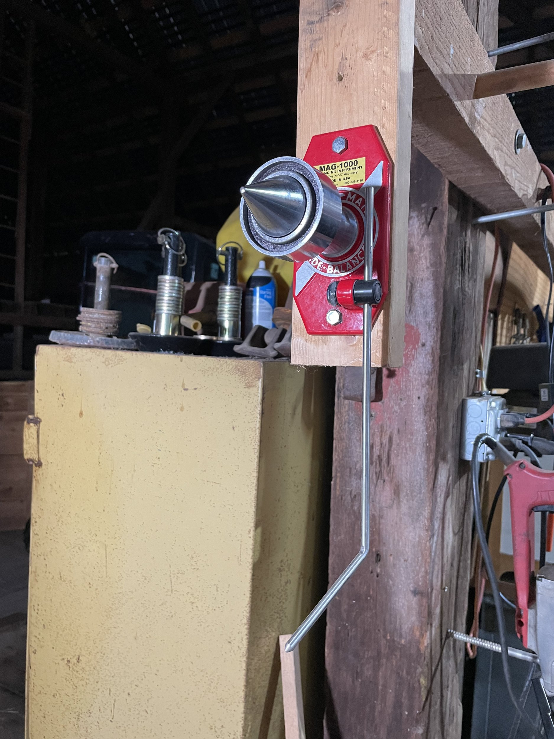

Balancing I tried on a nail or a screwdriver but I found my detection was not very reliable and just gave up on it. I am just careful to keep both ends visually even and go on without balancing and my 97 lawnmower has never had a spindle issue either.
With no spindle failures, it sounds like you have been pretty good, or pretty lucky at balancing your blades. But you can do better than a visual/guess, with a $6 blade balancer

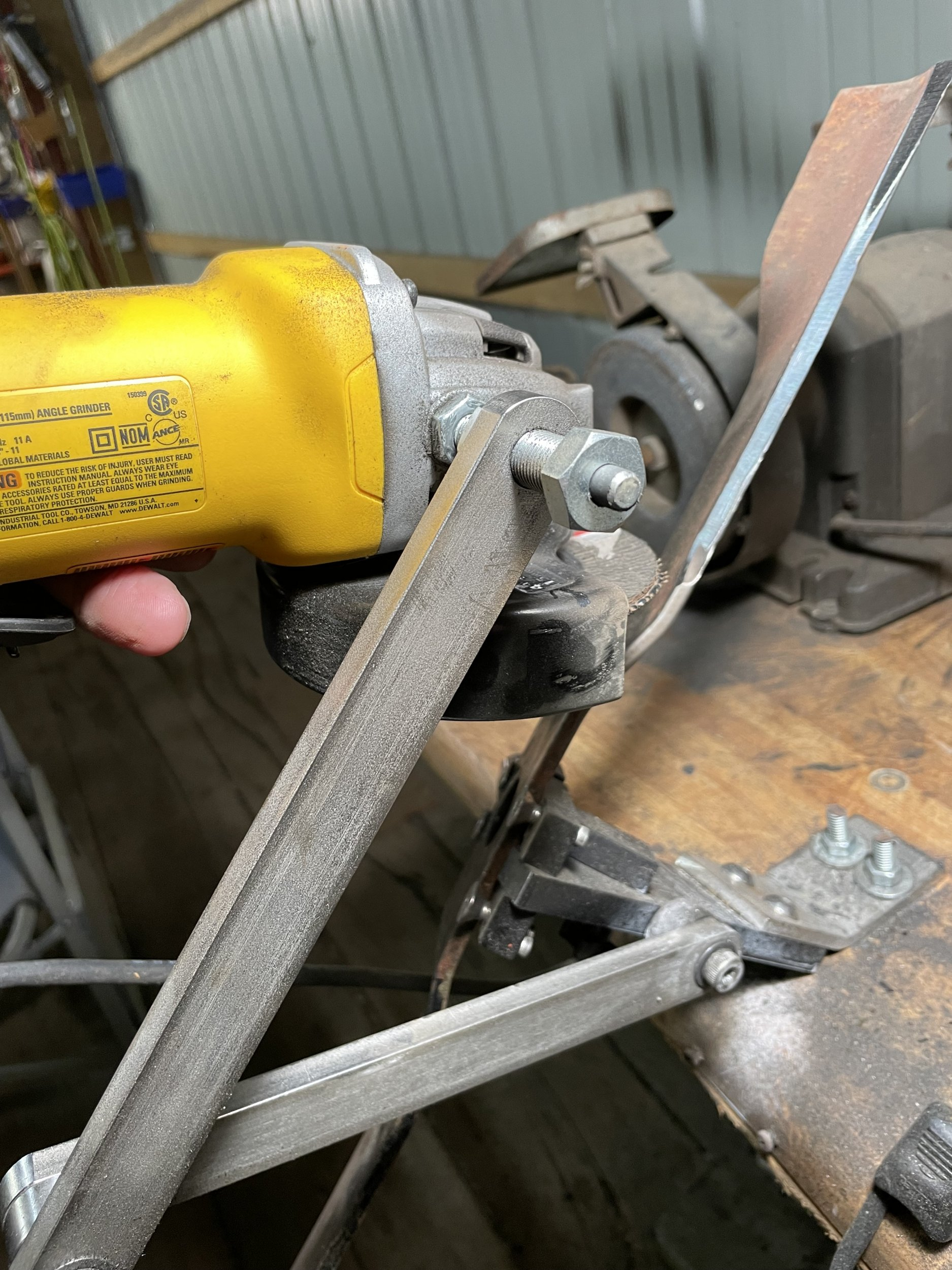

I use the loader bucket on the loader to hold my blades for sharpening. I use a c- clamp to hold the blade and sharpen away with the die grinder. By using the loader bucket I can get the blade to a comfortable height, hold the blades before and after sharpening and lay the grinder down at any time to rotate the blades for sharpening.
/ sharpening mower blades #80
I don't clamp them, I just lay the blade flat on the work bench with one end dangling off the table, that's the side I'm gonna sharpen. I use one hand to hold the blade down against the table, the other hand runs the angle grinder with a flap disc on that dangling edge.
A couple 3 passes, flip it around, do the other side, test it with the balancer thingie real fast (just for fun, coz I've yet to have it noticeably unbalanced), and then clean up the curled-over edge with a quick light pass with the grinder on the underside. The whole thing done in maybe a minute. Sharpening mower blades ain't jack...whoever here posted about worrying they'll do it wrong, don't worry so much about it.
