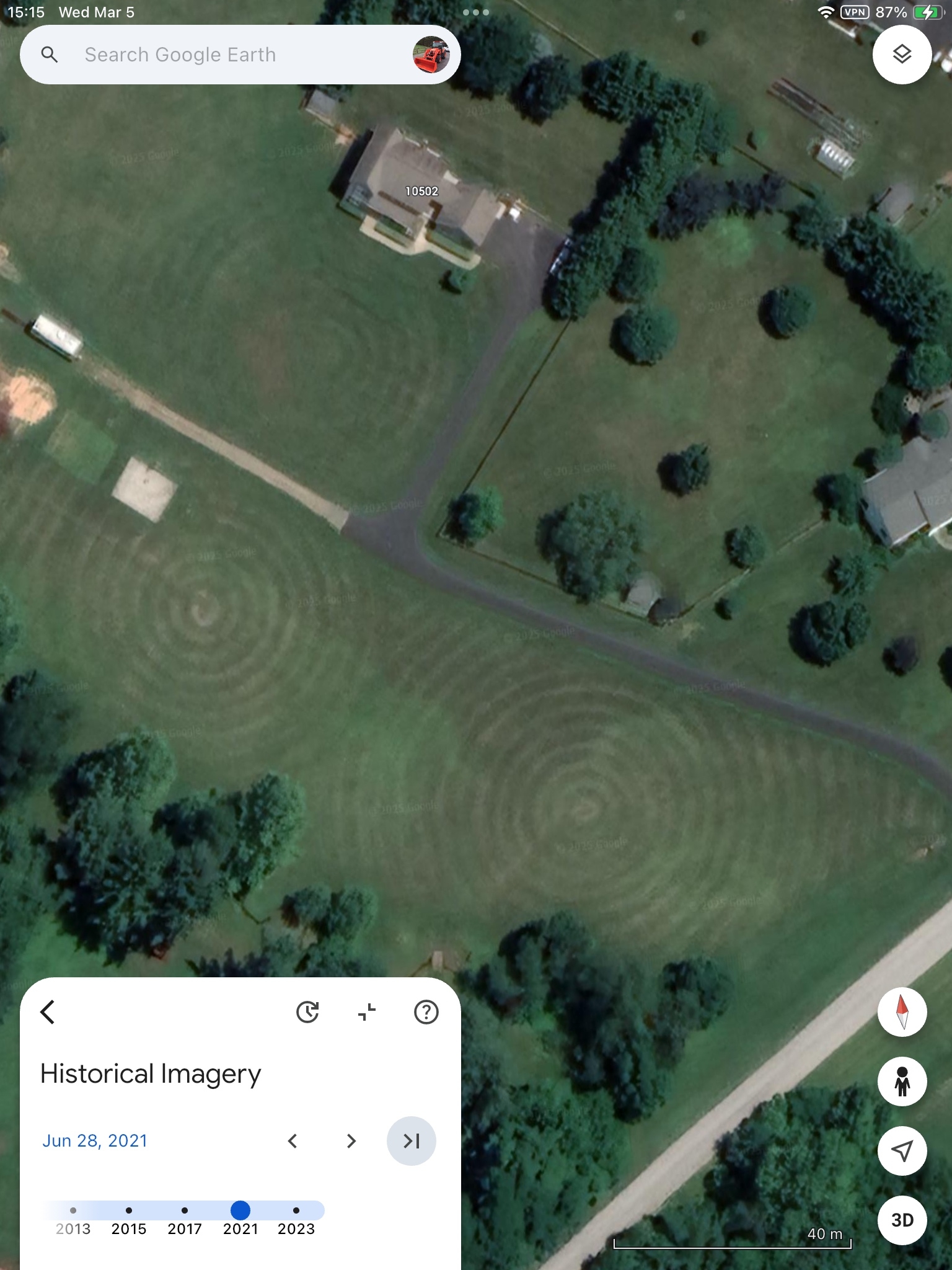

I occasionally cut some wild patterns in my lawn which gives the neighbors something to talk about.View attachment 3497301
When we bought our current place, I mowed a giant peace sign in one of the uncut pastures (about 1 ac in size). Kept it mowed that way long enough for Google satellite to snap a good picture.
