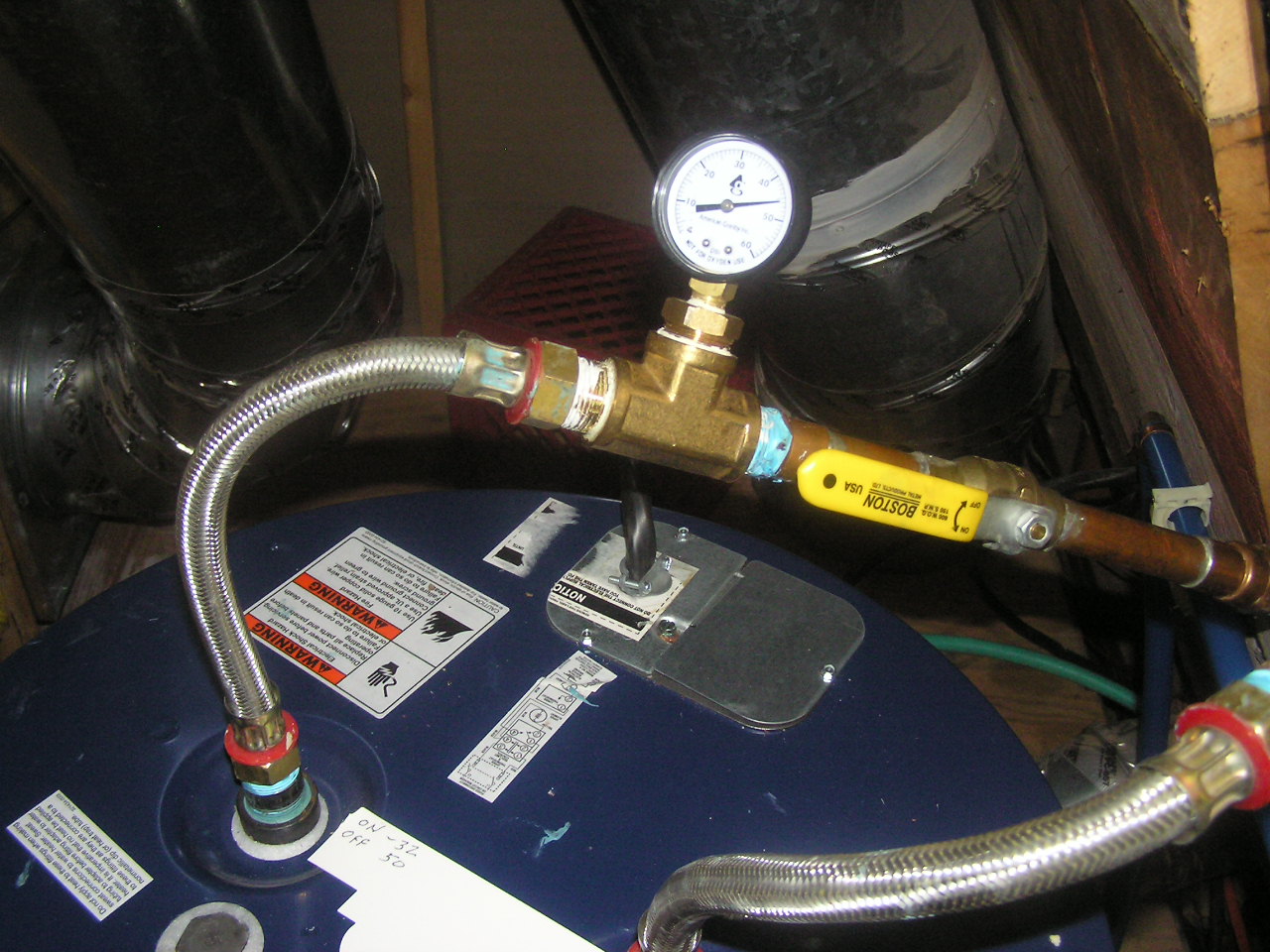

I added a pressure gauge to the input of the hot water heater so I could see that everything was copacetic from inside the house:
/ Setting Well Pressure #9
Why do you want to know the inlet water pressure for your hot water tank?
Would you suspect it to be different than your cold water pressure throughout the building, or are you just trying to confirm what your overall house pressure is?
If you turn on any faucet, and the flow is weak, you will know that you have a pressure problem.
I can't see that reading the house inlet pressure is going to give you much useful pump/tank information.

The gauge is on the other end of the line from the tank at the well, that is outside a long way away. It shows me the pressure in the pressure tank and that everything is working right. If the pressure slowly drops when we aren't using water, there is a problem, like a leaking toilet flapper, fill valve or outside hydrant.
I also have a light at the well, that can be seen from the house, it comes on when the pump runs.

The gauge is on the other end of the line from the tank at the well, that is outside a long way away. It shows me the pressure in the tank and that everything is working right. If the pressure slowly drops when we aren't using water, there is a problem, like a leaking toilet flapper, fill valve or outside hydrant.
I have a light.....in the house ..... that tells me when the pump is running.
