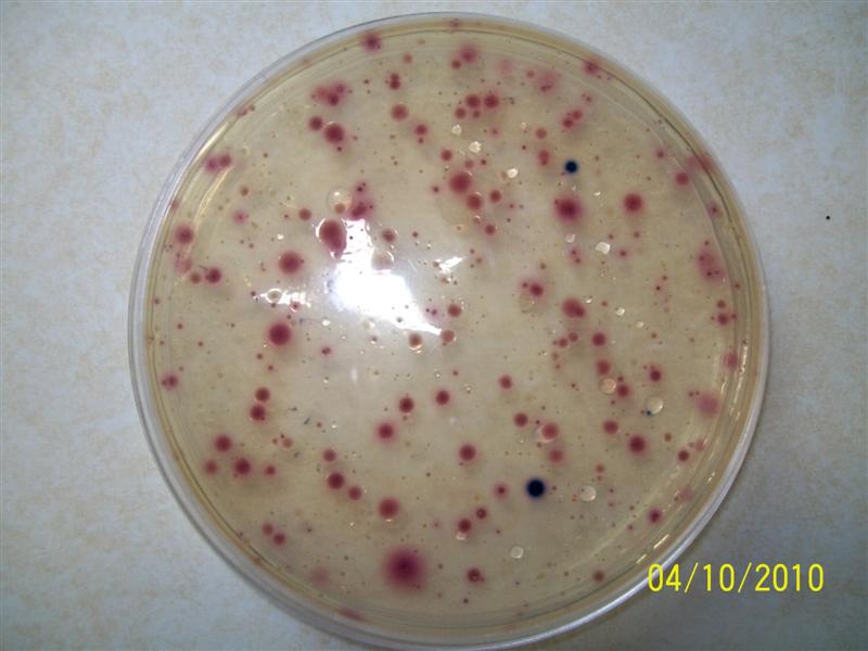

While we're on the subject of septic systems.
This is what can happen when septic systems go wrong. This is the water sample from our creek. Each purple colony is a Fecal Coliform colony (E. Coli in this case). It's a gauge for determining how much mamal sewage is in a body of water. I count about 90 colonies for this 1ml sample. All the coliform standards are based on 100ml sample so mutiply this by 100. 9000CFU/100ml right? Virginia standards for smimming and contact such as canoeing/kayaking, water sking are 200CFU/100ml. I'd say we are way over the limit. The Health dept says is the Dept of Environmental Quality (DEQ) and DEQ says it's the Health dept responsibility. They blame it on the Raccons and Deer and nothing gets cleaned up. I'm about ready to go to the local paper.

Shaley, that is concerning but I'd think the first thing to do is to get the water professionally cultured using standard sampling and culture methodology as that is what the EPA cut off limits are based on. You don't specify but usually these tests are done with a filter paper or with multiple tube dilution methods. Just adding water to a petri dish and incubating it gives a semi quantitative result but may not be easily interpreted with reference to the EPA standards. Still, it looks like you have a problem at least if you want to swim in the creek.

Shaley,
I use to perform potable water testing in the state of Ohio and carried certifications for these types of tests. That is my basis for the following comments.
It has been awhile but I do not see a 90 count in your sample. I would call them background colonies not a positive E. Coli. (maybe a count of 2 on the plate). The positives look atypical to me.
The type of agar used to culture is very specific to the bacteria you are trying to grow. Also it appears from the size of the colonies that this plate was incubated for much longer than the 24 hours the test calls for. Media, time and temp are spelled out exactly in the book.
We tested almost every drinkable public water supply in the state and just about every state beach sample came across my bench. This time of the year it was not uncommon to see a spike in the counts of the beach samples due to increased temperature and people in the water stirring up the bottom.
Almost every sample would be reported as HBC or high background count, meaniong there were more than 200 "other" colonies growing on the plate making it impossible to see any positives.
Bottom line is: you really don't want to know what's growing in your water.
