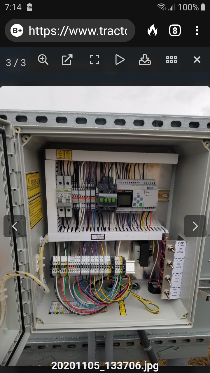

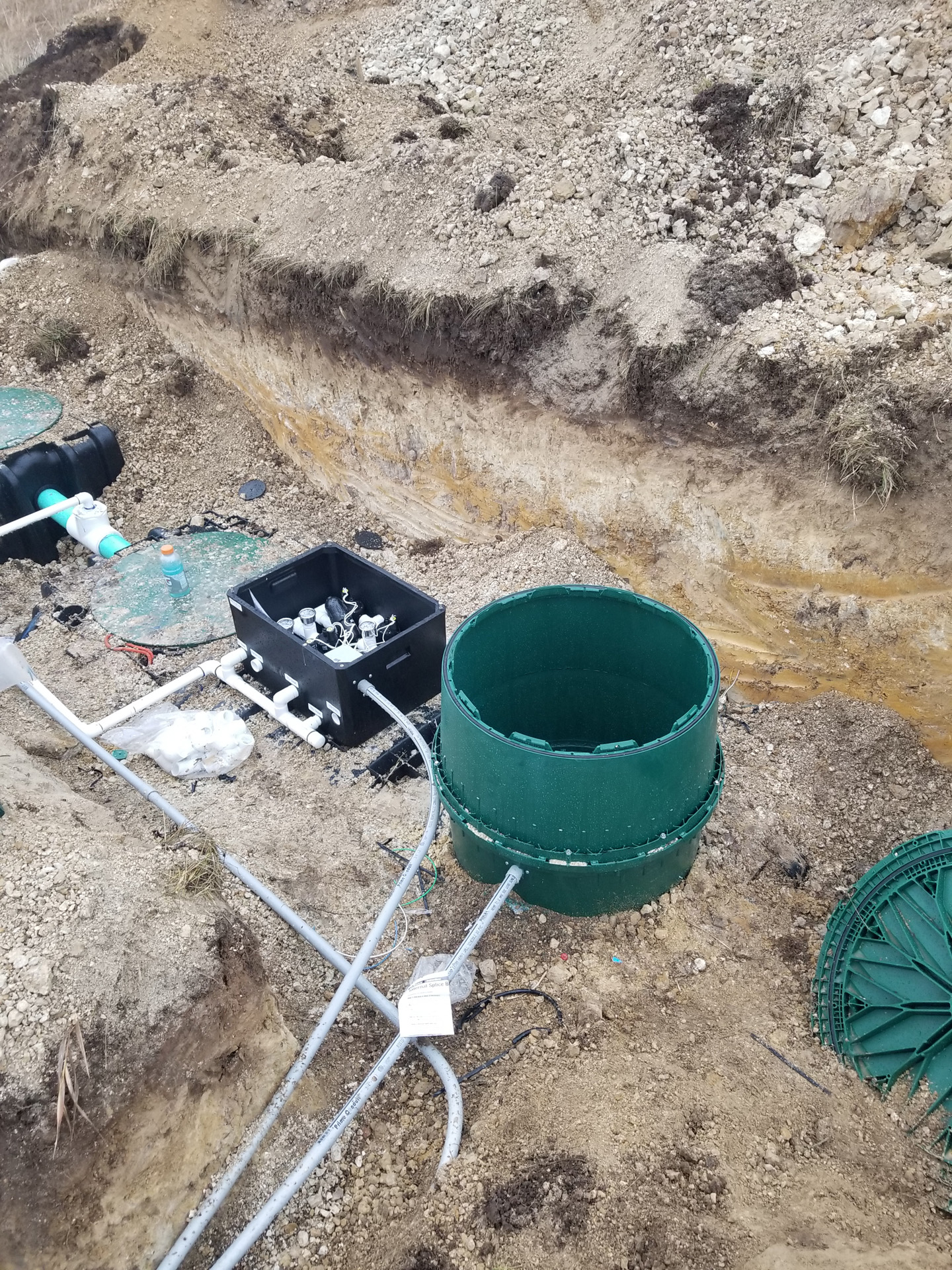

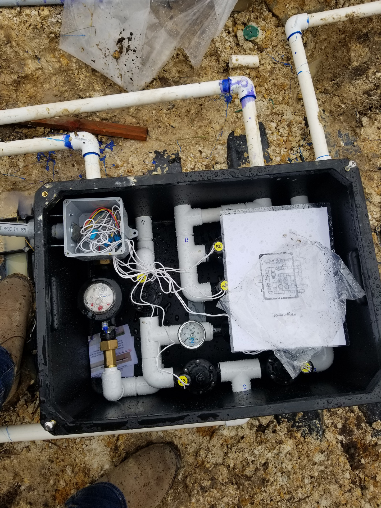

Regarding waste only in tank….. I live in NY state in the woods. In my county all waste water goes to septic tank. Washer not separated. I did take all my gray water out of the system for a few years and dropped it in the woods via my perimeter drains but my modified above ground system seemed to start to dry out so I redirected it back in. My manual siphon dosing tank puts 120 gallons to the leach field at a time
