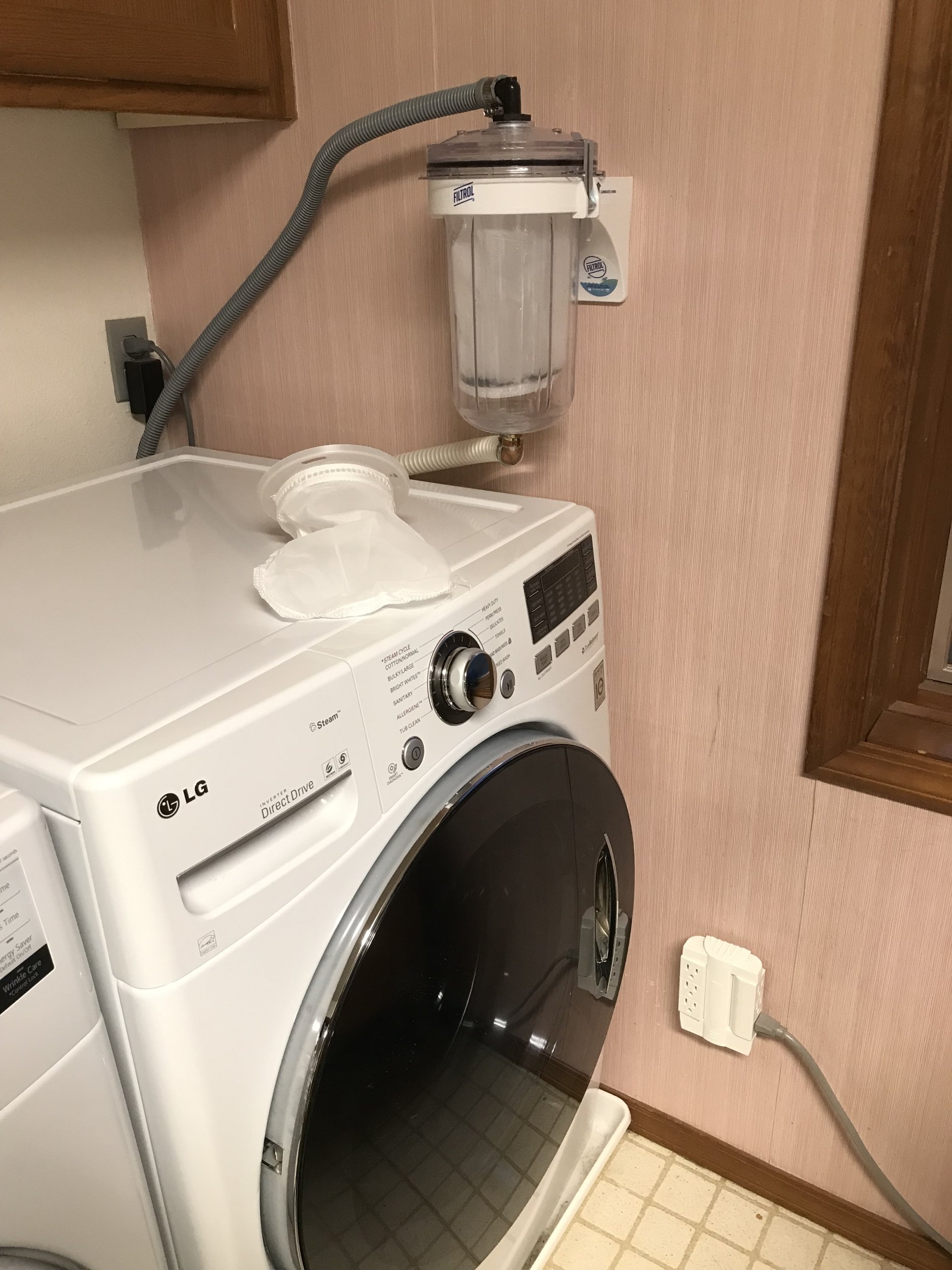

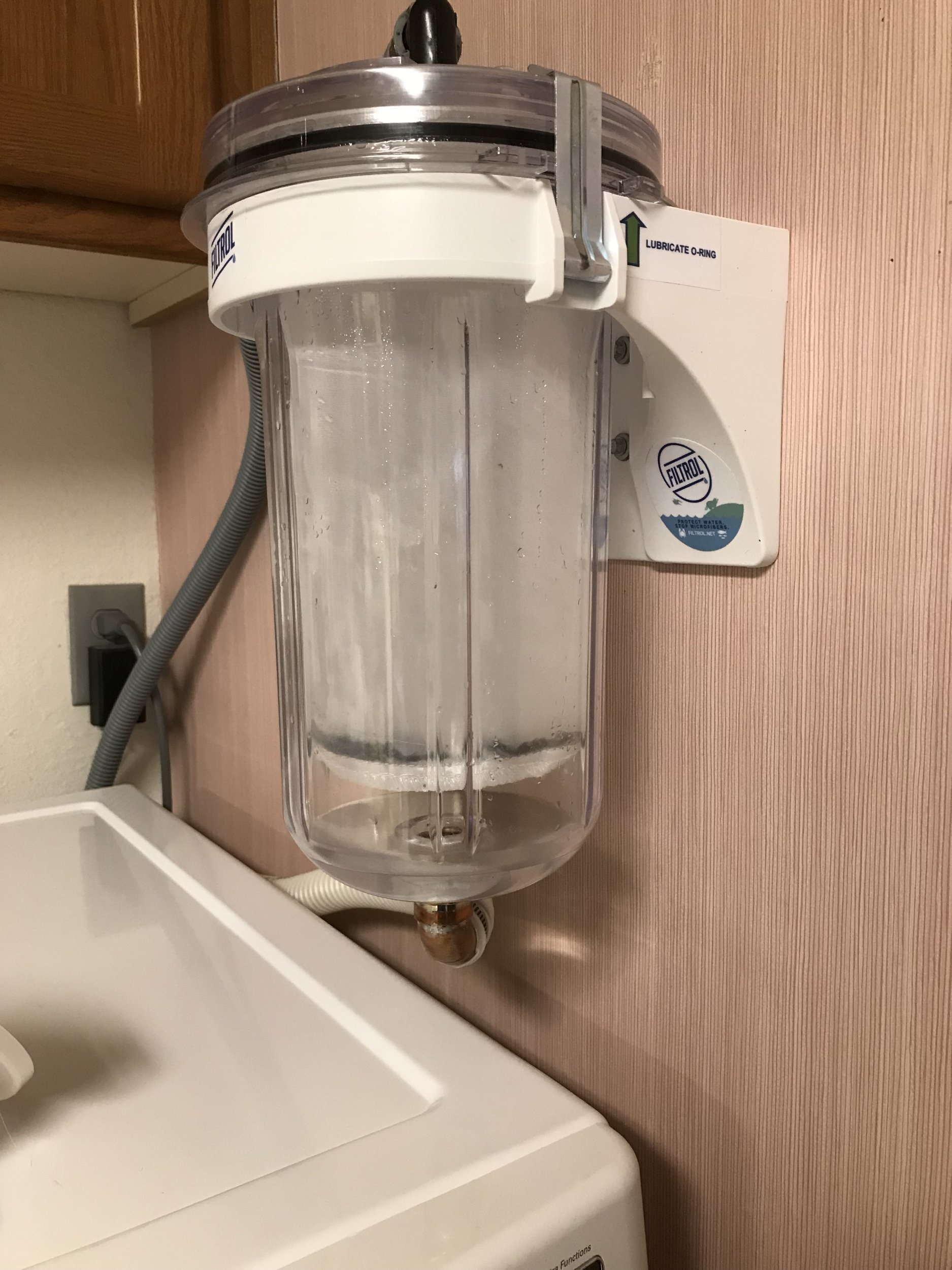

We have about 40 year old septic field which is working fine, but laundry washing lint has been a concern for quite some time, however I did not want to install a septic outlet filter because accessing it outside say every 2 - 3 months is something I am trying to avoid!
Installing this type of 100 micron filter was an alternative I had been contemplating, but delaying mainly due to not really having a place where this setup could be hidden out of sight, but finally decided to de best I could figure out & install it.
It's installed in that spot so it could be screwed directly into a wall stud while it still clears the adjacent cabinet door - It could be elevated more if moved further to right, but trying to avoid that.
The bottom outlet pipe is pretty close to top of the washer so I decided to improvise & custom-make a 90 degree turn on it which is against the instructions - otherwise the drain hose would be rubbing against the machine top.
So far so good, after couple of loads of laundry.
I will post updates later.
Lint filter with a spare bag:
Lint from one medium size load:

To keep lint, especially man-made synthetic fibers away from the septic tank & drainage field!
Bacteria does not work on synthetic fibers and many floating fibers will end up in the drainage field....
How long before it clogs up is anyone's guess?
/ Laundry Washing Machine Lint Filter & Septic Field #4
Adding one reduces the amount of non-digestible debris going into the septic tank; sand, plastic fibers, etc., that don't degrade. The concern is also that the finer particles potentially flowing through the septic system to the drain field where they add to the biofilm growing in and outside the pipes, clogging the drain field more quickly.
Although they are more focused on floating items like fats, septic tank exit filters/brushes also help reduce the load on the drain field.
Once you install one, you realize how much crud gets washed into your septic tank. We had one years ago just to keep the line to the city sewer clean and a couple of loads of laundry would fill it.
Whether this is an issue for you depends on a lot of variables; the soil type in your drain field, the ratio of of septic tank volume to flow, and the extent of man made fibers and soil in the laundry. At a minimum, I would file it under an easy way to extend the life of a septic system, and the time between pump outs.
