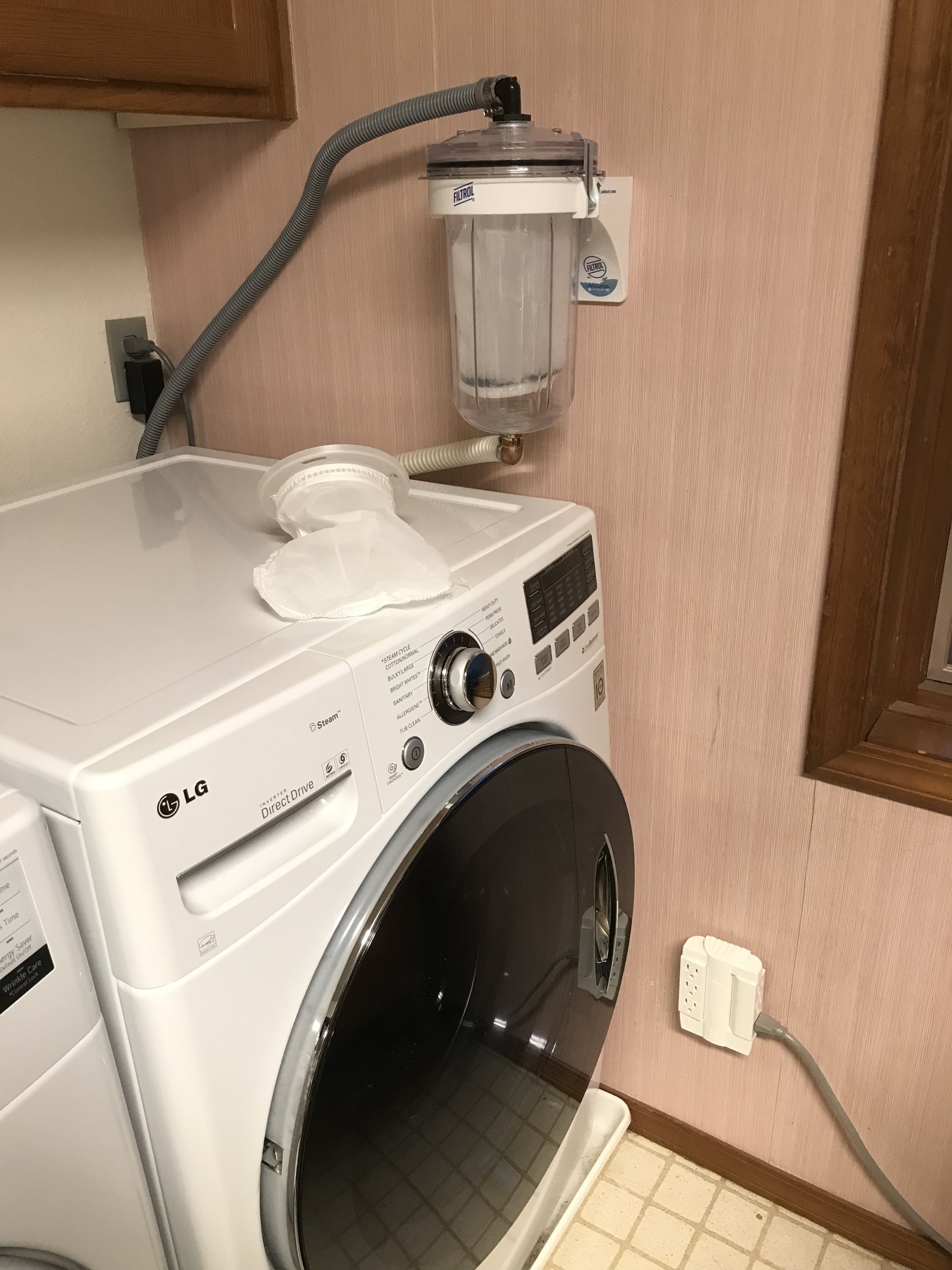

We have about 40 year old septic field which is working fine, but laundry washing lint has been a concern for quite some time, however I did not want to install a septic outlet filter because accessing it outside say every 2 - 3 months is something I am trying to avoid!

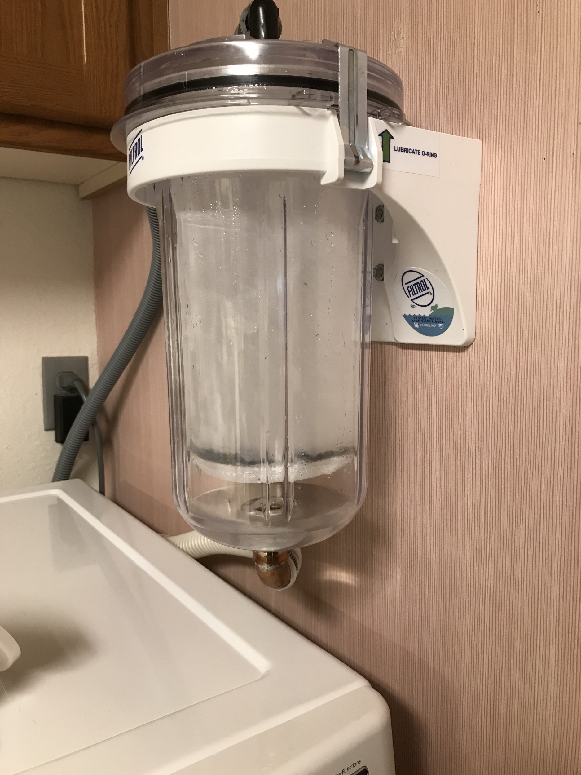

Installing this type of 100 micron filter was an alternative I had been contemplating, but delaying mainly due to not really having a place where this setup could be hidden out of sight, but finally decided to de best I could figure out & install it.
It's installed in that spot so it could be screwed directly into a wall stud while it still clears the adjacent cabinet door - It could be elevated more if moved further to right, but trying to avoid that.
The bottom outlet pipe is pretty close to top of the washer so I decided to improvise & custom-make a 90 degree turn on it which is against the instructions - otherwise the drain hose would be rubbing against the machine top.
So far so good, after couple of loads of laundry.
I will post updates later.
Lint filter with a spare bag:
Lint from one medium size load:
Would you mind posting a link to where you found this filter? Is it just a standard house water filter except you're using it on the laundry discharge?

This isn’t really legal, but we have our washing machine drain plumbed to an outdoor drainage settling basin. Washing machine drain water is bad for septic systems for reasons other than lint. Bleach also destroys the bacterial colonies in the septic field.
FWIW I've never had any problems with my septic system in the 21 years since I built the house. I will say that I have a front load washer and use about 1/2 the detergent called for, also never fabric softener or bleach.

Without bleach the issue is much less.
