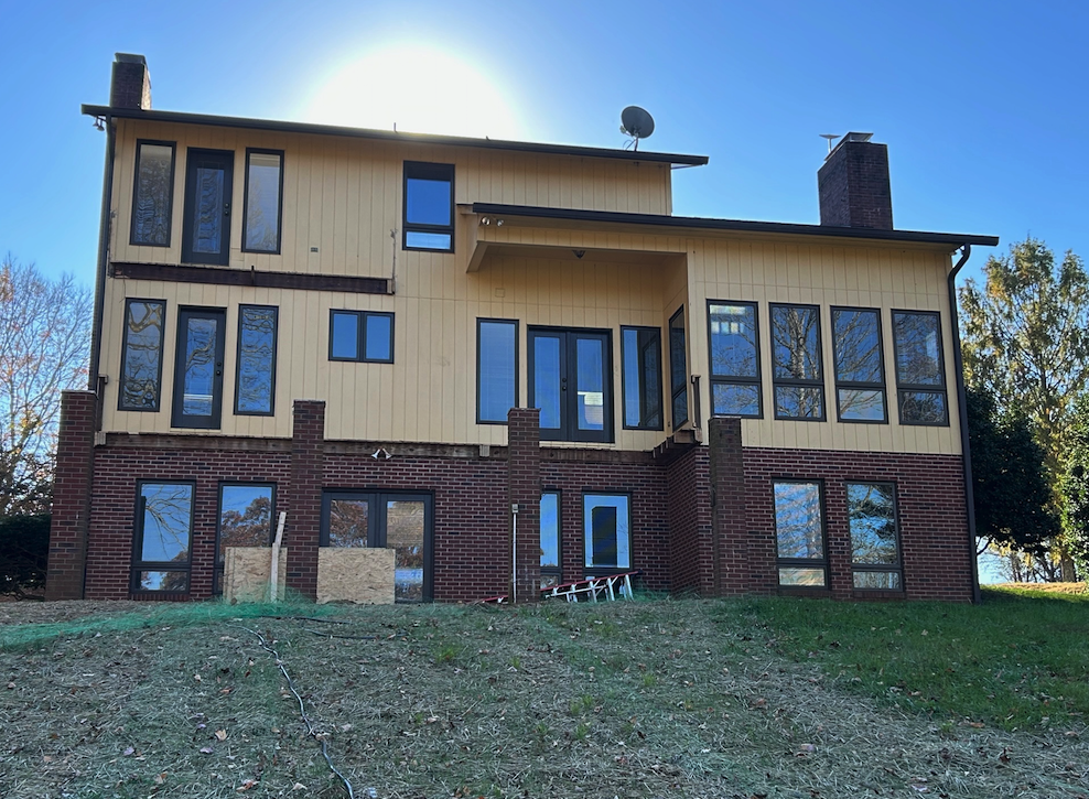

Only one I have that I took coming back from mowing over the weekend. View attachment 831318

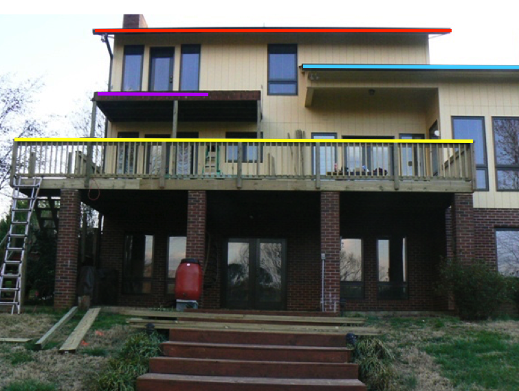

I wasn't very clear. Since the upper deck wasn't used very much, and you don't have a good option for getting stairs up there, my suggestion is to eliminate the upper deck and build a roof instead. I would remove the door. It looks like you have a plywood, T1-11 type siding that would be super affordable and easy to match to the existing house. Once painted, it would look like the door never existed. I'm assuming it's sheetrock on the inside. Another super easy opening to seal up like it never existed.
Keeping things cheap and simple, I would probably just make the roof the width of the upper and lower windows, so the posts line up with the brick columns already there. Seal in the rest of the opening in the wall for the ledger board with the same siding used to seal up the door opening.
Build a shallow pitch roof that fits under the upstairs windows.
Without doing any math, but just sort of guessing the price of materials to build the deck, and the cost of materials to build a porch roof, it's going to be very close.
I'm a huge fan of big, usable decks. Bigger the better!!! I'm not a fan of balconies. To me, they are small decks that are never used that cost too much and always need some sort of attention due to their desire to rot all the time.

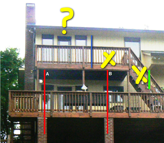

Thinking about my earlier post, now I’m wondering if you need anything on that wall, above the wood deck? If you closed up the window and where it’s open for your ledger board, it would look fine and save a bunch of money.

Eddie, the only roadblock to your line of thinking is my wife ;) That said, I will admit, when we are upstairs, at that height on the top floor, that door and those windows along with deck offers you a good vantage point for overlooking the back yard in the winter months (best spot on the 3rd floor to see the back yard, and it happens to be in that one bedroom).
