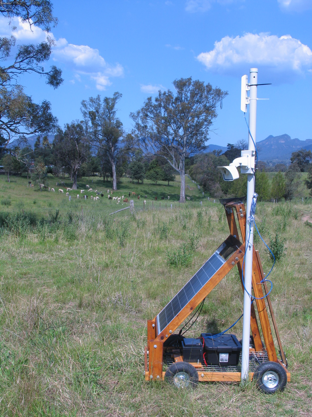

Hi disney
I use a camera that sends still images back to the farmhouse.
Camera is a Mobotix camera, with a separate Ubiquity Rocket M5 5.8 GHz wireless transmitter. Both are powered by a solar panel and a 12V car battery. The entire stuff is mounted on a cart thing that I made from wooden palings and some wheels. Images from the camera go via an ethernet cable to the wireless which transmits them back to the farmhouse. From there they get saved to the flash drive in the small fitPC2i computer (it's 4 x 4 x 1/2 inch size, takes just 4 Watts). Then the images get sent each hour via the satellite dish to my website so I can check on the alpacas anytime.
Mike
You put something like that up around here and the last picture you'll see is of it being stolen. :laughing:
Neat setup! :thumbsup:
