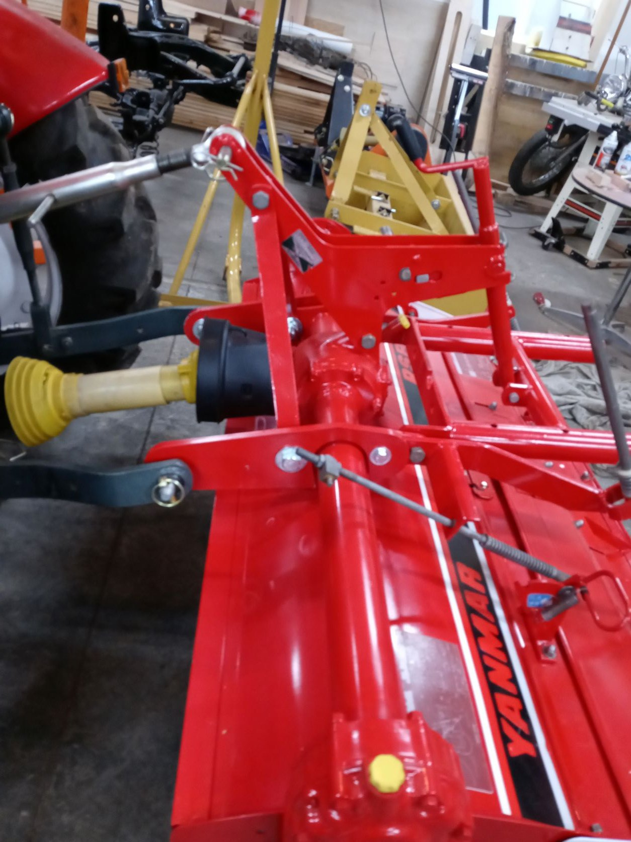

Would that need a longer driveshaft?
For tilling only a couple of times a year, it's not that much trouble to take off the QH to install the tiller in place of it. But making the tiller QH-compatible does sound attractive!
   / SCORE - Quick Hitch H-F #43
I was able to use the one it came with that was never fitted to my tractor.

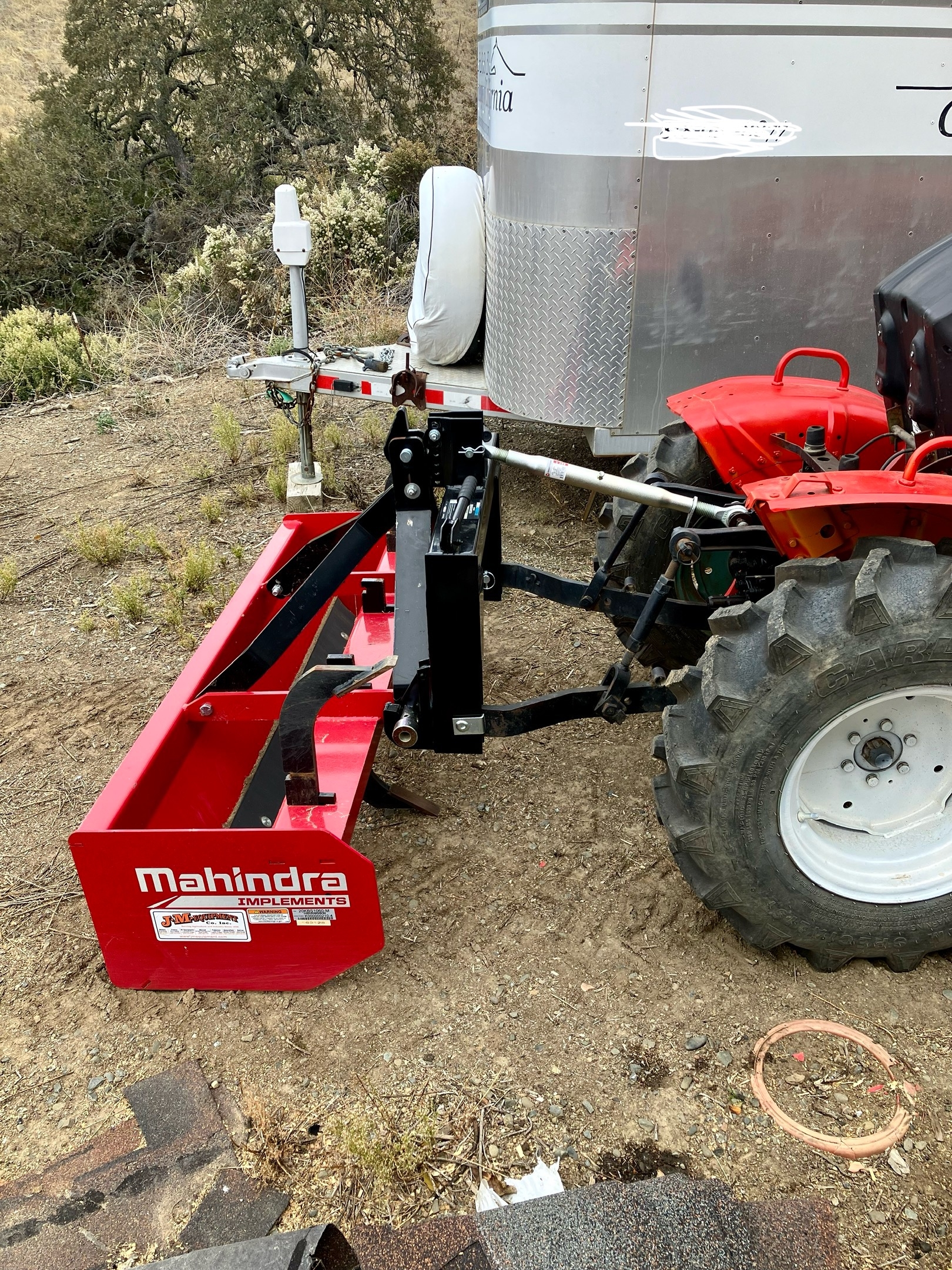

I spent part of Sunday getting the QH and box blade adjusted. All my dragging attachments have bushings installed, so I had to buy another QH.
Wife hadn’t used her account recently, so HF sent her a 30% off coupon. $113 out the door.
Kinda like the extra weight on the back with such a heavy loader bucket. Pulled the 5 ft box blade around pretty good on a hard pan field. Very rarely use the box blade on the Mahindra.

Did you need to use a farm jack or reverse pipe clamp to widen the opening by 1/4 to 3/8 inch? Mine was a tad under size like others had mentioned. It was a quick fix of 5mins and all was good.
My BB can't use the QH due to the top-link hook interface on the BB. I rarely use it now as the straight blade can do all sorts of things.

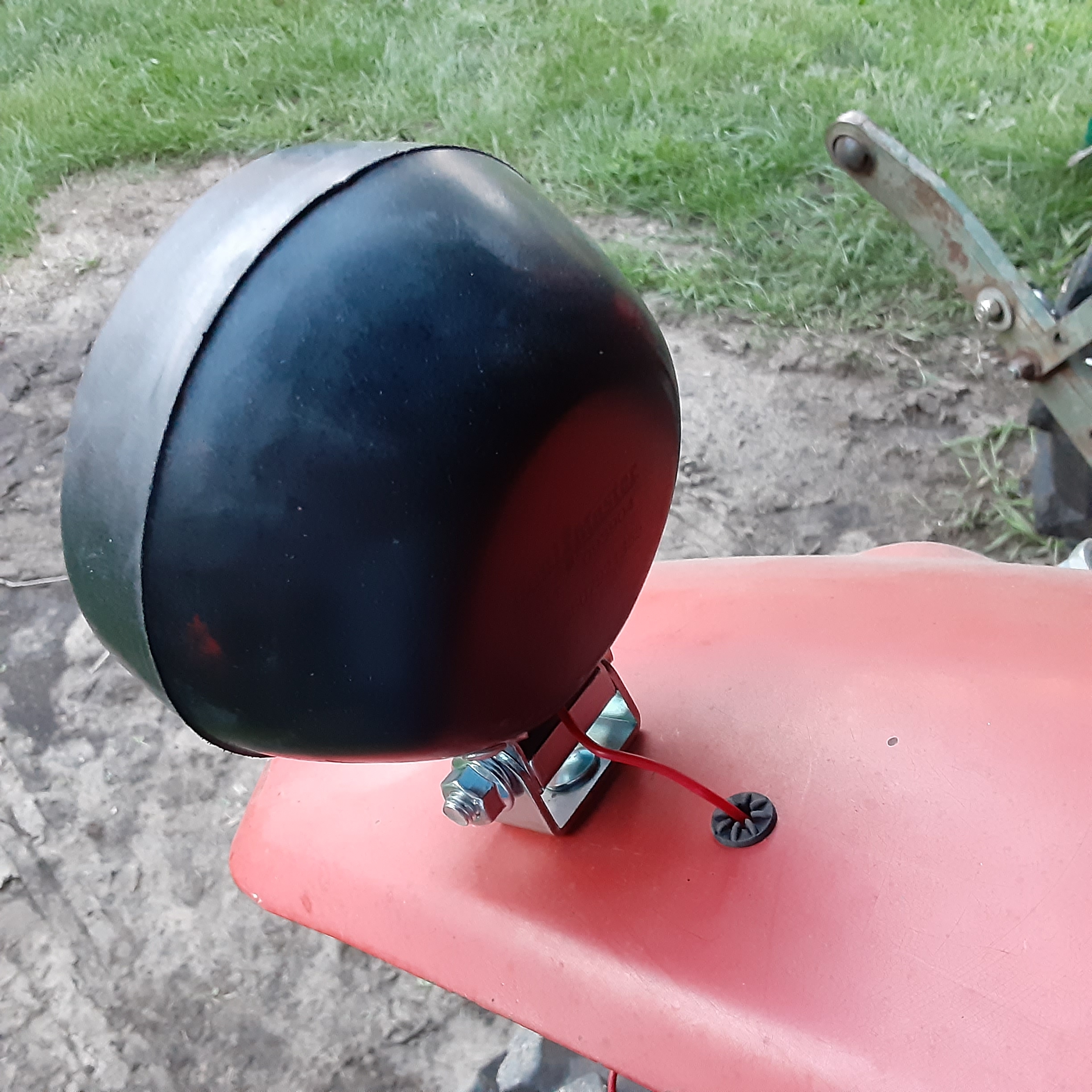

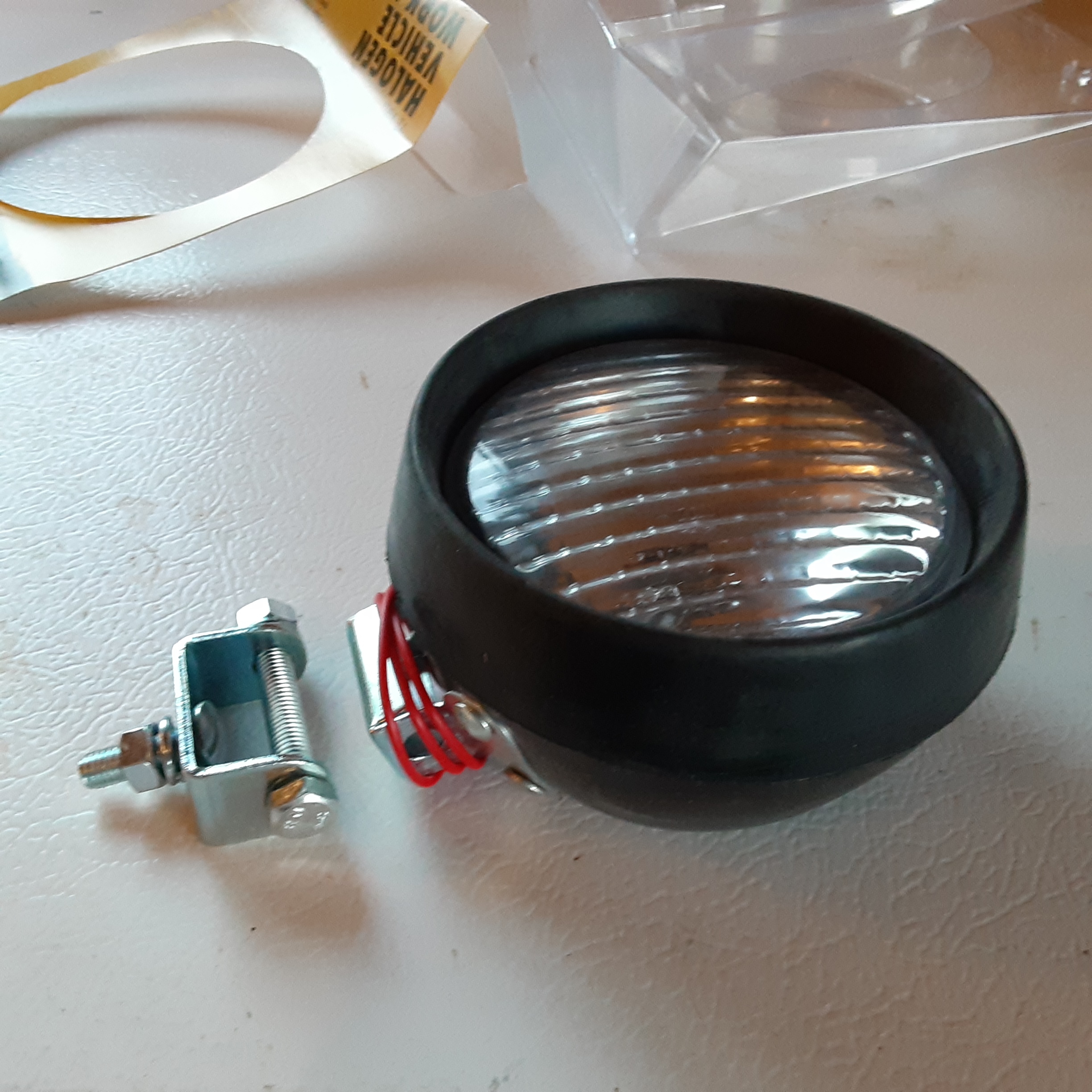

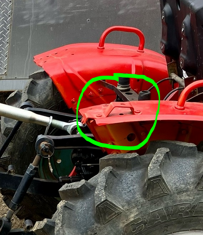

Oh, you need the Harbor Freight rear work light. Your YM186D has the rear fender mount for it. It's PERFECT to mount there !
Go to the towing attachments and the LED lights. right in the transition of those two sections you'll see the work light there for only $9.90. :)

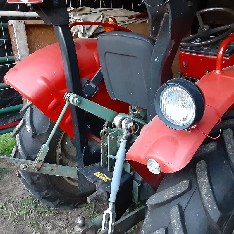

   / SCORE - Quick Hitch H-F #48
@bmaverick
QH fit just fine. Wish I bought a smaller top link though. May trade them on tractors.
If you look close I only have 1 bolt in the top hook. Plan on puttting a pin to support behind. I use pins in my other set up, to make it easier to change attachments on the fly.
Lights are something to be addressed. Currently nothing. I have some LED lights on an off road Vehicle that are close to the original headlight size. Good idea with back up light
This tractor was restorable, but time frame i need it is in 6 months. I dont think I could track parts down in that framework. Got a lot of glaring issues solved in 2 months
Need something usable, got 6 months to make it that
