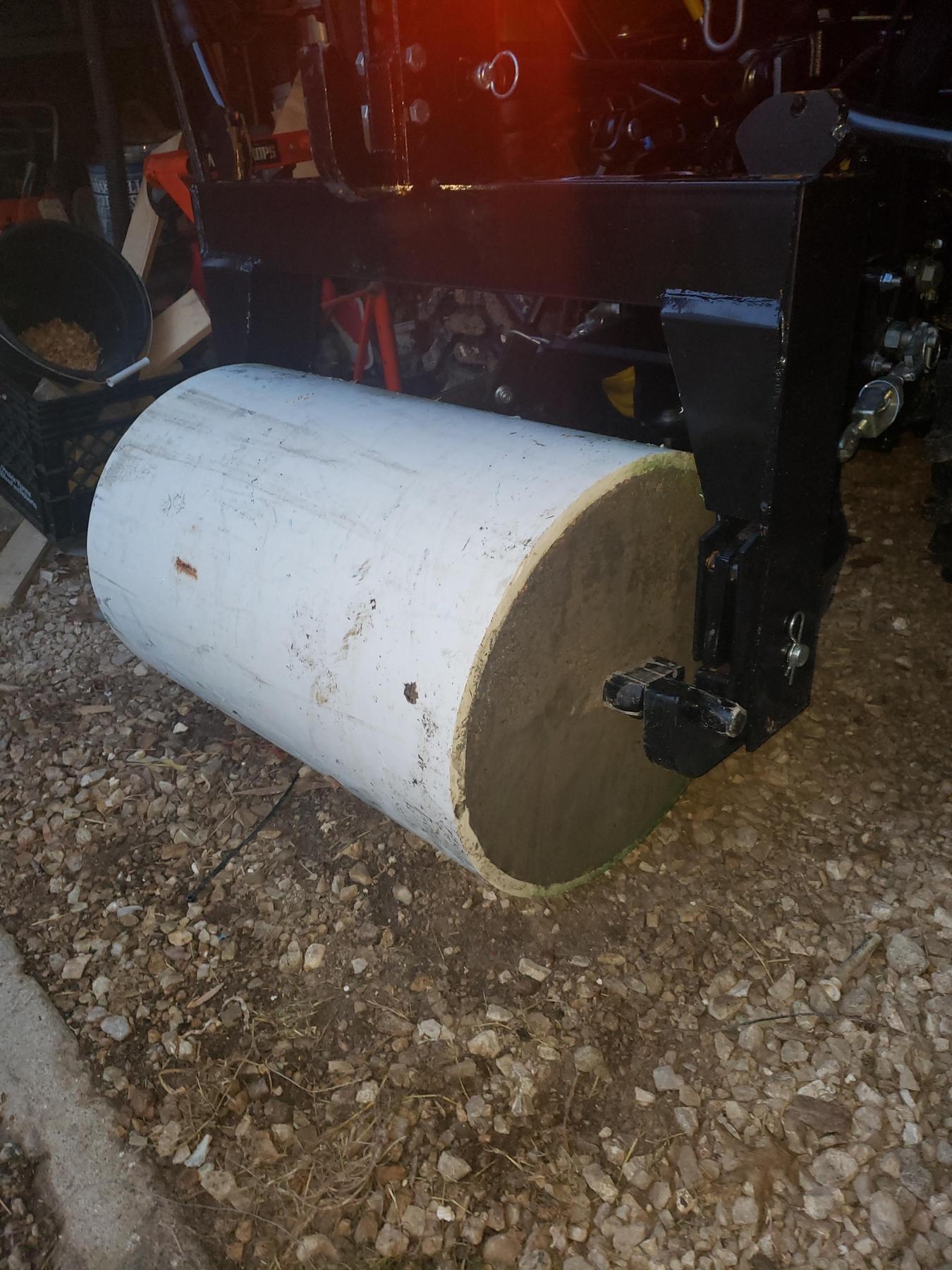

I park my implements next to the barn where I had dug out because water flowed in the barn clean outs. A couple of bags of crusher stone, sitting on pallets, an occasional spray of Glyphosate, It’s the perfect place.

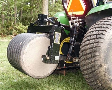

When the weather isn't so cold out, the next project for the quick-hitch will be this. All I need is a 30-gallon plastic barrel. Those are $8 on CL out here. (y)
The 30-gallon fits like a glove for the quick hitch. This should be about 240-lbs of rear ballast.

Some one made it as a lawn roller. Just keep the outer plastic barrel over the concrete.

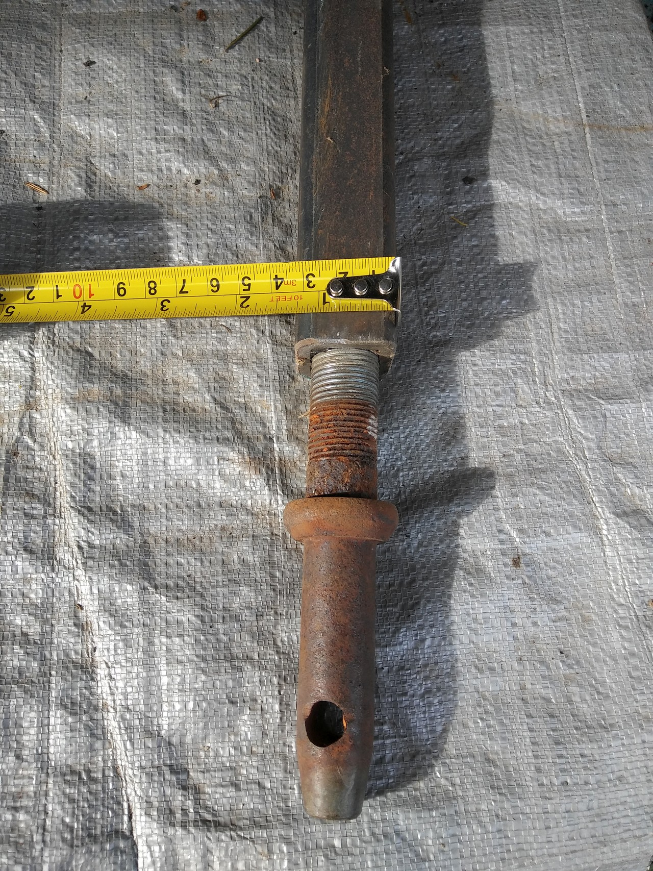

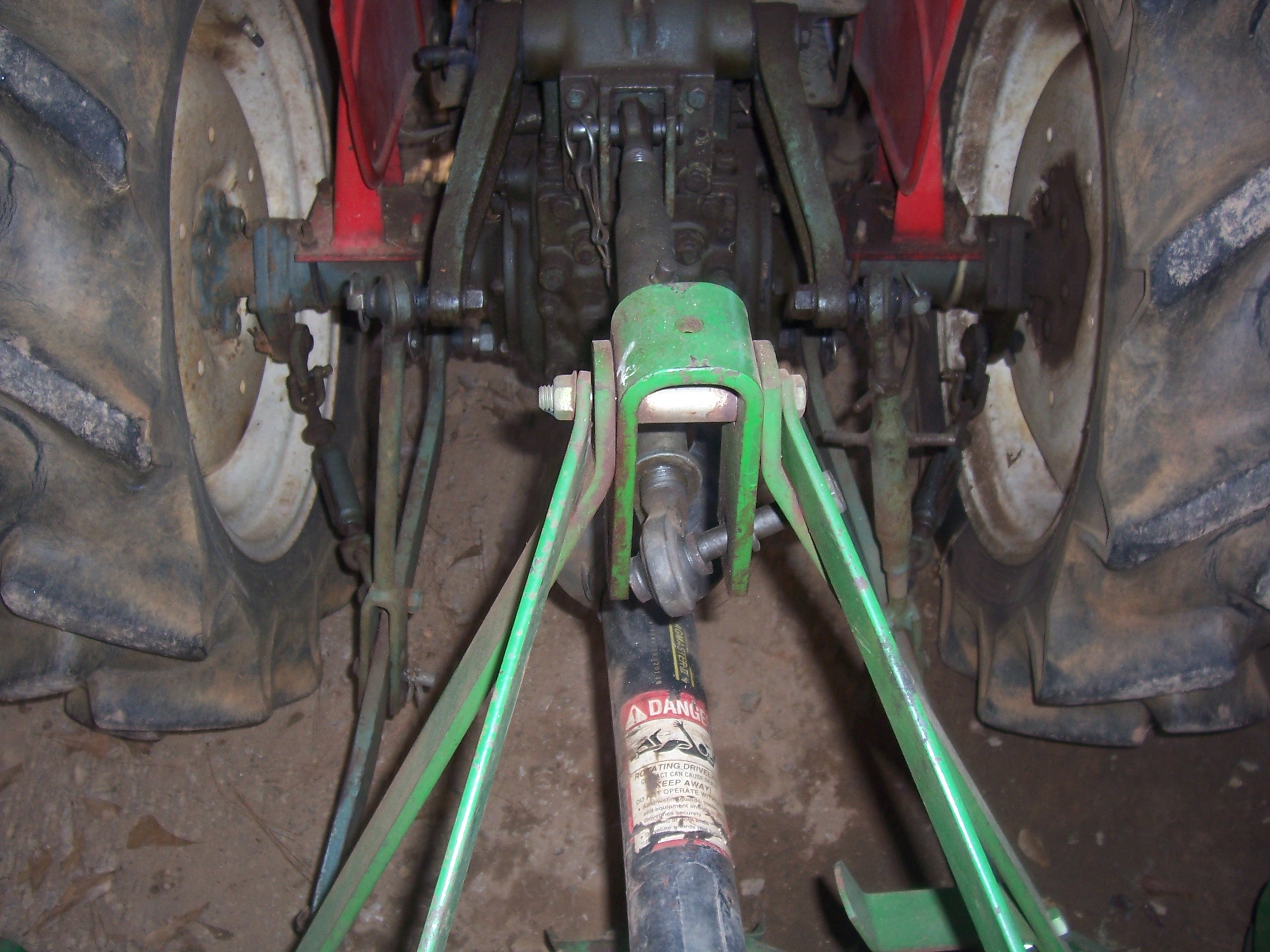

American threaded Pin on the L.and the Org. Yanmar R.. The small Metric Threads wear out. Standard threads screw right in and I Locked with a Locking Washer and Nut so it doesn't come loose anymore. Actually fell out before mowing so I had to lock it up!
