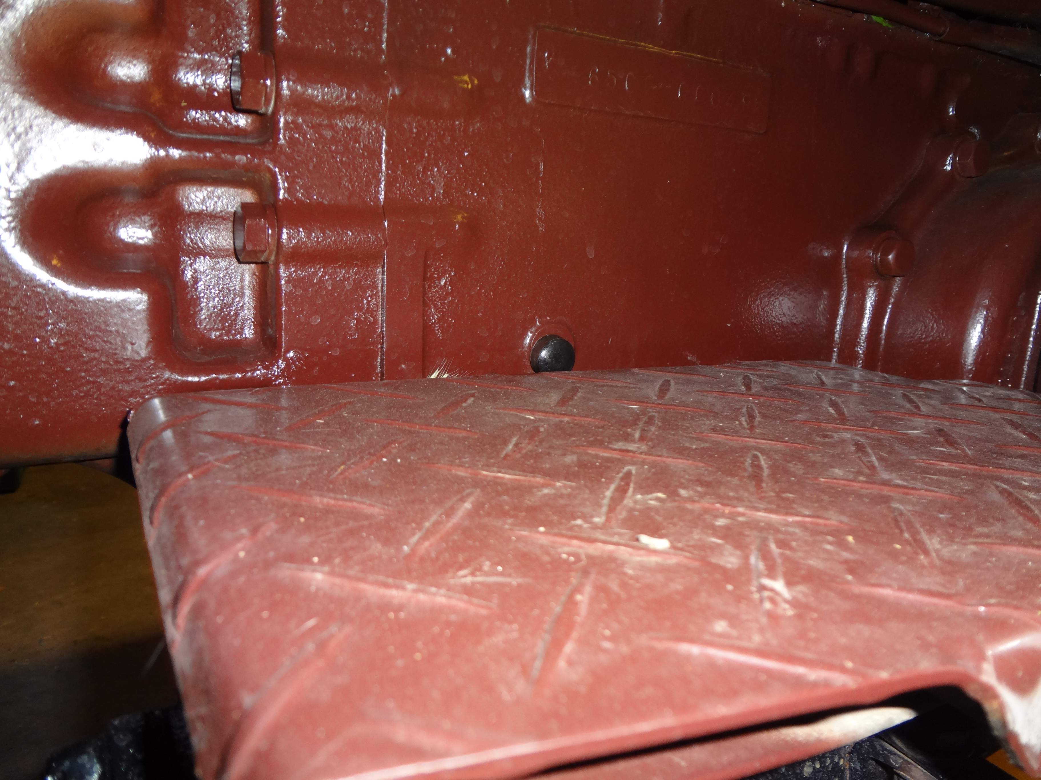

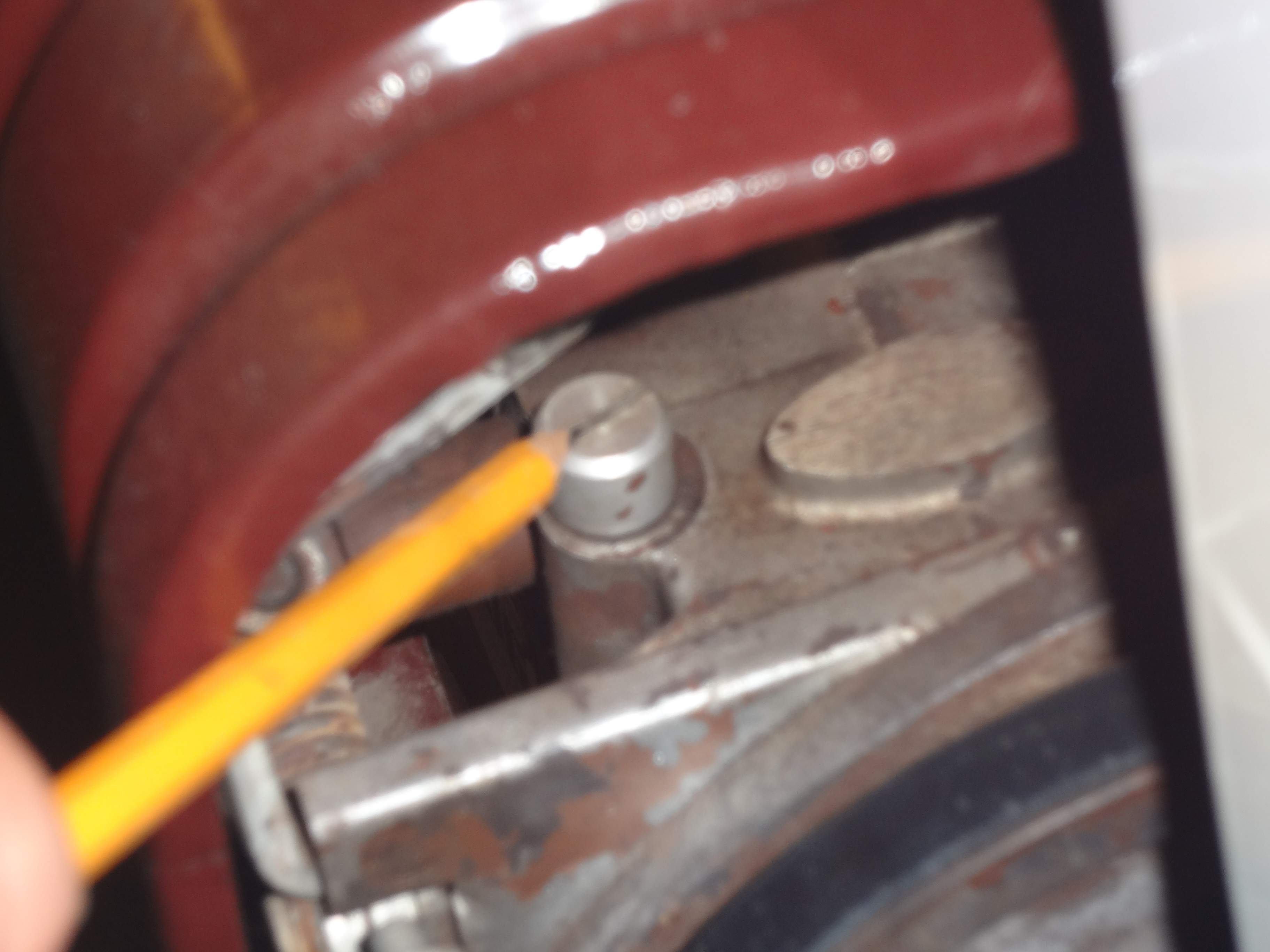

Hello. New member here. I just bought a Satoh Bison 650G with a front end loader. I am needing to know how to check the PTO oil and transmission/hydraulic oil and fluid levels in it. I see filler caps but no site glasses. When I pull the filler caps don't see any oil inside. I also read online somewhere about checking the governor oil in it. I also need to know what type of fluids to add to it. I am looking for another Satoh 650G owner with info. Thanks.

The governor has a dip stick on the fill screw. The drain hole is right straight below it.

The trans/pto uses 80/90 gear oil filled to the plug by the left foot board.

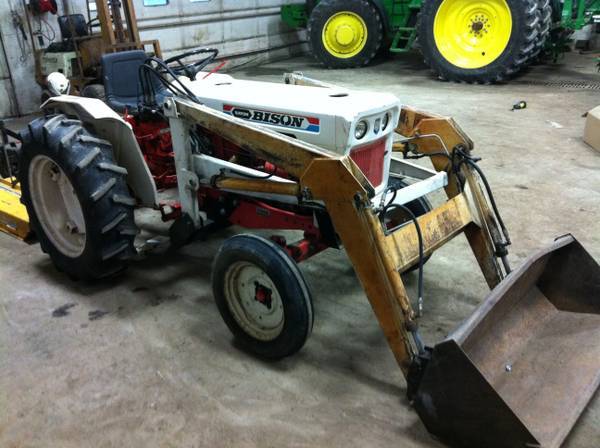

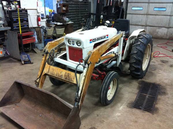

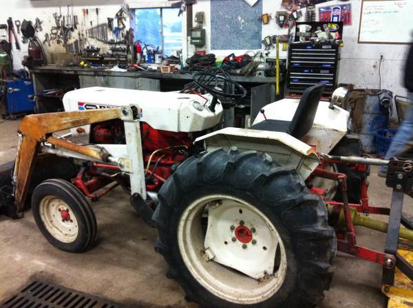

Hello rredman. Yes I see we are very close $T2eC16d,!)sE9swm,vw)BRSP1O1zlw~~60_57.jpgneighbors. To the best of my knowledge mine is a 74 to 76 Satoh 650G with a front loader and rear blade. It has been a sweet lil tractor. Have moved a lot of snow with it in the past week. I will try to post pics but not sure if it will work..$T2eC16d,!)sE9swm,vw)BRSP1O1zlw~~60_57.jpg$T2eC16d,!zcE9s4g3hwjBRSP0fOsLg~~60_57.jpg$T2eC16F,!w0E9szNW4rSBRSP1FLO9g~~60_57.jpg$T2eC16h,!yEE9s5jHQH5BRSP1ZFF8g~~60_57.jpg$T2eC16J,!w0E9szN((cJBRSP0)wRDQ~~60_57.jpg$T2eC16J,!zUE9s38-IjfBRSP07dDtw~~60_57.jpg1.jpg2.jpg3.jpg
/ Satoh Bison 650G questions. #12
Nice looking Bison twoshoes:thumbsup:
